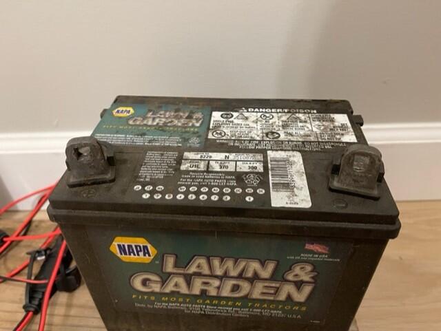

Dreamcatcher 102 #1 Posted November 6, 2023 (edited) Good Morning, My tractors are in need of fresh batteries. I've never seen these types of terminals on batteries before. Do/should I remove these terminals and install them on the new ones? Your help is much appreciated. Edited November 6, 2023 by Dreamcatcher 1 Share this post Link to post Share on other sites
ebinmaine 77,821 #2 Posted November 6, 2023 That's the standard type of garden tractor battery that's been used since the mid-70s. What do you have on your tractors? Can you post more pics? 2 Share this post Link to post Share on other sites
Dreamcatcher 102 #3 Posted November 6, 2023 37 minutes ago, ebinmaine said: That's the standard type of garden tractor battery that's been used since the mid-70s. What do you have on your tractors? Can you post more pics? Thanks Eric. After doing a search on Wally world I realized that my terminals were nothing special. Are all these batteries pretty much the same or is something from TSC better or worse than Wally's batteries. 1 Share this post Link to post Share on other sites
Racinbob 12,848 #4 Posted November 6, 2023 (edited) Make note of the +/- orientation. They come both ways. Edited November 6, 2023 by Racinbob 1 Share this post Link to post Share on other sites
ebinmaine 77,821 #5 Posted November 6, 2023 23 minutes ago, Dreamcatcher said: Thanks Eric. After doing a search on Wally world I realized that my terminals were nothing special. Are all these batteries pretty much the same or is something from TSC better or worse than Wally's batteries. I rarely buy anything from TSC at all because around here they run a little more money than most places. Wally world batteries seem to treat people just fine. Biggest thing is to try to get one that has 300 CCA or more. 6 Share this post Link to post Share on other sites
SylvanLakeWH 30,774 #6 Posted November 6, 2023 24 minutes ago, Dreamcatcher said: Are all these batteries pretty much the same or is something from TSC better or worse than Wally's batteries. Pretty much the same... made by a few battery manufacturers and labeled all different brands... 1 Share this post Link to post Share on other sites
ri702bill 11,545 #7 Posted November 6, 2023 (edited) 3 hours ago, ebinmaine said: Biggest thing is to try to get one that has 300 CCA or more. AND.... Check the sticker for date of manufacture. Not smart to buy a battery with a one year warranty that is already 6 months old from sitting on a shelf...... Got into a "tinkle-fest" at my local TSC over their "first in, first out" policy. I asked the clerk if she checked the dates on milk and other perishable items... She replied that she did. SAME THING with a battery...... She went, begrudgingly to the back and came out with a fresh one!!! Edited November 6, 2023 by ri702bill 2 Share this post Link to post Share on other sites
lynnmor 8,684 #8 Posted November 6, 2023 East Penn makes a lot of brands, try to find one from them. I always stay well above 300 CCA, typically 340 to 350. Look at the code date sticker and don't buy one that is more than a few months old, discharged batteries will have a shorter life. I always fully charge a new battery so that it isn't hit with a high charge rate when put in service. 1 Share this post Link to post Share on other sites
oliver2-44 11,326 #9 Posted November 6, 2023 DEKA and MK are East Penn's line of batteries. They manufacture many other names as well. The DEKA brand is sold by Lowes around here. 1 Share this post Link to post Share on other sites
