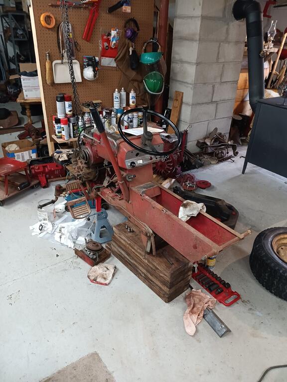

ebinmaine 79,637 #62 Posted February 18, 2024 24 minutes ago, Maz91 said: I can do a little restoration project 😎 A little inspiration for ya. 3 1 Share this post Link to post Share on other sites
