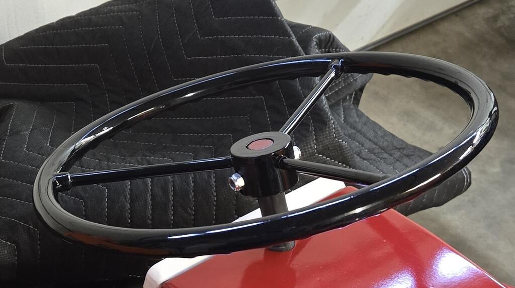

kpinnc 18,960 #127 Posted July 9, 2025 (edited) Last night I got the new steering wheel installed. I didn't want to drive a pin through it (steering wheel hole on the tank seems kinda breakable) so I used a bolt. The wheel was one of the splined ones still available online. Broke my 3/4 bit twice because one of the spokes stuck out a little inside. Getting past it was rough. Had to use a die grinder with a small stone to grind the end of the spoke down. Then getting the bit through was easy. Edited July 9, 2025 by kpinnc 6 2 Share this post Link to post Share on other sites
953 nut 69,283 #128 Posted July 9, 2025 3 minutes ago, kpinnc said: . I didn't want to drive a pin through it (steering wheel hole on the tank seems kinda breakable) With a bit of grease or Never-Seez on the troll pin a "C Clamp" can push the roll pin in without a problem. 4 Share this post Link to post Share on other sites
WHX?? 58,114 #129 Posted July 9, 2025 6 minutes ago, kpinnc said: Broke my 3/4 bit twice @Achto what did you use to drill a spline one out? 10 minutes ago, kpinnc said: so I used a bolt. My RJ has a hitch pin ... I know I know not original but sure is nice for hood removing. Share this post Link to post Share on other sites
kpinnc 18,960 #130 Posted July 9, 2025 4 minutes ago, WHX?? said: what did you use to drill a spline one out? Mine would have been easy if it wasn't for one spoke sticking out about 1/16. It was just enough to bind the bit. 2 Share this post Link to post Share on other sites
kpinnc 18,960 #131 Posted July 9, 2025 5 minutes ago, WHX?? said: My RJ has a hitch pin ... I know I know not original but sure is nice for hood removing. Actually my first choice, but my pins have a loop that is big enough to make contact with the fuel tank. 2 Share this post Link to post Share on other sites
WHX?? 58,114 #132 Posted July 9, 2025 (edited) 4 minutes ago, kpinnc said: one spoke Ahhh ...OK I thought you meant a spline was kitty wompus.... Nice work KP ... That motor should run really nice ... Edited July 9, 2025 by WHX?? 1 Share this post Link to post Share on other sites

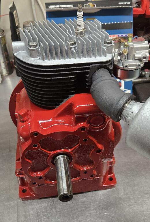

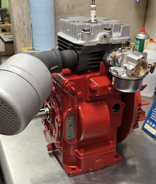

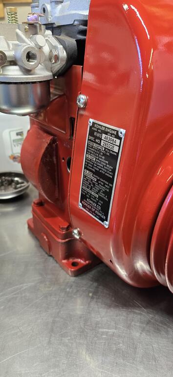

kpinnc 18,960 #133 Posted July 11, 2025 (edited) Block painted. Not perfect but looks better than it did. Yeah that's a cheapo carb on it. The original is badly corroded and is gonna take a lot of work. It'll get rebuilt soon. Spark plug is just a dust cap. Not even threaded... Edited July 11, 2025 by kpinnc 4 8 Share this post Link to post Share on other sites
Achto 32,686 #134 Posted July 13, 2025 On 7/9/2025 at 7:13 AM, WHX?? said: what did you use to drill a spline one out? I chucked the steering wheel up in a lathe by the hub and spun it slow. Bit walked through clean. 3 Share this post Link to post Share on other sites
kpinnc 18,960 #135 Posted July 14, 2025 3 hours ago, Achto said: chucked the steering wheel up in a lathe by the hub and spun it slow. Bit walked through clean. Wanted to do the same, but my lathe and drill press aren't big enough. Had to do it the old fashioned stompin and cussing way. 5 Share this post Link to post Share on other sites

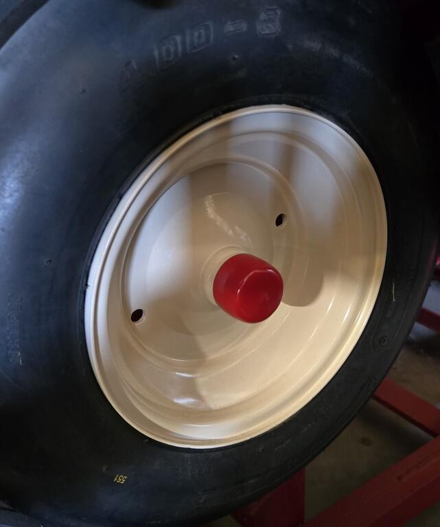

kpinnc 18,960 #143 Posted May 8 Dust caps! The old 701 will finally get the most attention (finally) for a few days. Gotta get it down from the workstand so the Blackhood can go on! Sheetmetal and paint. NOT my strongsuits! 8 1 Share this post Link to post Share on other sites
WHX?? 58,114 #144 Posted May 8 2 hours ago, kpinnc said: finally get the most attention 'Bout freakin time... 1 3 Share this post Link to post Share on other sites

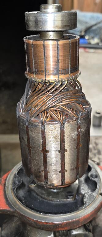

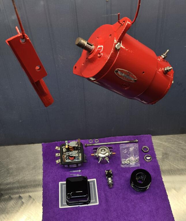

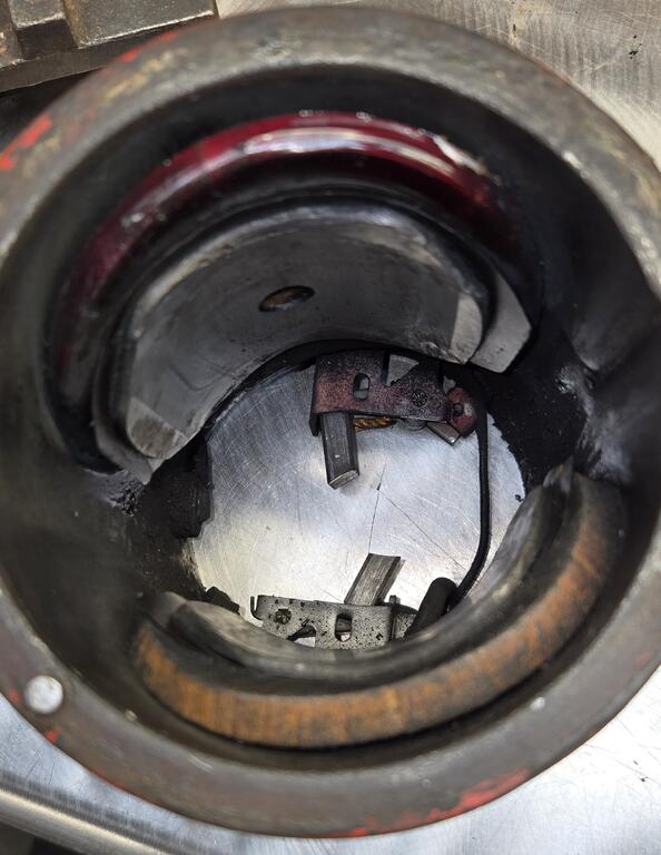

kpinnc 18,960 #145 Posted May 10 Checked the S/G this evening and it's pretty clean with smooth tight bearings. Brushes are decent. Wiped it out, put her back together and bench tested. Tomorrow is electrical day... 2 8 Share this post Link to post Share on other sites
squonk 48,119 #146 Posted May 10 8 hours ago, kpinnc said: Checked the S/G this evening and it's pretty clean with smooth tight bearings. Brushes are decent. Wiped it out, put her back together and bench tested. Tomorrow is electrical day... Now you need to clean off that nice paint where it bolts together. (See my post about grounds) 3 1 Share this post Link to post Share on other sites
ebinmaine 80,694 #147 Posted May 10 20 minutes ago, squonk said: Now you need to clean off that nice paint where it bolts together. (See my post about grounds) Separate ground wires for every circuit. When the machines starts to look like black wire spaghetti you're getting close. 1 Share this post Link to post Share on other sites
702854boy 1,149 #148 Posted May 11 13 hours ago, ebinmaine said: When the machines starts to look like black wire spaghetti you're getting close. Mine already looks like that because every wire except the 6 gauge positive battery cables are black 1 Share this post Link to post Share on other sites

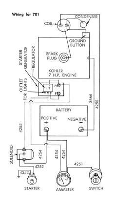

kpinnc 18,960 #149 Posted May 11 (edited) 14 hours ago, squonk said: Now you need to clean off that nice paint where it bolts together. Already did that and tested my grounds. 14 hours ago, ebinmaine said: Separate ground wires for every circuit. Yep. I'm a proponent of ground jumpers. But... this 701 wiring diagram has some issues. The starter switch for one, goes from ground to the starter tab on the solenoid. Ground start? Also I do not have a working amp meter. Both of the ones I had set aside are open. Can I take my wire from the "GEN" middle tab directly to the positive on the battery? Edited May 11 by kpinnc 1 Share this post Link to post Share on other sites
WHX?? 58,114 #150 Posted May 11 1 minute ago, kpinnc said: The starter switch for one, goes from ground to the starter tab on the solenoid. That is correct KP. The starter button grounds out the solenoid operating it. The the other end of the solenoid coil is internally connected to 12v positive large post. You do have to have the 12v from the battery on the correct large post. I forget if they are labeled or not. If not one way to tell is read through the small post to one of the large posts. You should see the resistance of the coil on one of the large posts. That's the large post that gets connected to the battery. Should be open on the other large post. I have no idea why went this route. It's been said this same solenoid was used on some truck sno plow set ups. 2 1 Share this post Link to post Share on other sites
