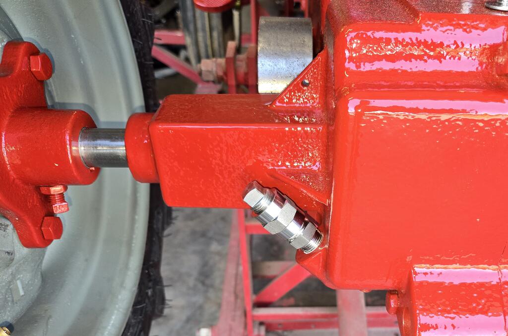

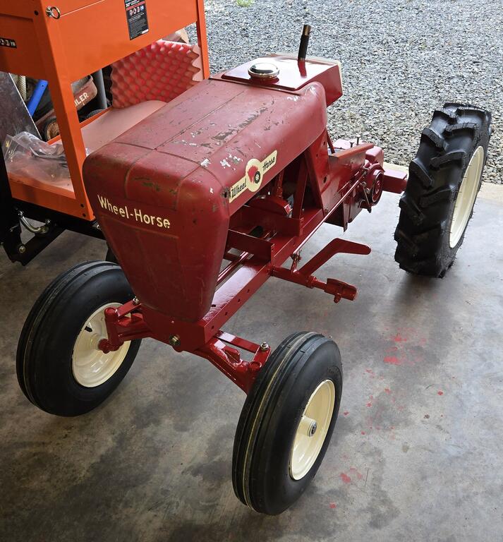

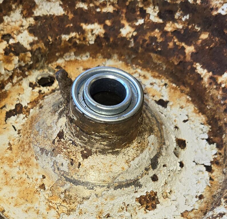

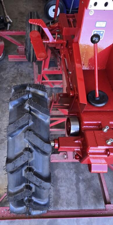

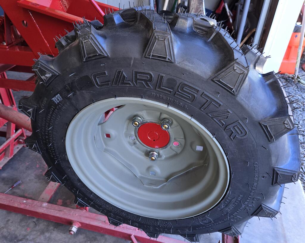

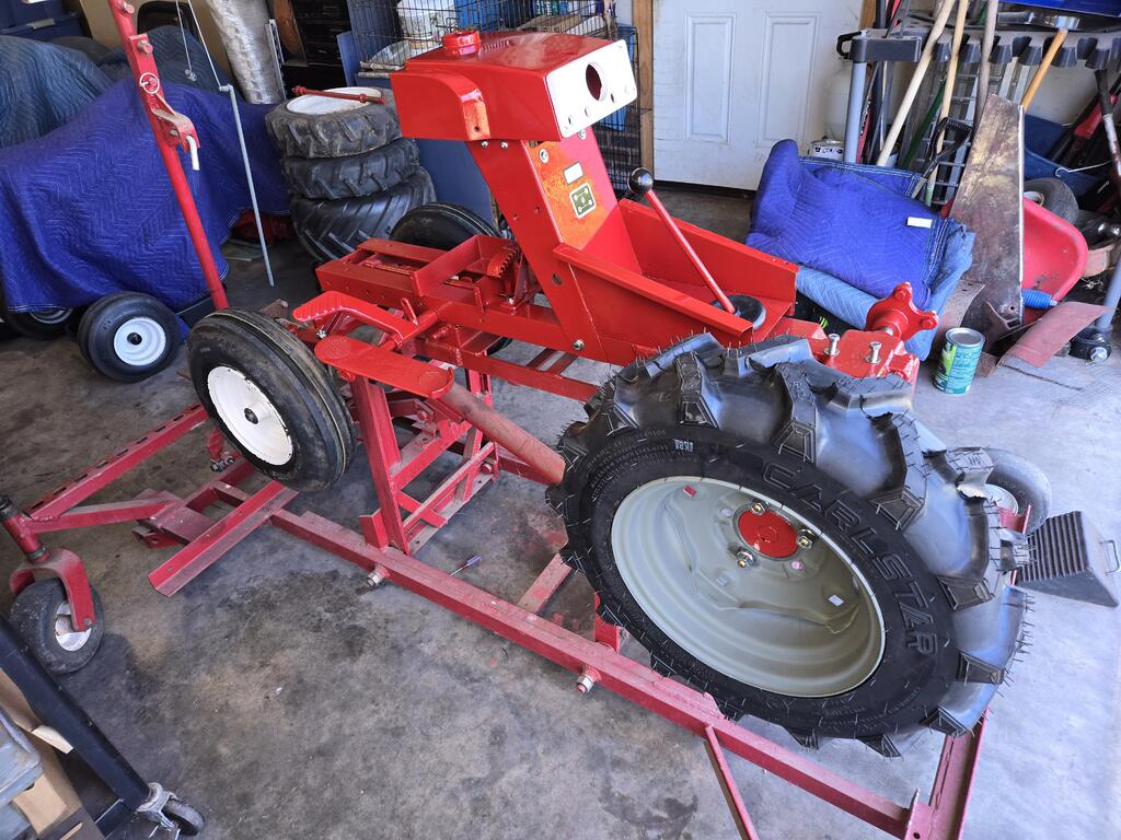

kpinnc 18,960 #102 Posted April 13, 2025 (edited) I didn't a little test fitting and a few little things today. I stuck wheels on it just to make it look sorta like a tractor. Rears are in primer and the fronts are the tires I'll be using but the original wheels are a disaster. More on that later... I repainted the tank using Rustoleum clear. I guess it's decent, but doesn't compare to the luster of the 2K clear. It may get a coat later. I really like the lineup of the wheels front to back with the wider axles. It's hard to see in the picture, but the wheels are perfectly online from front to back. Added a little bling on the oil fill plug. Now I can hold the extention with a wrench when removing the plug. I always hated how the extention always breaks loose first! The front wheels... Somebody did some hillbilly engineering from way back in the swamp on these. The bearings were replaced with a bronze sleeve and full length bushing in both wheels. One was damaged a bit and I had to round the hub back out. Test fitted a crap bearing just to see if it was snug. These wheels are really rough. They will get the workover in the next few days. Anyway- she's coming together. She has her flaws, but will look decent when finished. The pits just add character! Edited April 13, 2025 by kpinnc 3 8 Share this post Link to post Share on other sites
AlexR 3,109 #103 Posted April 13, 2025 Looking great!!! Those tires are definitely the right ones. Going to be a beautiful tractor when you are done. 2 1 Share this post Link to post Share on other sites

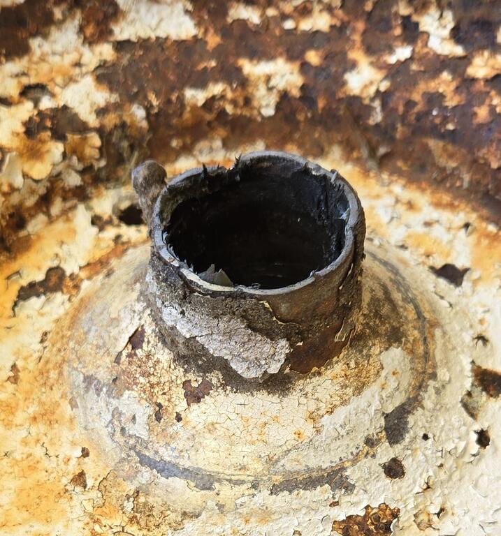

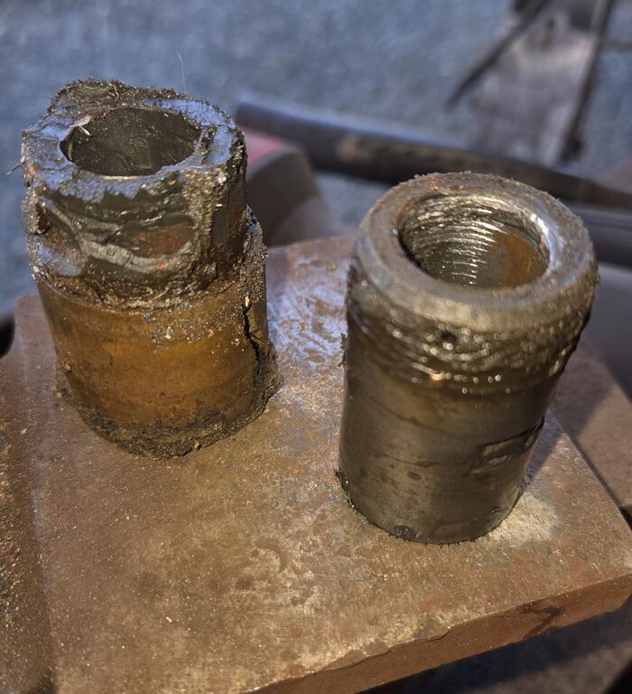

kpinnc 18,960 #104 Posted April 14, 2025 There was one more thing I had hoped to save. It was badly bent and had to be straightened and a new nipple welded on. Took up the rest of my afternoon. It isn't perfect, but it looks good enough. 1 7 Share this post Link to post Share on other sites
kpinnc 18,960 #105 Posted April 14, 2025 1 hour ago, AlexR said: Those tires are definitely the right ones. Thank you! Yes they look nice. Might be a bit harsh on my backside. They are heavy duty! 2 3 Share this post Link to post Share on other sites
ebinmaine 80,694 #106 Posted April 14, 2025 9 hours ago, kpinnc said: There was one more thing I had hoped to save. It was badly bent and had to be straightened and a new nipple welded on. Took up the rest of my afternoon. It isn't perfect, but it looks good enough. Got a "before" pic? 2 Share this post Link to post Share on other sites
kpinnc 18,960 #107 Posted April 14, 2025 4 hours ago, ebinmaine said: Got a "before" pic? No. I am not that smart... 3 Share this post Link to post Share on other sites

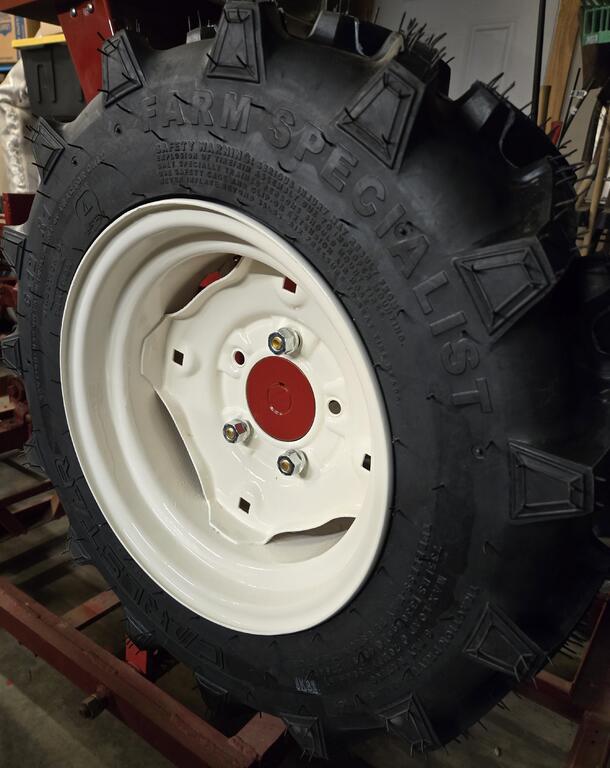

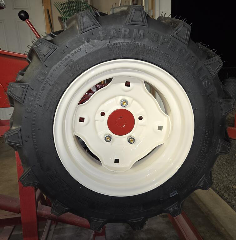

kpinnc 18,960 #108 Posted April 19, 2025 Just to say I did something today, I tried a new wheel color. 2 5 Share this post Link to post Share on other sites
WHX?? 58,114 #109 Posted April 19, 2025 12 hours ago, kpinnc said: tried a new wheel color. I like it This would be be the correct muffler but they are getting hard to find in 1 inch and when you do they don't exactly give them away. 1 Share this post Link to post Share on other sites

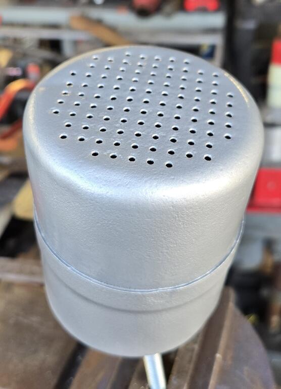

kpinnc 18,960 #110 Posted April 20, 2025 15 hours ago, WHX?? said: This would be be the correct muffler I know but the one I have is what was on it, and I really like that pepper shaker style. Years ago when I bought it I remember it stood out to me that it was different. I straightened it up the best I could and added another baffle in the neck when I replaced it. I hope it works well. 4 Share this post Link to post Share on other sites

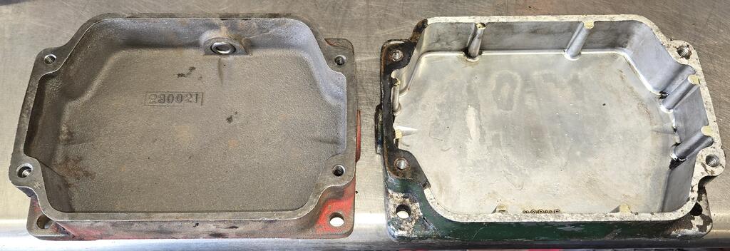

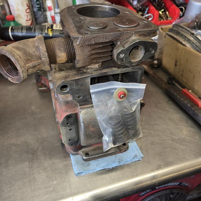

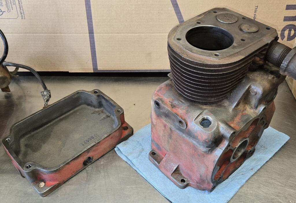

kpinnc 18,960 #111 Posted April 20, 2025 Well I got the engine ready to go to the machine shop. Took it all apart, cleaned the block. Also took the donor K181 apart for the piston. The piston looks brand new with the only scratches being what I put on it removing the old rings. Also- the donor engine had an aluminum pan. Full size just like the cast version. I've never seen that before. 4 5 Share this post Link to post Share on other sites

WHX?? 58,114 #113 Posted April 30, 2025 On 4/20/2025 at 5:37 PM, kpinnc said: donor engine had an aluminum pan. Full size just like the cast version. I've never seen that before. That's bizarre... crank is on the way. 1 1 Share this post Link to post Share on other sites

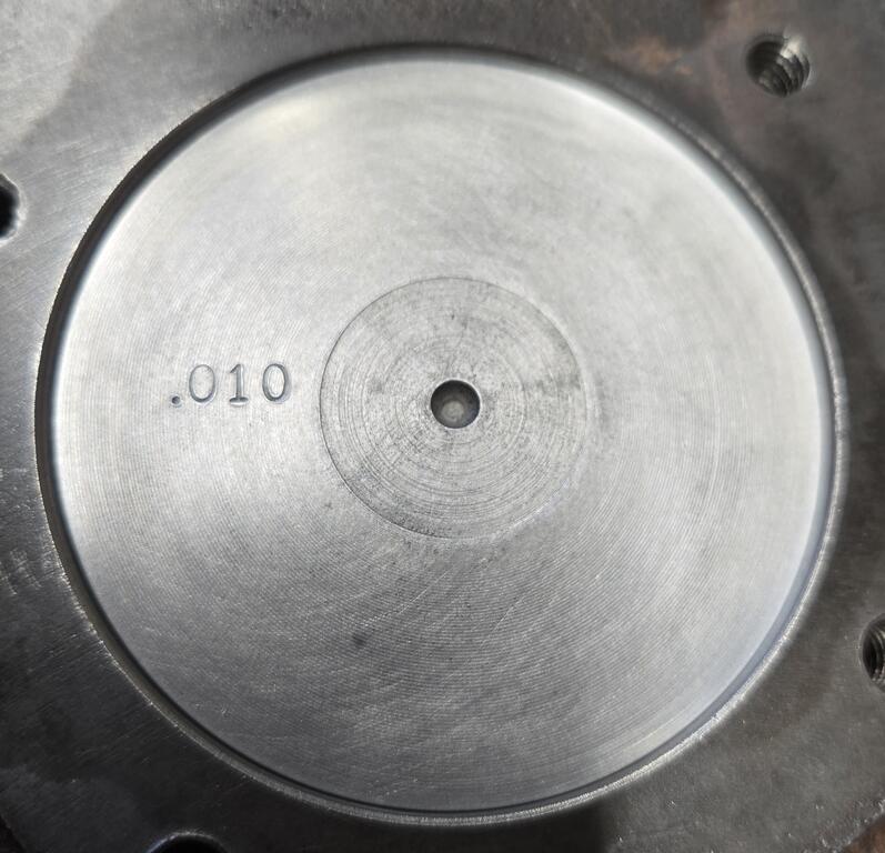

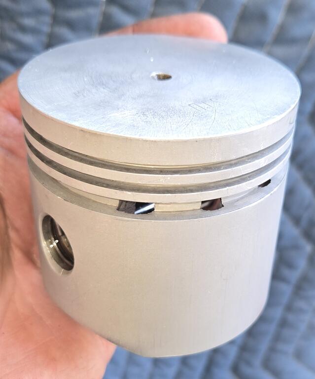

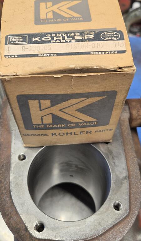

kpinnc 18,960 #114 Posted April 30, 2025 4 hours ago, WHX?? said: That's bizarre... crank is on the way. Thank you! I have found a NOS 2.885 (.010 over) piston and ring set. Probably won't be installed for a while until I get the crank ground so I know which rod to get. That matches what my block was bored for, and keeps the "smaller" original bore as well. 4 Share this post Link to post Share on other sites
kpinnc 18,960 #115 Posted May 2, 2025 Correct piston came today. Needed to be cleaned up a little (light oxidation because it had been out of the plastic), and it looks great. Matches the bore perfectly. Little by little! 2 3 Share this post Link to post Share on other sites

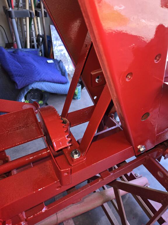

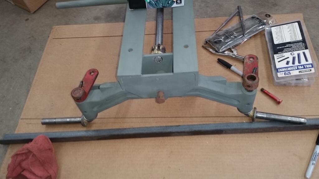

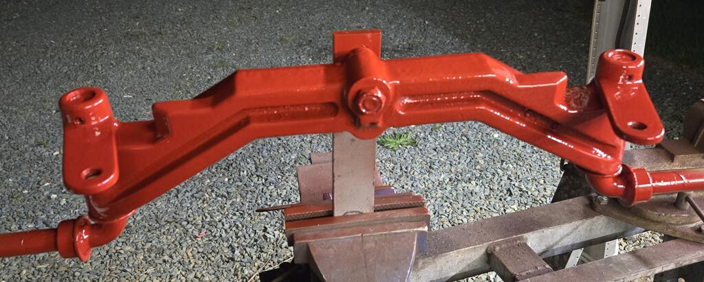

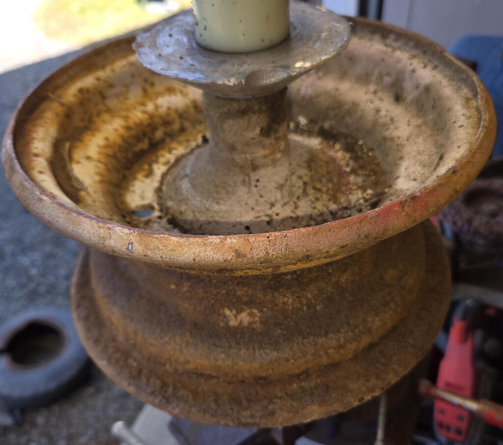

kpinnc 18,960 #116 Posted May 25, 2025 (edited) Still haven't taken the crank to be ground so I fixed another issue: the left front spindle was wallowed out enough to let the wheel wobble a bit, so I welded the hole for the roll pin up and re-drilled it. Surprisingly it all worked out and fit perfectly. Since my front axle was one of my clear coat guinea pigs, I had to strip it back to bare metal and repaint it. The 2 part clear coat is good stuff, but it shrinks more than a weenie in winter. The base coat needs to be properly cured before applying it. Anyway, I used the rustoleum clear over the base and it looks good enough. The spacers on the spindles are just temporary. My original wheels are gonna take a great deal of work before I can use them. Edited May 25, 2025 by kpinnc 1 5 1 Share this post Link to post Share on other sites

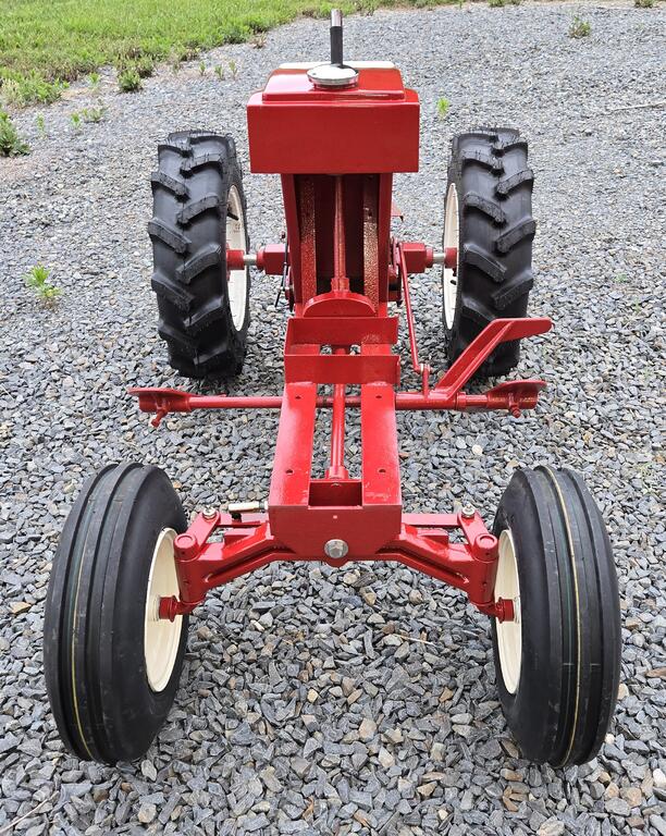

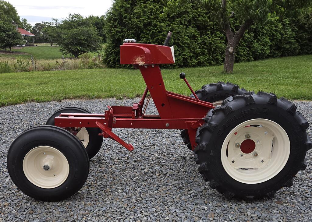

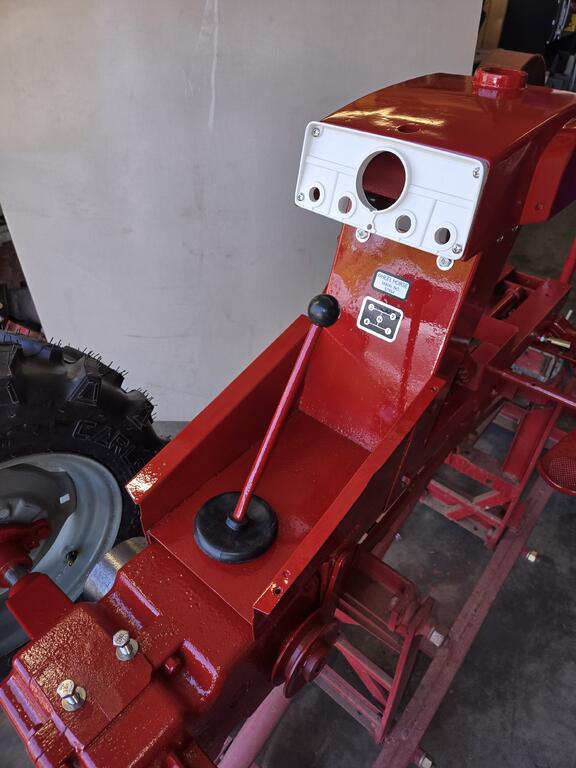

kpinnc 18,960 #117 Posted May 25, 2025 (edited) Not much, but it's on all fours. Still gotta finish the rear wheels. The fronts are likely temporary, but the originals are nasty and will take a while. I got tired of it being on the stand and at least it looks like a tractor a little more now. Haven't even started the sheet metal but I set the hood on for grins... Edited May 26, 2025 by kpinnc 2 8 Share this post Link to post Share on other sites
AlexR 3,109 #118 Posted May 26, 2025 It still never gets old seeing these old wheelhorse's getting redone. All the shiny paint and new shoes! 5 Share this post Link to post Share on other sites
WHX?? 58,114 #119 Posted May 26, 2025 On 5/24/2025 at 10:49 PM, kpinnc said: welded the hole for the roll pin up and re-drilled it. Mine was the same ... it was a poke & hope with an over size pin for me. Spindle repairs like that are a son of a gun... nice job. 3 1 Share this post Link to post Share on other sites

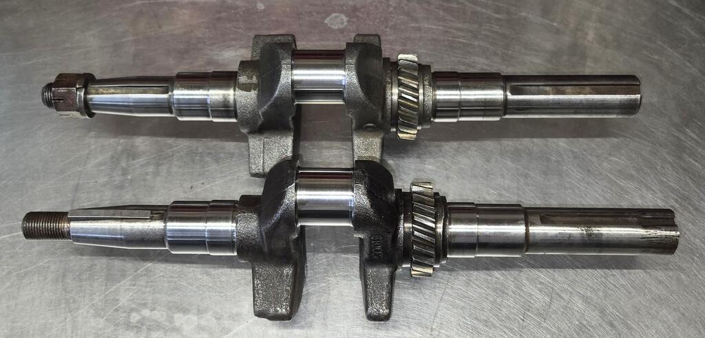

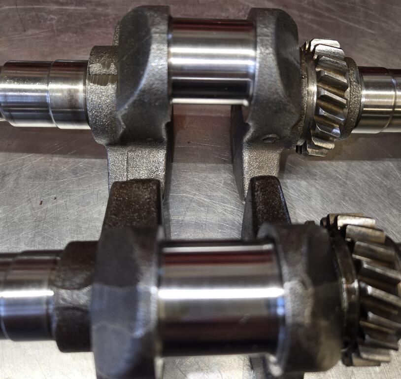

kpinnc 18,960 #121 Posted June 11, 2025 Took a while, but I now have two K160/161 cranks ground and polished. The original crank from the 701 was .013 below minimum when pulled from the engine. It looked very nice but probably would have had some slap if used as it was. Talk about well worn! It was ground to .020 undersized. The second crank came from @WHX?? and it was ground to .010 undersized. Now I just need to find a good connecting rod, and I'll finally be able to get back to the 701 build. The shop sure knows how to make them pretty! Cost me $85 for both since only one machine setup was needed. Total for engine work is just under $200. That's an oversize cylinder bore, recut valve seats and valves ground, and grinding two cranks. Not too bad for today's prices. 2 7 Share this post Link to post Share on other sites

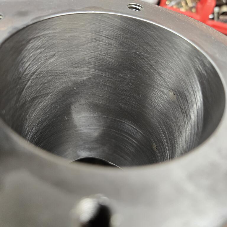

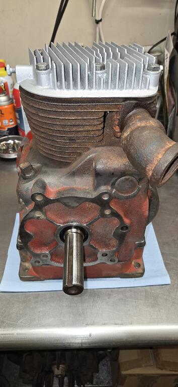

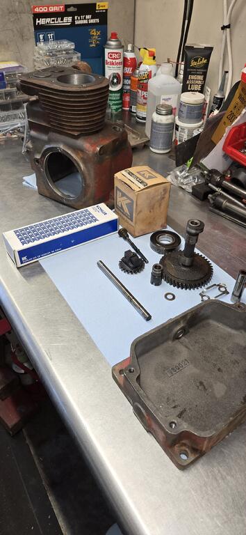

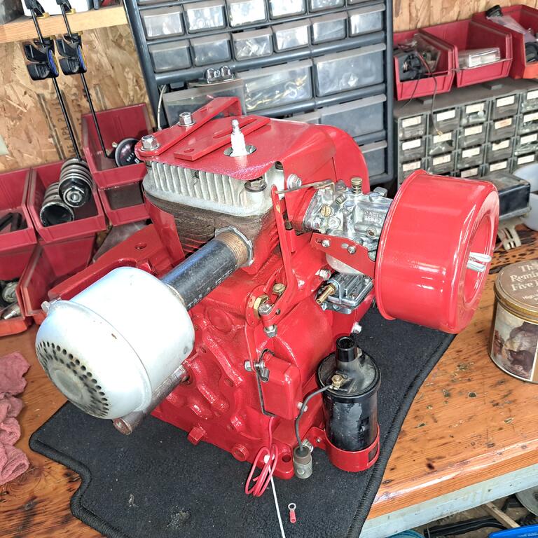

kpinnc 18,960 #122 Posted July 8, 2025 (edited) I've had alot going on lately, and it's been hot. But I decided to at least get started reassembling the K161. I had the block bored .010 over, the crank .010 under. I also found a NOS correct small bore OEM piston and a NOS undersized OEM rod. It took a while, but it was worth it. I also had the valves reground. Many thanks to the folks who provided the correct part numbers, because I would've never found them! Part of me knows it would've been easier to swap to the same piston and rod as the K181, but I like that ONE of my tractors is gonna be very close to correct. This one has sentimental value. My wife bought it for me on Father's Day nearly 20 years ago. She even recruited a few of my coworkers to go get it and deliver it. Anyway... I got to tinker a little last night while it was cool in the garage. The K161 is buttoned up, though it still needs paint and all the external stuff added. But it's closed up and hopefully good to go. I know one thing: 65 years ago, Kohler did some stuff differently than they did in later years with the K series and Magnums. Timing marks, reed valves, camshafts... this thing was odd! I hope I figured it out the right way. Maybe I'll have time later in the week for more. I got a M8 that belongs to Don to work on, and I figured assembling this one might "re-familirize" me with these small blocks. I got a feeling they might be way different... Edited July 8, 2025 by kpinnc 2 7 Share this post Link to post Share on other sites
