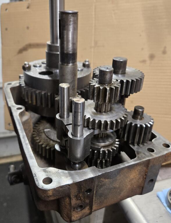

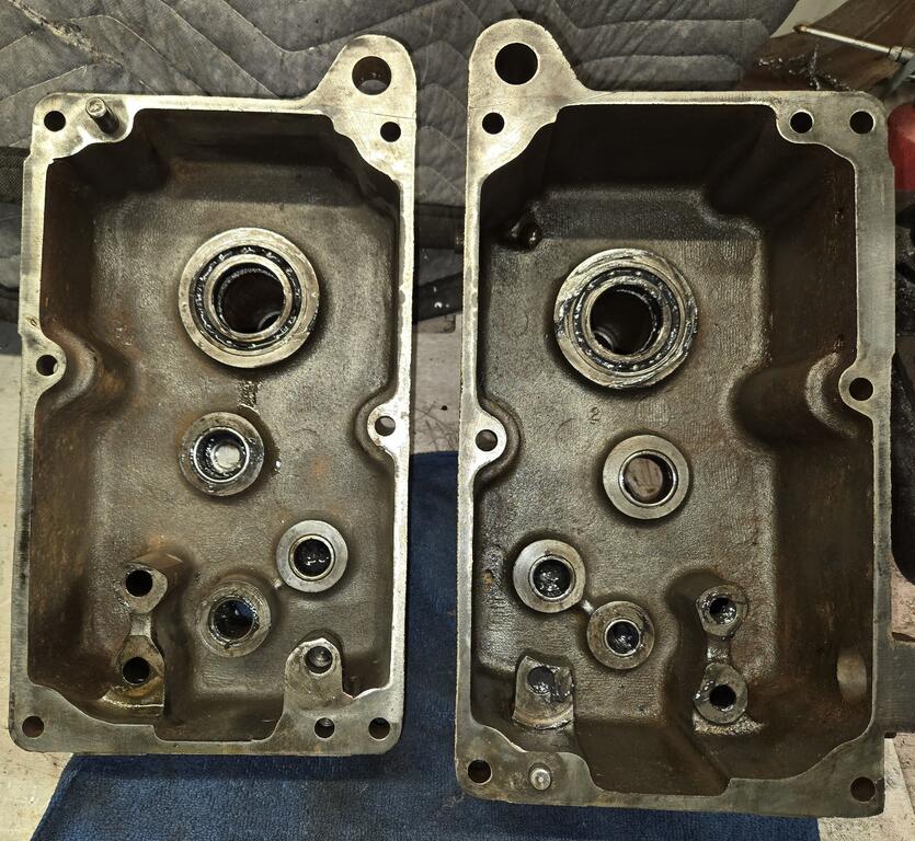

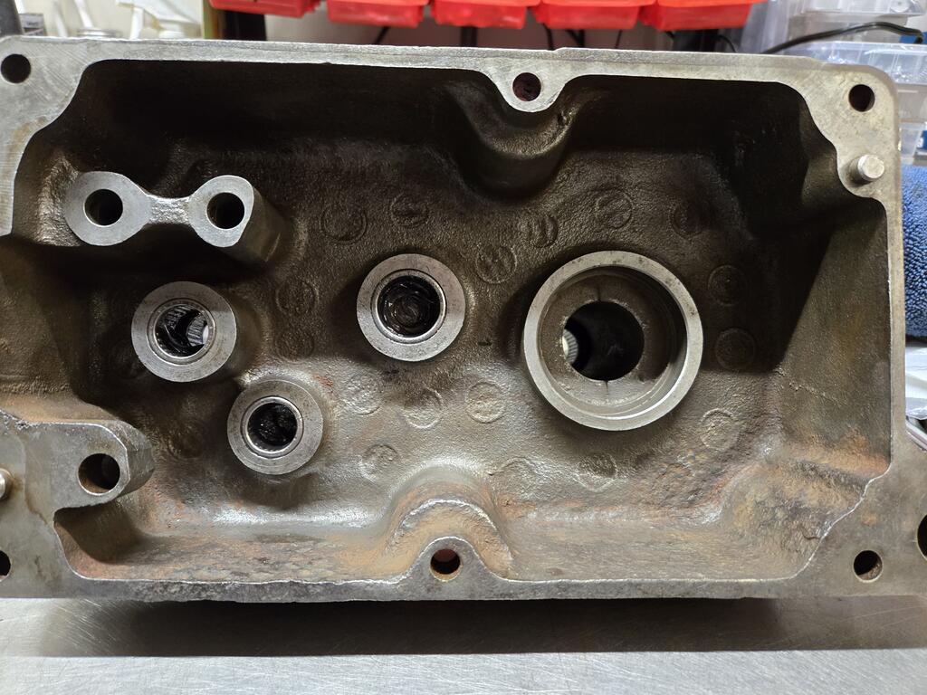

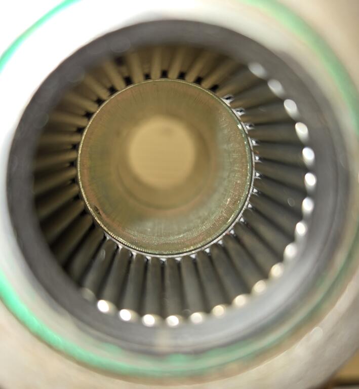

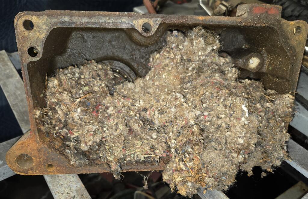

kpinnc 18,960 #51 Posted February 25, 2025 Holy rodent hotel batman! My spare 3 speed case had some visitors! Cleaned up nice though. Needle bearings are smooth and tight. I'll pick the best of the 3 sets of 1533s and use them. New outer axle bearings and new seals all around are on the way. Any opinions on using longer axles yet? 2 1 Share this post Link to post Share on other sites

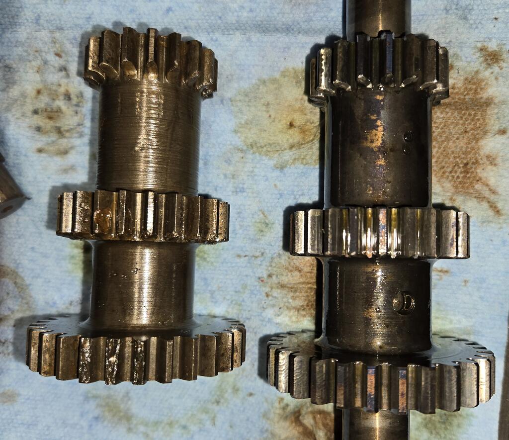

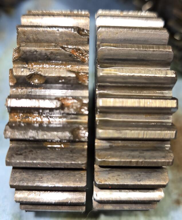

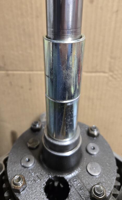

kpinnc 18,960 #57 Posted February 27, 2025 (edited) I figured out a way to save the original case, so that's the one I built up tonight. My "spare" case is ok as well, but I'm gonna save it for another project. The right side of the case at the axle bearing is not quite as tight (only a few thousands) as the left. The bearing couldn't be pushed by hand, but it did go in much easier than the left side. It was too tight to shim. If you look at the original disassembly, the axle bearing had slipped into the case and no longer supported the axle. So I'm going to add thin hitch pin spacers on the axle just to make a stop so the bearing can't move into the case again. The case where the bearing sits isn't worn, it's just slightly larger. Anyway- got the original case cleaned out. Ignore the black goo in the bearings. I used some assembly lube just because I didn't want to cram everything together dry. Replaced the axle bearings and all the seals (axle, brake shaft, input shaft) with all new. Borrowed a few parts from the bad 8-speed as well. 2 small capped needle bearings, and the 3 worst gears (comparison on the good/ bad gears below). Also gonna use the shifter rails so I won't have shifting issues with this transmission. I've also decided to use the differential and axles from the donor tranny. Assembly tomorrow... Edited February 27, 2025 by kpinnc 3 3 Share this post Link to post Share on other sites

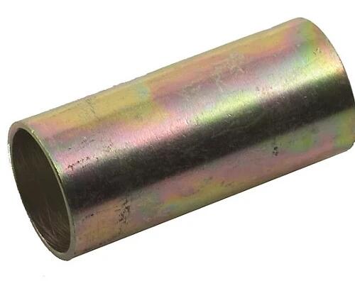

ebinmaine 80,694 #58 Posted February 27, 2025 4 hours ago, kpinnc said: axle bearing had slipped into the case and no longer supported the axle. So I'm going to add thin hitch pin spacers on the axle just to make a stop so the bearing can't move into the case again. Can you elaborate on this? Pics? Several inches of shims between the inner and outer bearings? Or am I overlooking.... 2 Share this post Link to post Share on other sites
kpinnc 18,960 #59 Posted February 27, 2025 4 hours ago, ebinmaine said: Can you elaborate on this? Pics? Several inches of shims between the inner and outer bearings? No sir. I'm talking top link spacers for CAT2 tractor stuff. They are 1 inch ID, thin wall steel spacers. 2 of them slip loosely over the axle, and combined allow for 1/4 "in or out" axle movement but prevent the bearing slipping into the case. The only direction the bearing can go is outward, so at least it would be visible should that happen. The spacers slip loosely over the axle and do not touch anything else inside the case. Two spacers fit perfectly between the diff end cap and outer axle bearing, but still allow for the axial in/ out play. 4 2 Share this post Link to post Share on other sites
kpinnc 18,960 #60 Posted February 27, 2025 1 hour ago, kpinnc said: The spacers slip loosely over the axle and do not touch anything else inside the case. Two spacers fit perfectly between the diff end cap and outer axle bearing, but still allow for the axial in/ out play. And for clarification- the spacers touch nothing unless the bearing slides inward over the axle. 2 Share this post Link to post Share on other sites

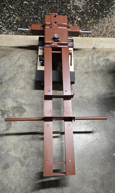

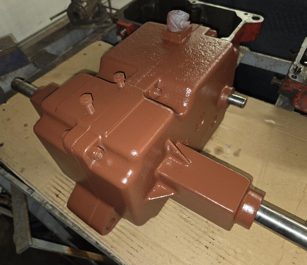

kpinnc 18,960 #61 Posted February 28, 2025 Well I got this far today. I'll finish up in the next day or two. So far so good. 2 8 Share this post Link to post Share on other sites
AlexR 3,109 #62 Posted February 28, 2025 I'm a little confused where would a mouse get in the transmission?? Even if the transmission shifter is out that is still a pretty small hole to get through. 1 Share this post Link to post Share on other sites
ebinmaine 80,694 #63 Posted February 28, 2025 36 minutes ago, AlexR said: I'm a little confused where would a mouse get in the transmission?? Even if the transmission shifter is out that is still a pretty small hole to get through. That shifter hole is more than enough. An average mouse only needs a dime sized entrance. 3 Share this post Link to post Share on other sites
kpinnc 18,960 #64 Posted February 28, 2025 2 hours ago, AlexR said: I'm a little confused where would a mouse get in the transmission?? That one was an empty 3 speed case that I had saved for whatever reason. No gears or axles. Plenty of holes to get into. Axles and brake shafts are 1 inch ID. 1 1 Share this post Link to post Share on other sites

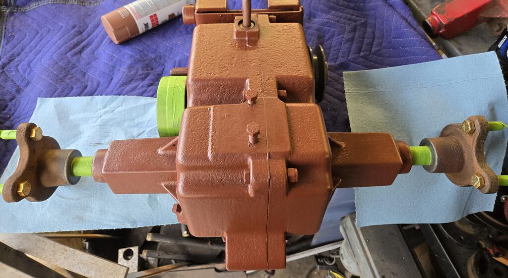

kpinnc 18,960 #65 Posted March 1, 2025 Well the transmission is all buttoned up. Bench ran it by hand. Shifts smoothly between all the gears. All new seals survived assembly. I taped the keyways on all of them. Also you can see how the spacers will work. They won't touch anything unless the axle bearing tries to slip again. I don't think it will, but I also don't want to have to worry about it. 8 Share this post Link to post Share on other sites
ebinmaine 80,694 #66 Posted March 1, 2025 2 hours ago, kpinnc said: how the spacers will work Nicely done there mister. 2 1 Share this post Link to post Share on other sites

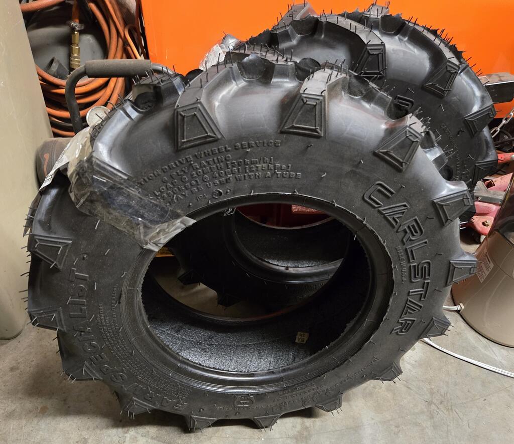

kpinnc 18,960 #67 Posted March 5, 2025 (edited) Been out of town for a few days. When I got home I found an early Easter present... Now my rear tires will be the correct size. Plus I already have an idea for the 5x12 ags from the previous pictures. That will wait until the 701 is finished. Edited March 5, 2025 by kpinnc 5 3 Share this post Link to post Share on other sites

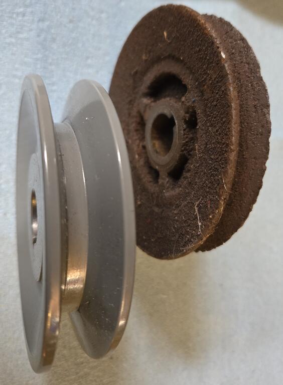

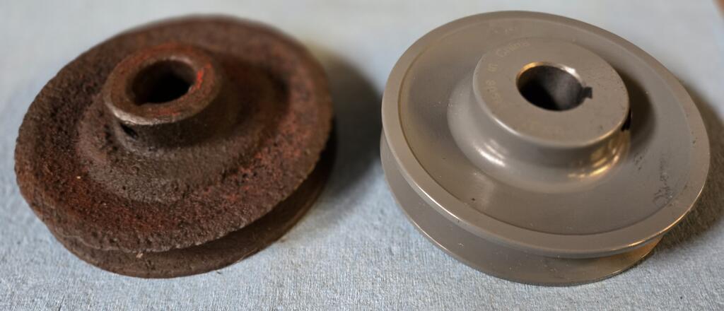

kpinnc 18,960 #68 Posted March 10, 2025 Had to get a new drive pulley for the transmission. There's just no chance of cleaning the original up to a serviceable condition. It clearly rubbed the guard alot and corroded from there. The outer lip is jagged and just too pitted to work with. The replacement isn't a perfect match but will work fine. 10 1 Share this post Link to post Share on other sites
AlexR 3,109 #69 Posted March 12, 2025 On 3/4/2025 at 10:28 PM, kpinnc said: Been out of town for a few days. When I got home I found an early Easter present... Now my rear tires will be the correct size. Plus I already have an idea for the 5x12 ags from the previous pictures. That will wait until the 701 is finished. Very Nice Beefy looking tires!! 2 1 Share this post Link to post Share on other sites

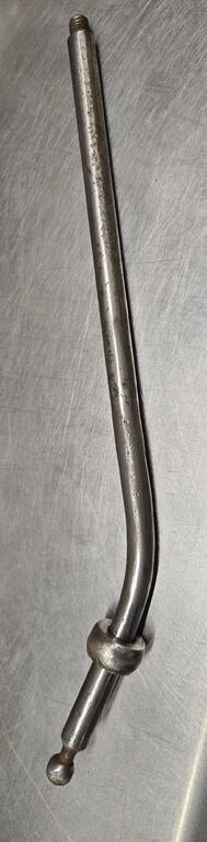

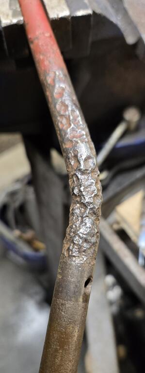

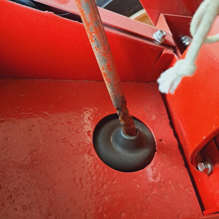

kpinnc 18,960 #70 Posted March 16, 2025 (edited) I don't understand why what should be the simplest restoration I've done can become an absolute PITA! Spent the biggest part of the day getting the footrests off. Dunno how I did it without breaking them, but I got both of them off. Then I stripped, cleaned, and primed the frame. Then I decided to try welding up the horrible shifter. Sheesh this thing was rotted! Turned out decent, at least it shouldn't break off in my hand. Wanted to get tires mounted. Maybe next time... Edited March 16, 2025 by kpinnc 4 6 Share this post Link to post Share on other sites

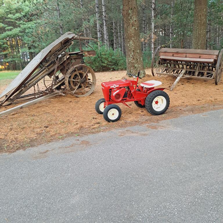

WHX?? 58,115 #71 Posted March 16, 2025 (edited) 9 hours ago, kpinnc said: Sheesh this thing was rotted! Left as is KP paint and all... for character and as a reminder the rough life this tractor had. Left a couple other parts like this too. Could have easily filled in those rust pits in the tunnel bottom but just love that look. You did a nice job on yours and keep at it Bit nicer weather and she will come out of winter storage Edited March 16, 2025 by WHX?? 4 4 Share this post Link to post Share on other sites
kpinnc 18,960 #72 Posted March 16, 2025 6 hours ago, WHX?? said: Left as is KP paint and all... for character and as a reminder the rough life this tractor had. Oh yeah mine has plenty of those beauty marks! I was afraid that if I left that shifter so pitted up it would snap right off. Your 701 is beautiful sir! 2 1 Share this post Link to post Share on other sites

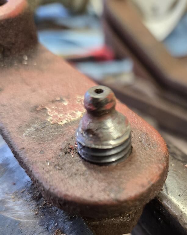

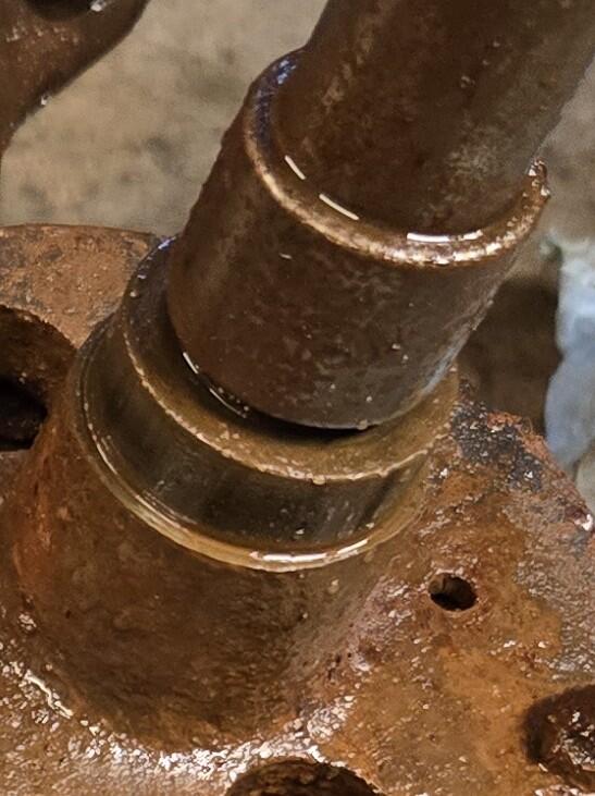

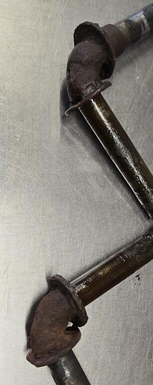

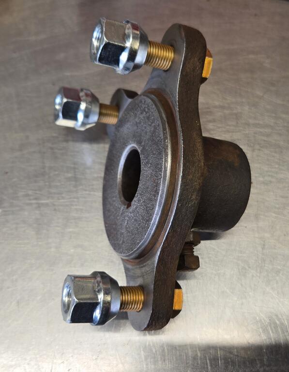

kpinnc 18,960 #73 Posted March 16, 2025 Got just a little done today. Finished all the parts on the transmission. Hubs, drive pulley, brake drum and shifter installed. I want to keep this one as close to correct as possible, but studs on the hubs just make sense to me. Then I moved to the front axle. What a bleeping mess! The pivot bolts apparently were both stripped out at the grease fitting, and the PO brazed one back on. I'll either drill and re-tap or just make new ones on my lathe. And the knuckles were "welded" for whatever reason. I noticed when the tractor was together that the front wheels were toed out and looked chambered in at the top. Now I see why.... I found a set from a 702. Hopefully they work. That's all for today. I'm done! 4 5 Share this post Link to post Share on other sites

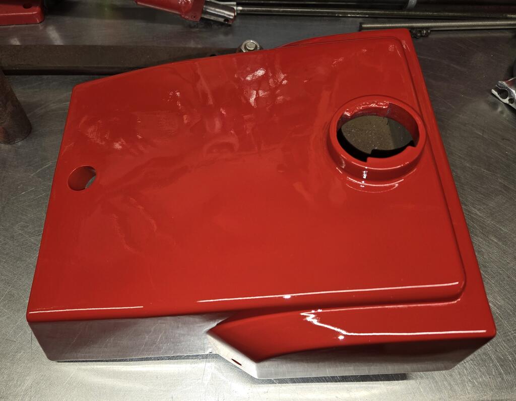

kpinnc 18,960 #74 Posted March 23, 2025 I just had to make something red... started with the fuel tank. Hopefully more red tomorrow. And some new clear coat to try out. 2 7 Share this post Link to post Share on other sites
