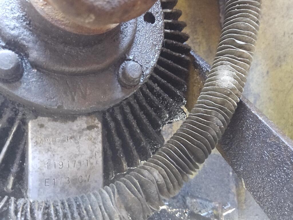

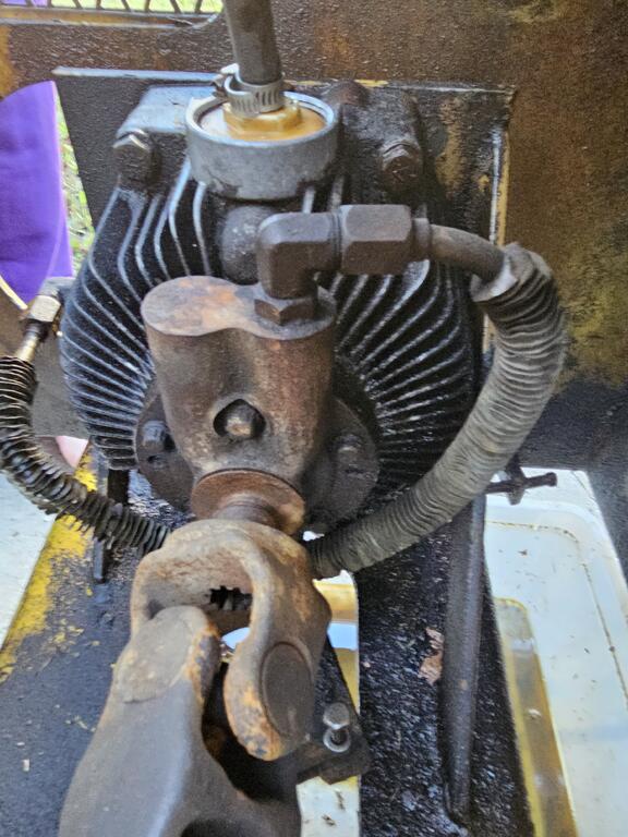

Huber54 1 #1 Posted November 4, 2023 I Have a machine with an Eaton 1100 transmission. It's not a yard tractor, it's a small Huber Roller. When the tansmission gets warm, it stops moving the machine and I get spurts of hydraulic oil back out through the resevoir. My questions: 1. What is causing this? 2. Is this a problem that can be fixed with a seal kit? 3. If not, does anybody have a source for a used Eaton1100 at a reasonable price? This machine was built in the 60's and I really don't want to sink a lot of $ into it. I live in Coastal NC. Thank you. Share this post Link to post Share on other sites
lynnmor 8,748 #2 Posted November 4, 2023 With the cooling fins on the line and the filthy fins on the unit, I have to wonder if there is a fan missing. Wheel Horse tractors have a plastic fan next to the fins and when they are missing or broken overheating will happen quickly. Share this post Link to post Share on other sites

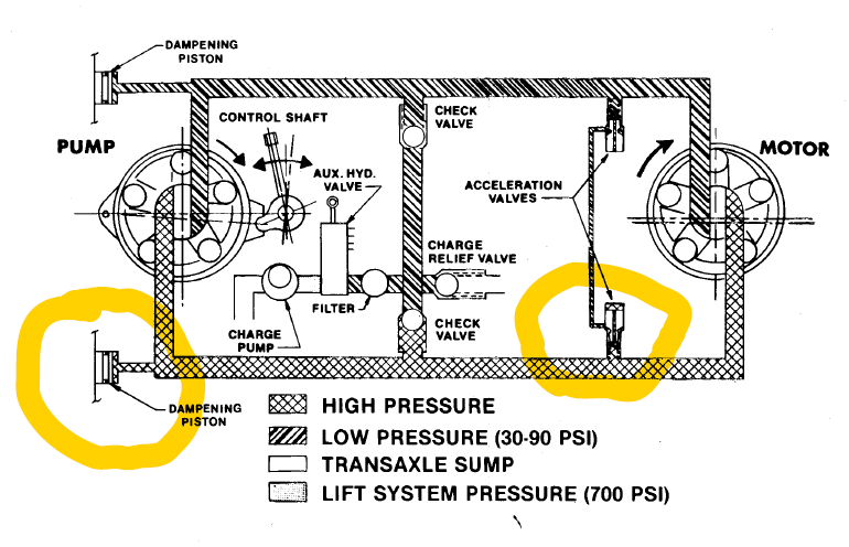

JoeM 9,768 #3 Posted November 4, 2023 2 hours ago, Huber54 said: gets warm, it stops moving the machine and I get spurts of hydraulic oil back out through the resevoir One problem I seen with the 1100's the get warm and struggle is the damping piston o-rings get worn or have a defect. Especially if the machine does the same forward and reverse. If you want to do a test by changing to 40 or 50w oil. Might just get you by. ?? That particular 1100 looks like it has a splines input making it pretty special, the WH ones are smooth keyed. Share this post Link to post Share on other sites
wfrpalm 218 #4 Posted November 4, 2023 It sounds like it over heating, I had a tractor that had all the blades on the fan break off and it did the same thing. Share this post Link to post Share on other sites
Huber54 1 #5 Posted November 4, 2023 I concur that it is overheating. Now more questions: 1. will keeping the unit cooler (Using the fans I see on many applications of this tranny) alliveate this problem? 2. Since the splined shaft indicates that it is special. (I gave a pic of the numbers hoping it would help.) I doubt the seal kit that is availabel from Jack's would fit. 3. I'm currently running Tractor supply Hydraulic oil. Before I knew what brand this thign was, I put 30W in, that (no surpise) did nothing. What is the recomended oil and can I just load it wiht STP liek we used to do. (yeah, I'm that old) Thanks again for your assistance. Share this post Link to post Share on other sites
JoeM 9,768 #6 Posted November 4, 2023 2 hours ago, Huber54 said: I put 30W in Should be good. If it is bypassing internally, it will only get worse as it heats up and then more heat will be generated. viscous cycle I am not sure about your machine but have seen some with small 12v fans blowing on the hydro. The wheel horse ones are input shaft mounted fan. This is the eaton troubleshooting guide. Eaton General Hydro T and R Doc.pdf Share this post Link to post Share on other sites

953 nut 65,322 #8 Posted November 5, 2023 If that was mine I would buy an automotive aftermarket oil cooler and electric fan to replace the small cooling loop. Very little oil is going to be in direct contact with the walls of that loop and most of the heat won't be removed. Share this post Link to post Share on other sites
