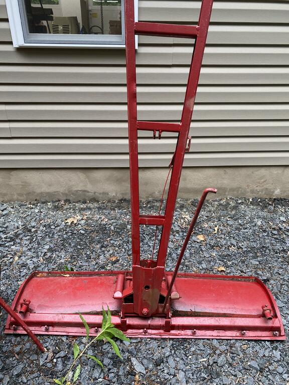

John Rizzardi 70 #1 Posted November 1, 2023 looking for the two(2) feet that keep snowblade from hitting ground, can i buy them or must i make the feet ? 1 Share this post Link to post Share on other sites
ebinmaine 80,918 #2 Posted November 1, 2023 I don't personally have any so I can't offer a purchase place or part number but I've seen a few people use the ones marketed towards ATVs. Whether you build them or buy them, getting the angle right may be the tough part. If you purchase or build the type that looks like a small cereal bowl or upside down cup just be sure the mounting stud is fairly close to the angle you're looking for and you should be okay. If you go with the ones that look like tiny little set of skis you may want to be a little more particular on setup so see if you can get them that have adjustable angle. On a side note, there's another way you can avoid digging in quite so hard. We set our plows so they are tilted more forward which offers two benefits to us. One is that the cutting edge of the plow at a more vertical angle which greatly reduces the tendency to dig into the ground surface. It also makes it so snow drift has far far less of a chance to come over the top of the plow causing you to get stuck. 1 Share this post Link to post Share on other sites

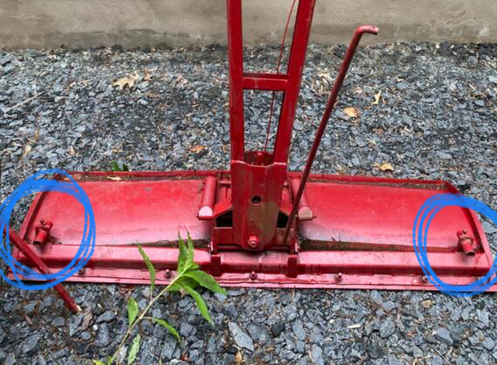

Pullstart 71,366 #9 Posted November 1, 2023 Just remember the rods are 3/4” when shopping elsewhere… Share this post Link to post Share on other sites
ebinmaine 80,918 #10 Posted November 1, 2023 22 minutes ago, Pullstart said: Just remember THE RODS are 3/4” when shopping elsewhere… Which rod Sir? Share this post Link to post Share on other sites
Pullstart 71,366 #11 Posted November 1, 2023 (edited) 26 minutes ago, ebinmaine said: Which rod Sir? the one that slides into the plow. Edited November 1, 2023 by Pullstart Photo 2 1 Share this post Link to post Share on other sites
John Rizzardi 70 #12 Posted November 1, 2023 Yes its the rods at the Left and Right lower shoes for plow, i spoke with a shop out in Bethel Pa, prolly an hour from my place, I’ve dealt with this shop b4, they are all about WH Tractors, in Lancaster County A to Z shop is spot on, highly recommend😉 1 Share this post Link to post Share on other sites
