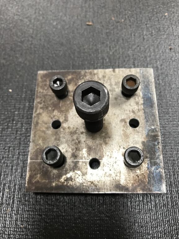

lynnmor 8,839 #7 Posted October 31, 2023 I made a simple flywheel puller, no need to hammer on crankshafts. 2 2 Share this post Link to post Share on other sites
RED-Z06 2,718 #8 Posted October 31, 2023 20 minutes ago, lynnmor said: I made a simple flywheel puller, no need to hammer on crankshafts. Pullers are a last resort after impact and heat for me, pullers put more stress on the center because you're building up to the force needed vs a quick burst...its still the same mechanical result...pushing the crank and flywheel in different directions to unseat the taper. 1 Share this post Link to post Share on other sites
lynnmor 8,839 #9 Posted October 31, 2023 I wonder why Onan has a puller in the factory toolkit? Prying with a screwdriver is not a good idea. 1 Share this post Link to post Share on other sites
