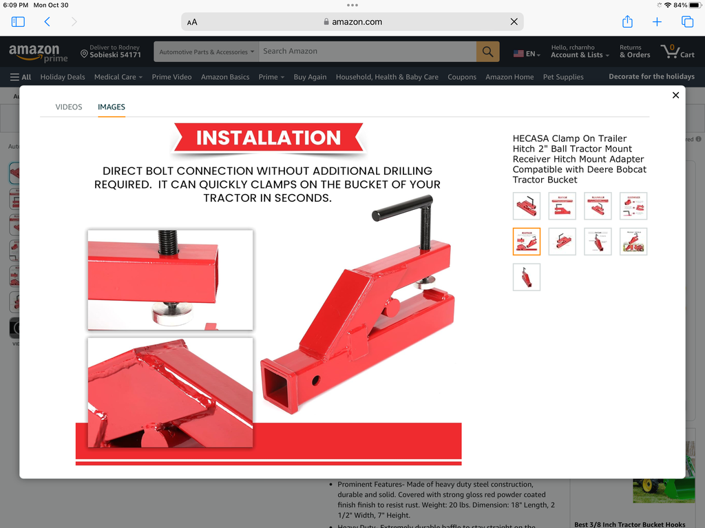

RJC1965 173 #1 Posted October 30, 2023 I am wanting to be able to have a hitch on front of my Kwik-Way loader on my 520H. I really did not want to drill a hole to mount one I saw this clamp on device for $40 dollars anyone use one of these or have any thoughts on this. 2 Share this post Link to post Share on other sites
wallfish 20,658 #2 Posted October 30, 2023 No reason why it wouldn't work. I drilled holes to attach a hitch ball to move trailers and such. Hooks on the top of the bucket are useful too 2 1 Share this post Link to post Share on other sites
SylvanLakeWH 32,695 #3 Posted October 31, 2023 (edited) Only question, will single point of friction be enough to keep it from walking around...? bumps, turns etc may see it shift with only a single pad for friction... Edited October 31, 2023 by SylvanLakeWH 1 Share this post Link to post Share on other sites
Pullstart 71,366 #4 Posted October 31, 2023 2 hours ago, SylvanLakeWH said: umps STRIKE 1! I think the welded 1/4” bar stock on the tip of it might act as a cleat to keep it from moving around too much. I’d trust it with any torque weight the loader could handle… 1 1 1 1 Share this post Link to post Share on other sites

WHX?? 58,302 #6 Posted October 31, 2023 (edited) I have one ... works good for moving light trailers around the ranch. Just ok for the heavier tandem and enclosed. Can lighten the rear end up for poor traction. On the big Mahindra will move anything. Keep the hitch short & stay alert to avoid bending the lighter buckets. Nice thing is you can just drive up the trailer and hook it without leaving the seat. Again make sure you lift high enough to get whatever trailer jack stand you have off the ground. They bend also... ... FYI RJC I saw them in the jungle for 18 bucks. Figured I could outfit both loaders on the cheap. It is a scam. They say it's been delivered but no. A complaint to the jungle gorillas got a refund tho. Odd thing was the gorillas didn't seem to care it is a scam. Edited October 31, 2023 by WHX?? 3 Share this post Link to post Share on other sites
RJC1965 173 #7 Posted October 31, 2023 9 hours ago, WHX?? said: I have one ... works good for moving light trailers around the ranch. Just ok for the heavier tandem and enclosed. Can lighten the rear end up for poor traction. On the big Mahindra will move anything. Keep the hitch short & stay alert to avoid bending the lighter buckets. Nice thing is you can just drive up the trailer and hook it without leaving the seat. Again make sure you lift high enough to get whatever trailer jack stand you have off the ground. They bend also... ... FYI RJC I saw them in the jungle for 18 bucks. Figured I could outfit both loaders on the cheap. It is a scam. They say it's been delivered but no. A complaint to the jungle gorillas got a refund tho. Odd thing was the gorillas didn't seem to care it is a scam. I have a fishing boat and 14ft single axle trailer say most would be around 1800 to 2200lbs. I would rather not drill a hole in my bucket so I think I will try one out and report back it’s like $30 dollars. I do have some small shaft 2 inch balls I will see how small the hole would be. Thanks for all the information love this site. 2 Share this post Link to post Share on other sites

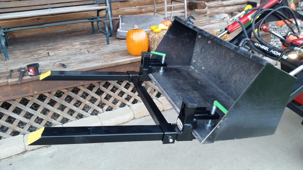

WHX?? 58,302 #8 Posted October 31, 2023 (edited) 25 minutes ago, RJC1965 said: I would rather not drill a hole in my bucket I wouldn't either and I had the drill out ready to go. I was so happy with the clamp on forks it's the way to go. Figured it be just in the way for other FEL chores. 'Sides in the bucket you can't see to hook but extended out just a bit you can see the hook standing on the floor boards. I have plenty of 2" hitches with every drop/rise imaginable. Plus convertible balls. Tip: Greasy Pete says keep the clamp screws lubed. Unloading the HF tool chest was painless. Edited October 31, 2023 by WHX?? 6 1 Share this post Link to post Share on other sites

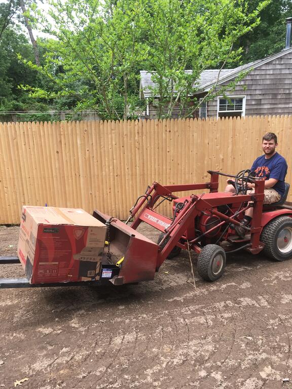

c-series don 12,519 #9 Posted November 1, 2023 Just like my son in law carrying this new grill!! 3 2 Share this post Link to post Share on other sites

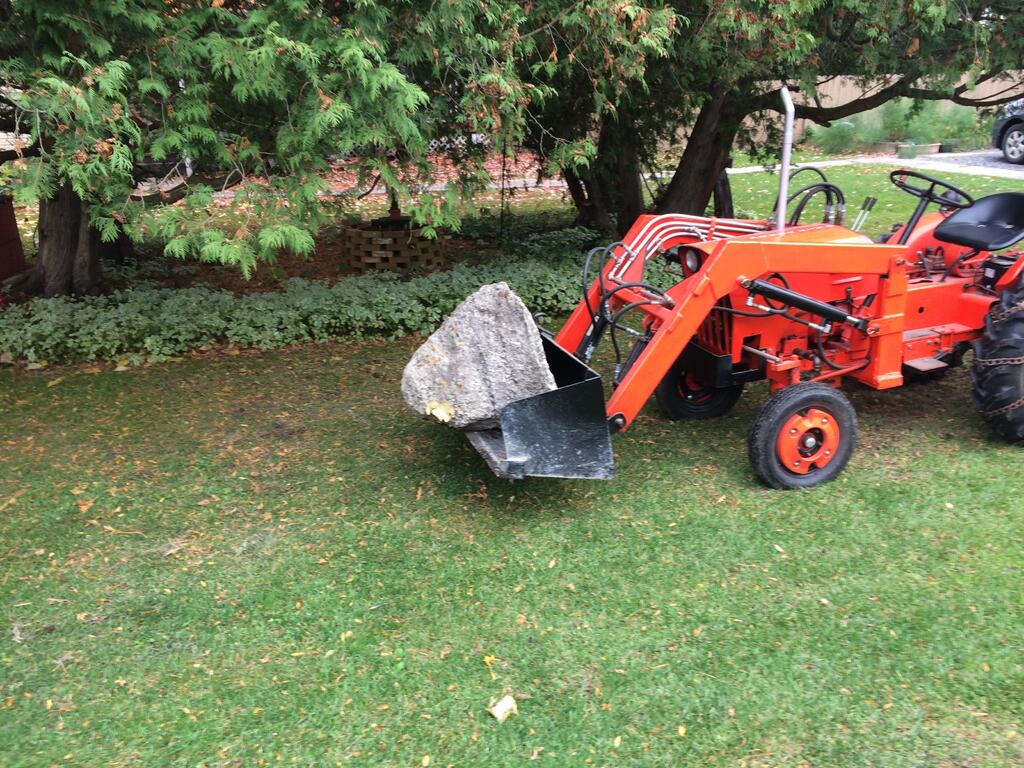

squonk 48,215 #10 Posted November 1, 2023 (edited) Will they work with this? Edited November 1, 2023 by squonk 1 Share this post Link to post Share on other sites

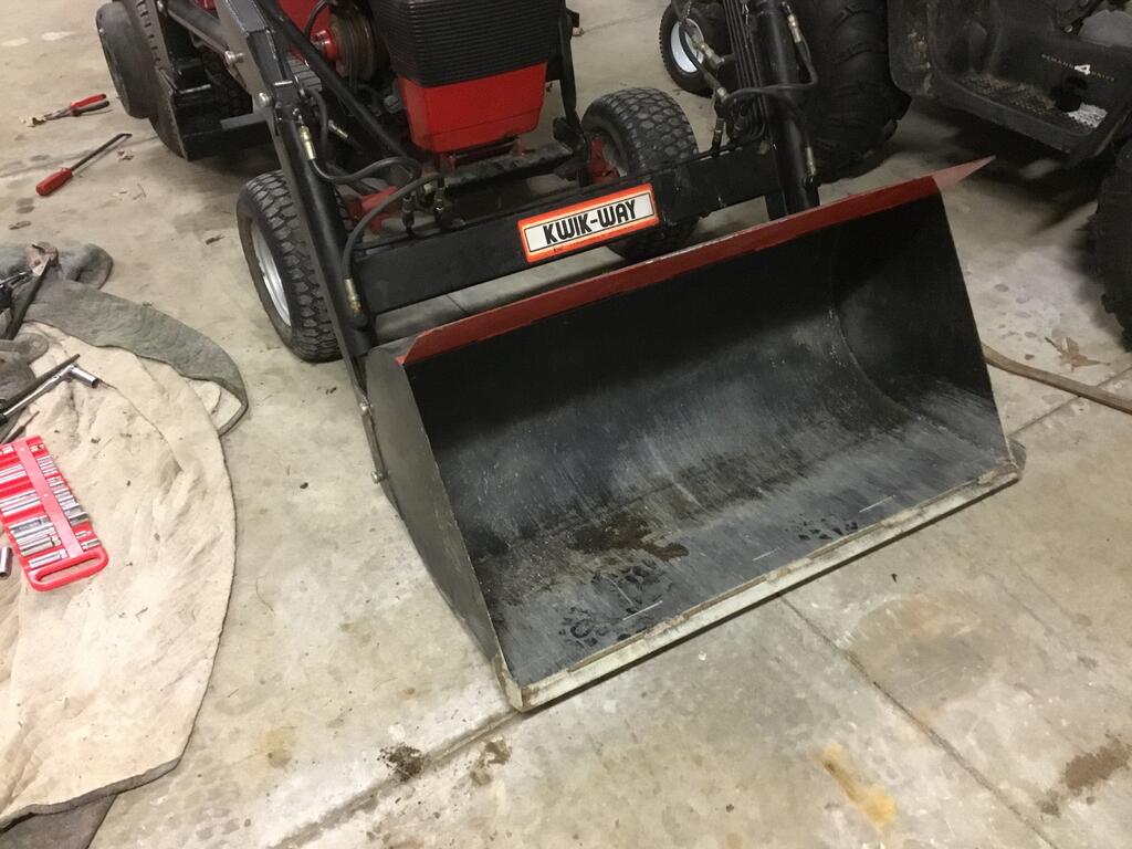

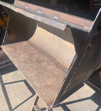

JoeM 10,317 #11 Posted November 1, 2023 Those Kwik-Way buckets are only 11ga. on the main structure. I worked on one last week. The owner was using slide on forks and it bowed the bottom a little more than an inch. Replaced the bottom with a 13 1/2 x 40 x 1/4" plate, reinforce the sides and add square tube to the top. It was much stronger and matches the strength of the loader much better now. Just be careful to not overload you bucket the rest of the system is stout and the bucket is a weak link. 1 1 Share this post Link to post Share on other sites
WHX?? 58,302 #12 Posted November 1, 2023 49 minutes ago, JoeM said: the bucket is a weak link. Agreed Joe ... guy has got to realize it's limitations. Sqounky's pic shows why a ball in bucket would be in the way. 2 Share this post Link to post Share on other sites

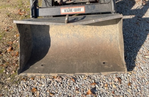

wallfish 20,658 #13 Posted November 1, 2023 18 hours ago, RJC1965 said: have some small shaft 2 inch balls I will see how small the hole would be. I mounted the ball to a Sq steel tube then used 2 3/8" holes and bolts to hold it on. Not a big hole for the ball stem. The extra steel supported it over a larger area and it never bent the bucket. That clamp should work but it extends the ball out further from the edge. I preferred it nice and tight for heavier things. 1 1 Share this post Link to post Share on other sites
