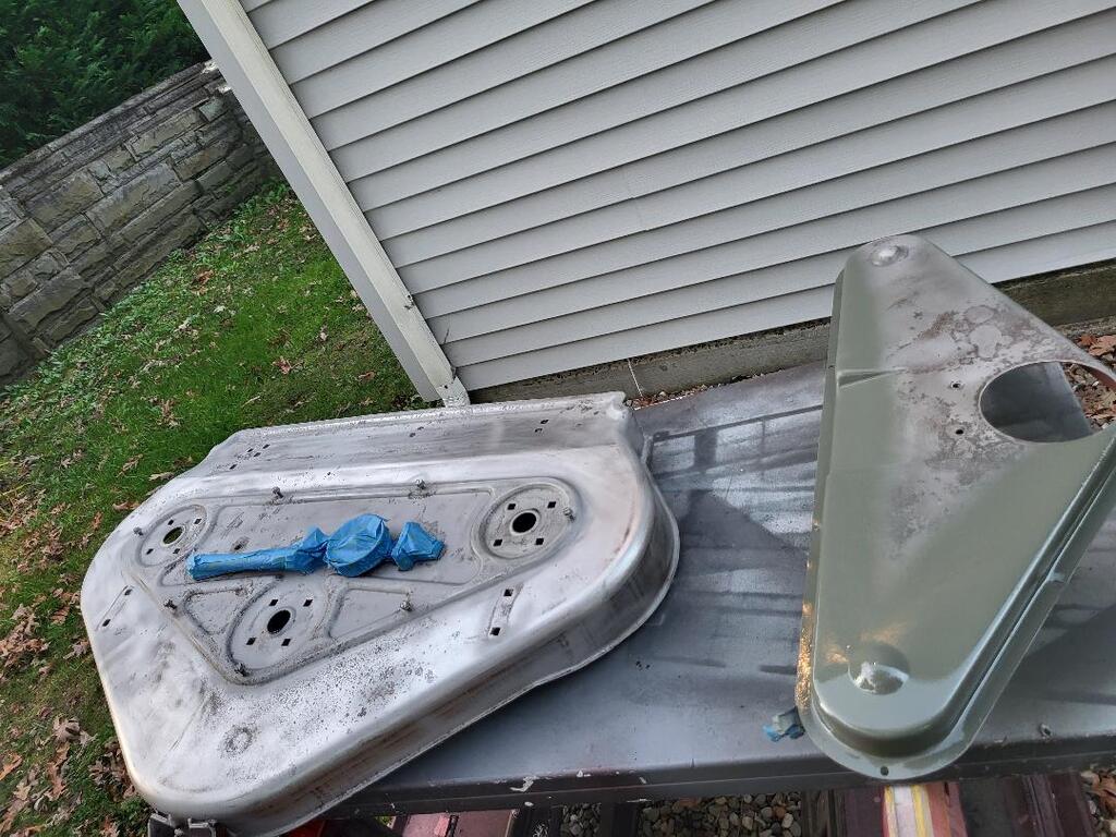

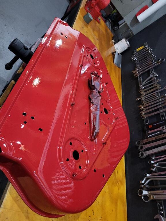

matt monte 232 #1 Posted October 29, 2023 I have a 1974 B80 i keep as a backup mower to my 312-8. b80 deck was rust free as u can see but had issues. Center pully bolt was broken and i suppose still ran and stripped out the pully/spindle shaft. Also one of the side pulleys was frozen as well as chunks of rubber missing from side wheels(how does that happen,?!) I have a very rusted but functioning 36in RD deck that was a spare to the 312-8 that i removed the attac o matic brackets and made to fit b80. I had some down time and decided to strip, media blast and paint original deck to b80. Came out rather well. Dont let pic fool you. Pic was taken 90 seconds after i sprayed it and moved it inside in an effort to avoid bugs landing in it. dried smooth and is a mile deep! Anyway... can i just swap spindles, pulleys ect from the newer style deck over to b80 deck? I see newer style has grease fittings to spindles, older ones do not. not sure of any other differences. would toss the rusty deck and free up some real estate in shed. the 312-8 has a 42 in SD that works well and is currently in use. Sorry in advance if this has been brought up before. Share this post Link to post Share on other sites
