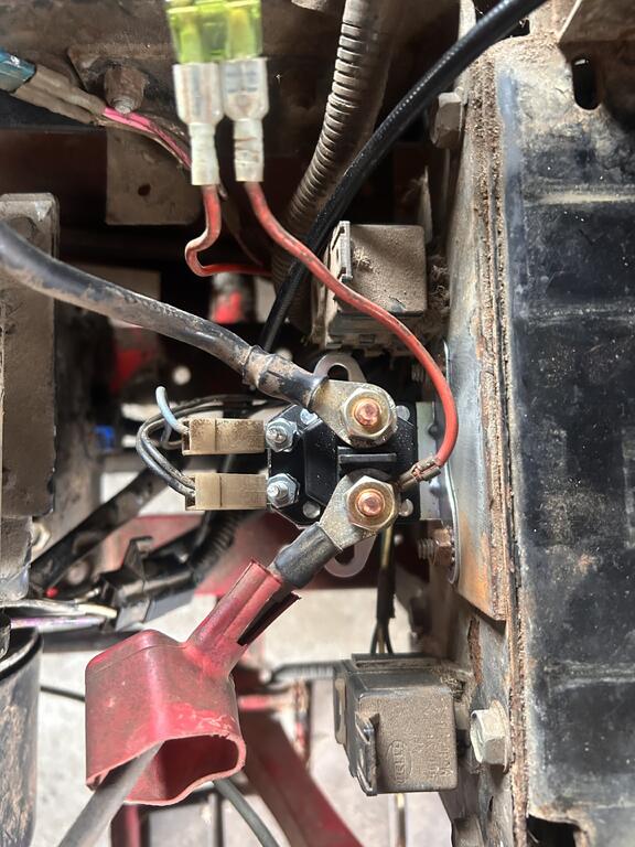

new to horses 1 #1 Posted October 28, 2023 I need assistance in knowing if this solenoid is hooked up right??? Also when I try to start it as shown the red wires with the fuse get hot, not crazy hot, I can still touch them. Is that normal? Share this post Link to post Share on other sites
Rick3478 469 #2 Posted October 28, 2023 Looks right. The little red wire carries all the current to everything but the starter, and also the charging current. I wouldn't expect it to get hot, though. Maybe something else wrong, like shorted rectifier/regulator, safety interlock, or even hour meter? Share this post Link to post Share on other sites
rmaynard 17,583 #3 Posted October 28, 2023 What year is the 312-8? I'm concerned about the heat. Share this post Link to post Share on other sites
new to horses 1 #4 Posted October 28, 2023 (edited) 2 minutes ago, rmaynard said: What year is the 312-8? I'm concerned about the heat. It’s what I believe to be a 1996 or 97… model number 73363. I should add it blew a 20 amp fuse… it should have a 25 amp fuse I know but I didn’t have one so I replaced it with a 30… Edited October 28, 2023 by new to horses Share this post Link to post Share on other sites

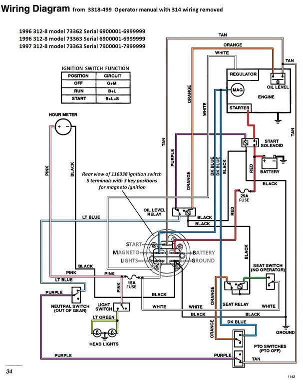

Rick3478 469 #7 Posted October 29, 2023 1 hour ago, new to horses said: Not to sound like an idiot but I’m at my limit with electrical… I’m terrible with it and have limited knowledge on what to do next. Need to figure out where all that current is going. I'd arm myself with a wiring diagram and a meter with a high current range. In the absence of meter, a 12V incandescent light bulb can serve as a current indicator. Substitute light bulb for the fuse and observe brightness. Start unplugging things, and if the bulb dims or goes out you know a bunch of current was going there. My money's on the rectifier/regulator, but you could have worn through the seat switch wire somewhere, and there are other possibilities. Found diagram elsewhere on the forum. 1 Share this post Link to post Share on other sites
