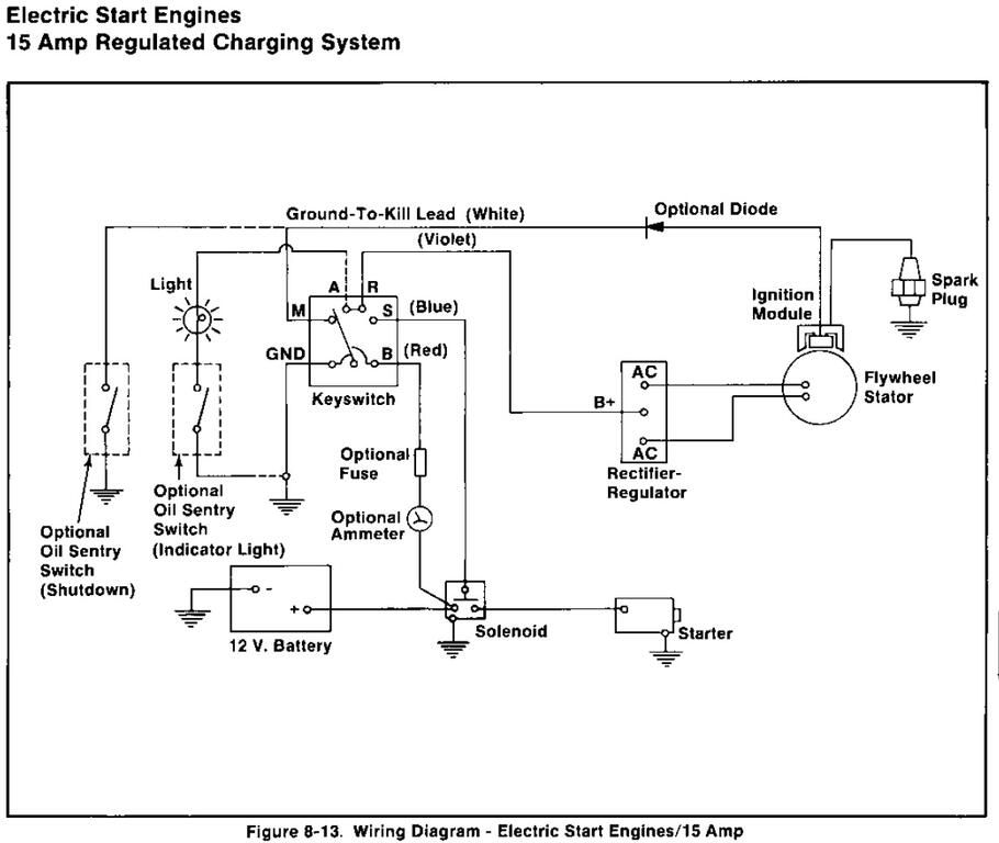

gwest_ca-(File Mod) 12,489 #5 Posted October 28, 2023 Common to use a diode in the ignition wire to prevent battery power from accidently reaching the ignition module which releases the magic smoke. Suspect the diode may have taken a hit and is now open. Easy to check with an ohmmeter. Illustration from the Kohler service manual. 2 1 Share this post Link to post Share on other sites
