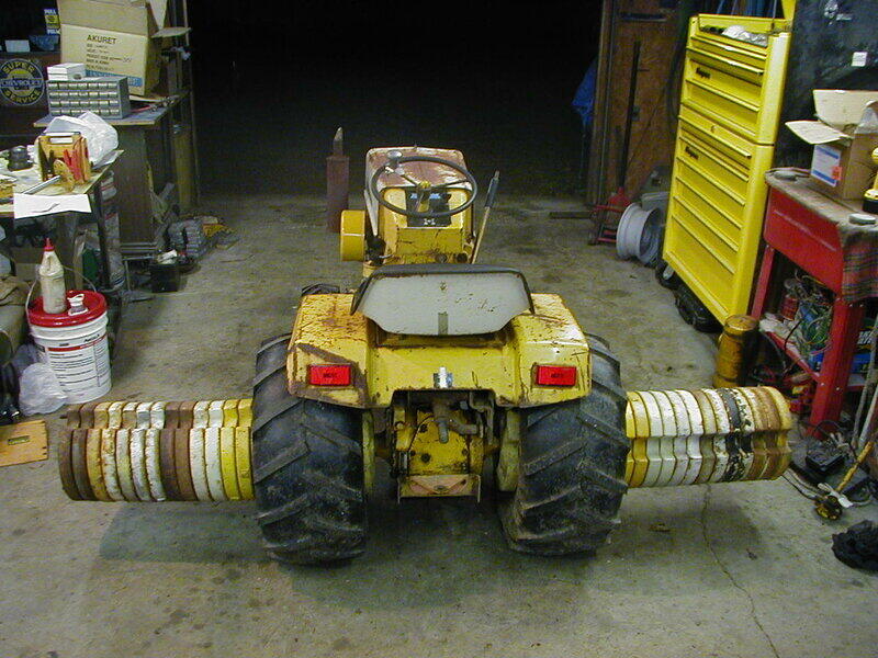

RJC1965 173 #26 Posted October 31, 2023 11 hours ago, Wild Bill 633 said: Wow one can not have to much weight that amazing. And quite a workout to load and unload Share this post Link to post Share on other sites

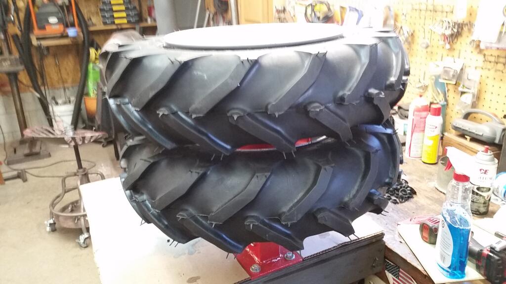

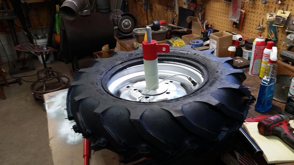

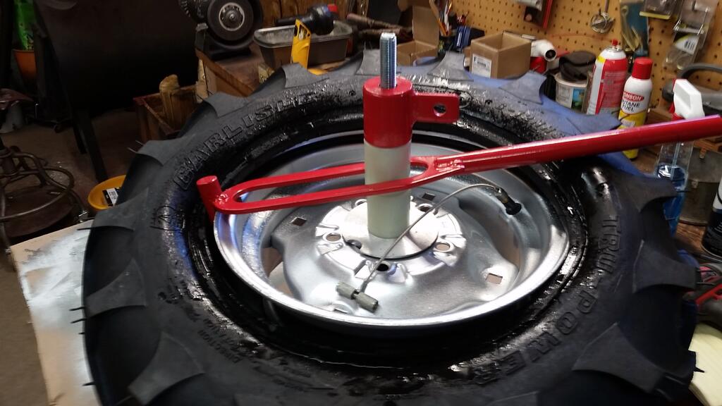

RJC1965 173 #28 Posted October 31, 2023 21 hours ago, WHX?? said: HF mini changer works for me on all tires up to 6 ply. Struggle yes but works. Spoons are a great help. No problems on 4 ply or less. Only 6-12s but still. V-61s are not hard to mount at all with this tool. I don't take them to a tire shop as it takes days and they bend me over. Best advice is get thet tire in the sun or warm and use lube. Thanks for all the information I am definitely getting the mini tire changer. Did you get the V-61 in 4 or 6 ply and are you saying you can mount the six ply just need lots of spoons and lube. Thanks Share this post Link to post Share on other sites
WHX?? 57,384 #29 Posted October 31, 2023 48 minutes ago, RJC1965 said: Thanks for all the information I am definitely getting the mini tire changer. Definitely one of the better tools I've bought. 49 minutes ago, RJC1965 said: Did you get the V-61 in 4 or 6 ply Don't remember will have to look. 4 ply I think. 51 minutes ago, RJC1965 said: are you saying you can mount the six ply just need lots of spoons and lube. Yes 6 plys need lots of lube but what really helps if they are in a warm sun or in front of the wood stove for a bit. Rubber is much more pliable. 1 Share this post Link to post Share on other sites
RJC1965 173 #30 Posted November 1, 2023 1 hour ago, WHX?? said: Definitely one of the better tools I've bought. Don't remember will have to look. 4 ply I think. Yes 6 plys need lots of lube but what really helps if they are in a warm sun or in front of the wood stove for a bit. Rubber is much more pliable. Thanks WHX I will getting the 6ply V-61 tires same size, inner tubes name brand like Firestone or Good Year, HF mini tire changer and also what looks like a tool to hold the inner tube fill valve in place. Apply some heat to warm up the tires with lots of lube to install. I will be keeping the stock rims as well no real advantage to spending extra on trailer hubs and rims. Will keep everyone updated on my progress. Appreciate everyone’s input Thanks 😊 1 Share this post Link to post Share on other sites
sjoemie himself 3,117 #31 Posted November 1, 2023 On 10/31/2023 at 11:47 AM, Wild Bill 633 said: Hoooly moooly! If you have'nt got traction now nothing can help you! 4 Share this post Link to post Share on other sites
