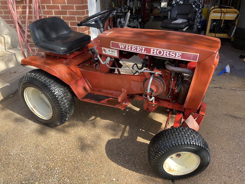

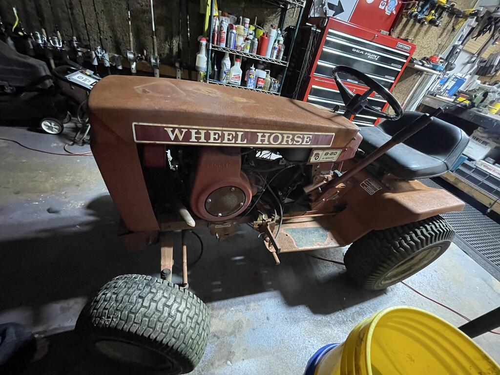

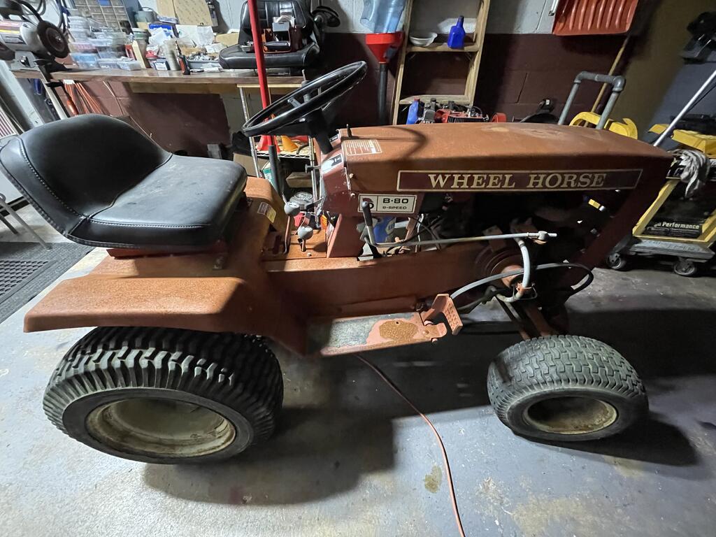

Wheelhorse#1 1,996 #1 Posted October 27, 2023 I told myself, hold off ! no more for now. The force was just too strong today. I just had to pick up this B-80 8 speeder. Non running and lots of patina -aka Rust ! What’s not to like ? First in line tomorrow morning is a good pressure washing then too see if this old girl will run. 1 14 Share this post Link to post Share on other sites

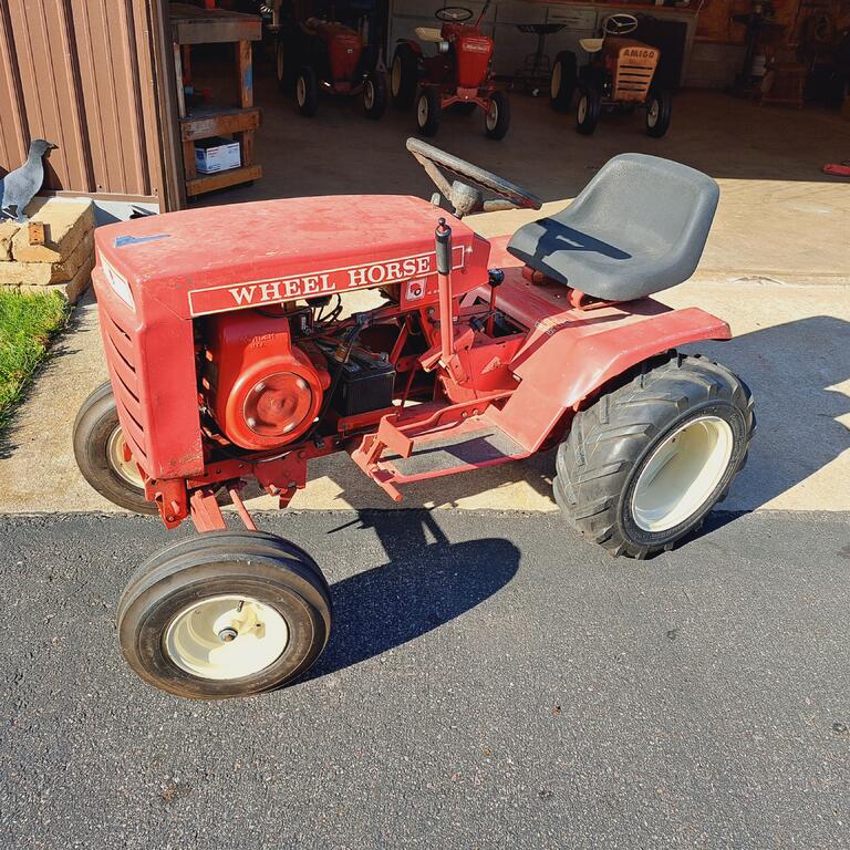

WHX?? 58,079 #13 Posted October 27, 2023 Any idea what year? I have a '73 which is a no name but since a front runner to a B I call her Aunt B. Just had to give it a home for only a franklin... 50 minutes ago, Wheelhorse#1 said: little power houses for their size. Yes Sir! 2 3 Share this post Link to post Share on other sites

Wheelhorse#1 1,996 #18 Posted October 27, 2023 10 hours ago, WHX?? said: Any idea what year? I have a '73 which is a no name but since a front runner to a B I call her Aunt B. Just had to give it a home for only a franklin... Yes Sir! The one above is ‘76. Yours Looks very nice and in great shape. Bigger rear tires make all the difference in my opinion.They Ride better and look cool .👍 2 Share this post Link to post Share on other sites

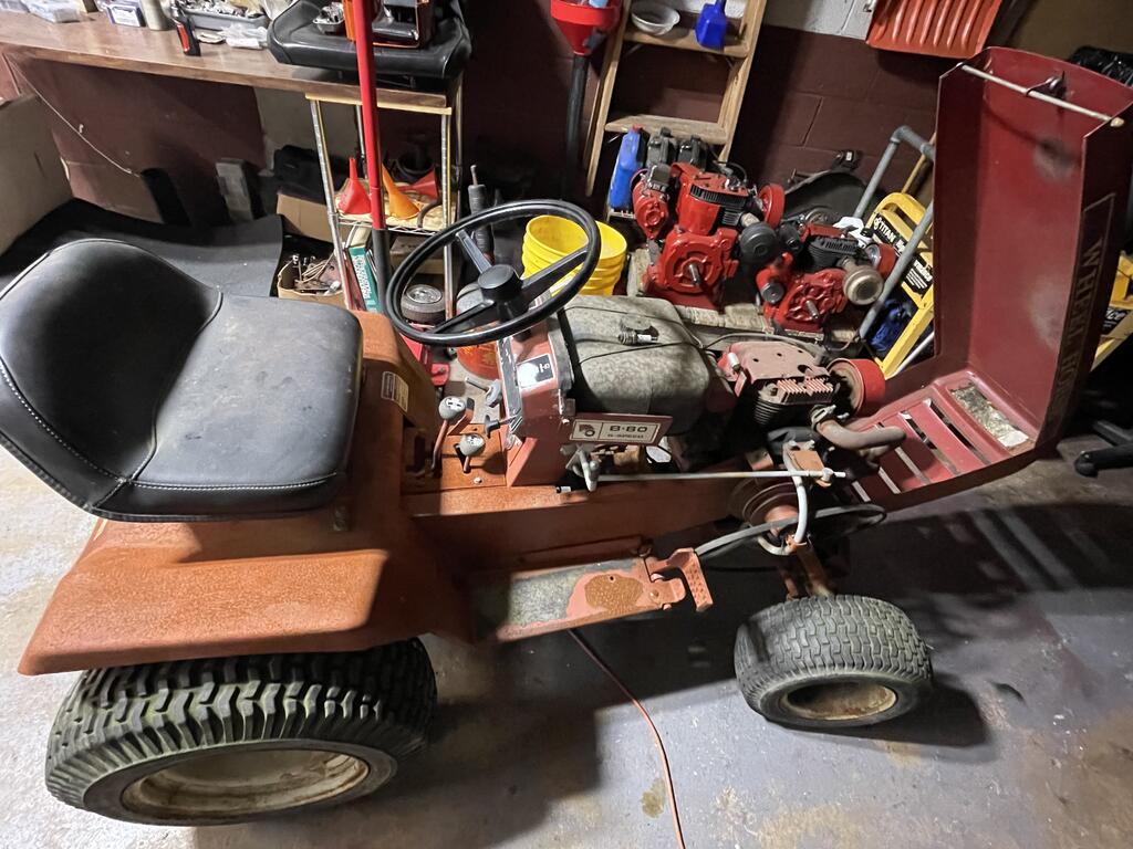

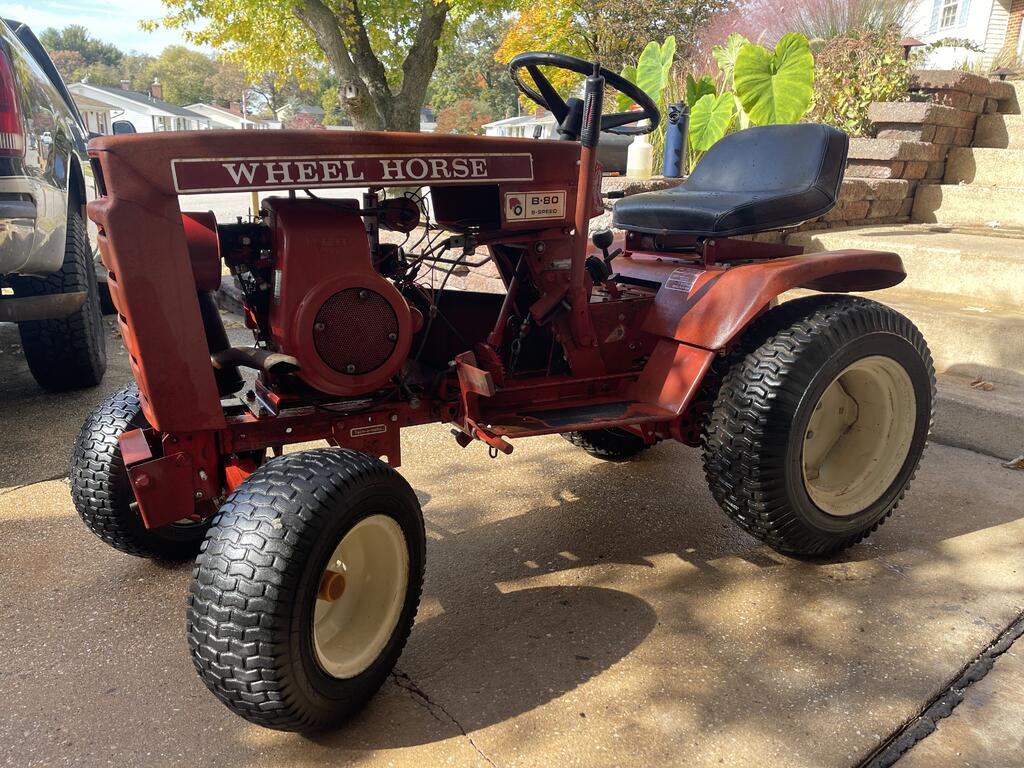

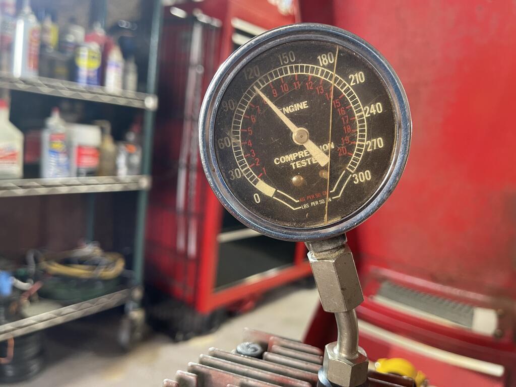

Wheelhorse#1 1,996 #20 Posted October 27, 2023 (edited) Today I gave it a good pressure wash.I think it cleaned up pretty well 👍 Brought it in and tore into it.Had no spark,cleaned up the points, issue solved. Replaced the head gasket,was blown out pretty bad but the cylinder looked great and no piston slop at all 😮 I think I may have gotten lucky on this one.It’s always a crap shoot with a non runner. I think the trans is ok but won’t know for sure until tomorrow once I get it running. Edited October 27, 2023 by Wheelhorse#1 7 2 Share this post Link to post Share on other sites
oliver2-44 11,735 #21 Posted October 28, 2023 That’s a great compression reading! I would think a 1976 k181 would have the compression release cam. So how did you get an engine compression reading? School me! 3 hours ago, Wheelhorse#1 said: 2 Share this post Link to post Share on other sites

WHX?? 58,079 #23 Posted October 28, 2023 On 10/27/2023 at 8:07 AM, Pullstart said: I shoulda’ took her for a stroll in the food plot, see how that 8 pulled a plow. Did anyone run her into the dirt yet? I did in the junior field but never got a chance in the big field. Plowed good but have a lift issue to sort out. 2 Share this post Link to post Share on other sites

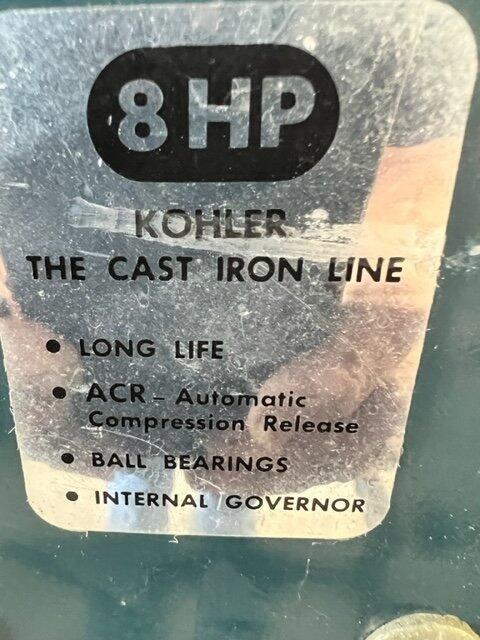

WHX?? 58,079 #24 Posted October 28, 2023 10 hours ago, oliver2-44 said: That’s a great compression reading! I would think a 1976 k181 would have the compression release cam. So how did you get an engine compression reading? School me! The newer small blocks did not have ACR with the ring gear bendix set up. 1 1 Share this post Link to post Share on other sites
oliver2-44 11,735 #25 Posted October 28, 2023 4 hours ago, WHX?? said: The newer small blocks did not have ACR with the ring gear bendix set up. I have a couple newer bendex ones that have ACR. I guess its just like balance gears, some had them, some didn't. 1 Share this post Link to post Share on other sites
