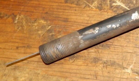

mpoore 26 #2 Posted October 26, 2023 I may have answered my own question about the dipstick tube. I found an ebay listing of a tube like mine. The photo shows that the end is threaded. Share this post Link to post Share on other sites
