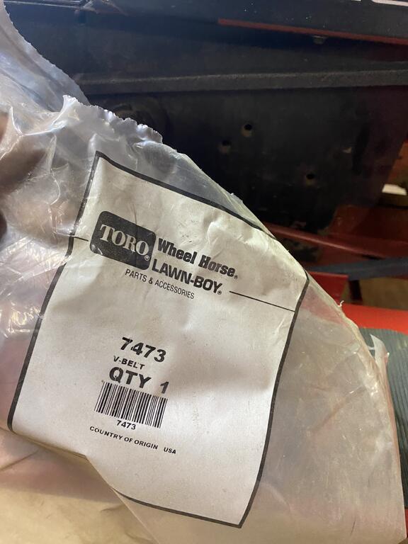

Phan 65 #1 Posted October 25, 2023 Anyone please advise me: 1) When I need to replace the engine belt of B-100 8 speeds, it seems the belt is quite loose when I depressed the clutch. 2) Yesterday, I took off the fender (I want to start the tractor for taking a clip of the engine belt) but the tractor did not crank or had any sound - what is the problem? I checked the PTO switch - every think look ok. I will have to check again this afternoon - if it is no raining. Share this post Link to post Share on other sites
Sparky-(Admin) 25,945 #2 Posted October 26, 2023 You need this belt (in the picture) if you decide to replace it. And there is a PTO safety, a clutch pedal safety switch and a seat switch (I suspect you disturbed the seat switch when removing the rear fender) that must be satisfied before the motor will crank. 1 Share this post Link to post Share on other sites
