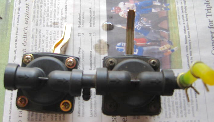

953 nut 64,114 #8 Posted October 24, 2023 2 hours ago, ebinmaine said: would a 12 (big block) pump swap to an 8 (small block)? The arm that operates the pump on a small block is offset to the right while the big block arm is straight. Photo courtesy of Paul @pfrederi . 1 Share this post Link to post Share on other sites

Handy Don 15,937 #10 Posted October 25, 2023 13 hours ago, 953 nut said: The arm that operates the pump on a small block is offset to the right while the big block arm is straight. Photo courtesy of Paul @pfrederi . Well, Mr. Quick-on-the-Draw you got there ahead of me. I found the different part numbers but hadn’t found the reason yet! Good job and thanks! 1 Share this post Link to post Share on other sites
