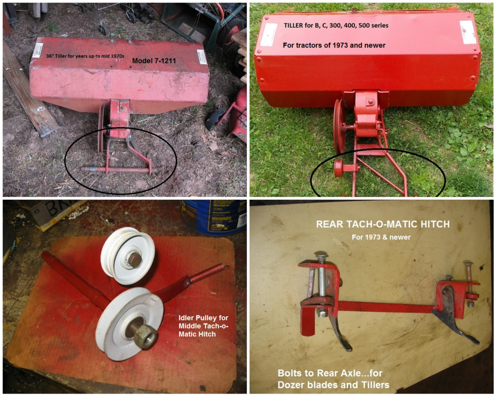

daveoman1966 3,884 #4 Posted October 24, 2023 The tiller model 7-1211 is for tractors of 1972 and earlier. The later years have a different hitch and idler pulley. Here is a pic 1 Share this post Link to post Share on other sites

daveoman1966 3,884 #6 Posted October 25, 2023 (edited) I found the Tiller you're looking at. The ONLY things in see in the pics that would mate to a 314-8 traftor are on pics # 5 and #6. The TOP red thing is the MULE DRIVE for a mower deck. The BOTTOM red thingy is the Mid-Mount IDLER PULLEY assy used for a 36" tiller, but not for the tiller that is shown (although it may work). That Idler Pulley assy would be for a tiller model 07-36TL01 thru 07-36TL05). I've no idea what the angle iron assy contraption is. IMHO...the seller must have a different style of hitch on the back of his 314-8 tractor to even attach the tiller.... I also see a SLOT HITCH.... which MAY be part of the connection apparatus. Edited October 25, 2023 by daveoman1966 Share this post Link to post Share on other sites
David414 323 #7 Posted October 25, 2023 14 hours ago, daveoman1966 said: I found the Tiller you're looking at. The ONLY things in see in the pics that would mate to a 314-8 traftor are on pics # 5 and #6. The TOP red thing is the MULE DRIVE for a mower deck. The BOTTOM red thingy is the Mid-Mount IDLER PULLEY assy used for a 36" tiller, but not for the tiller that is shown (although it may work). That Idler Pulley assy would be for a tiller model 07-36TL01 thru 07-36TL05). I've no idea what the angle iron assy contraption is. IMHO...the seller must have a different style of hitch on the back of his 314-8 tractor to even attach the tiller.... I also see a SLOT HITCH.... which MAY be part of the connection apparatus. 14 hours ago, daveoman1966 said: I found the Tiller you're looking at. The ONLY things in see in the pics that would mate to a 314-8 traftor are on pics # 5 and #6. The TOP red thing is the MULE DRIVE for a mower deck. The BOTTOM red thingy is the Mid-Mount IDLER PULLEY assy used for a 36" tiller, but not for the tiller that is shown (although it may work). That Idler Pulley assy would be for a tiller model 07-36TL01 thru 07-36TL05). I've no idea what the angle iron assy contraption is. IMHO...the seller must have a different style of hitch on the back of his 314-8 tractor to even attach the tiller.... I also see a SLOT HITCH.... which MAY be part of the connection apparatus. daveoman 1966 Thank you for checking the FB MKT Place listing. I don't understand how the PO connected this tiller either. Based on the mixture of parts, equipment years, and an unknown outcome, I will pass on this rototiller. Again, thank you very much for your help! Share this post Link to post Share on other sites
