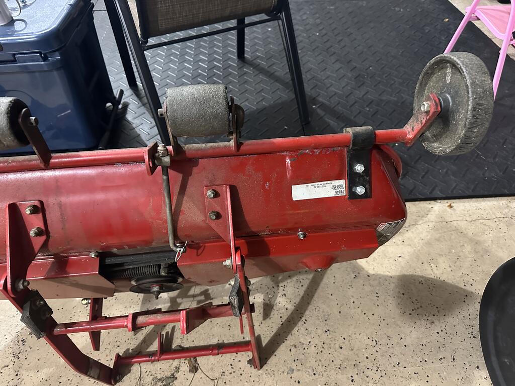

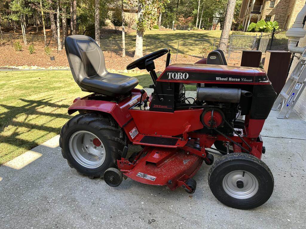

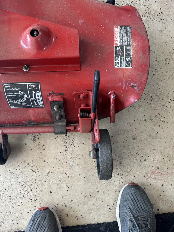

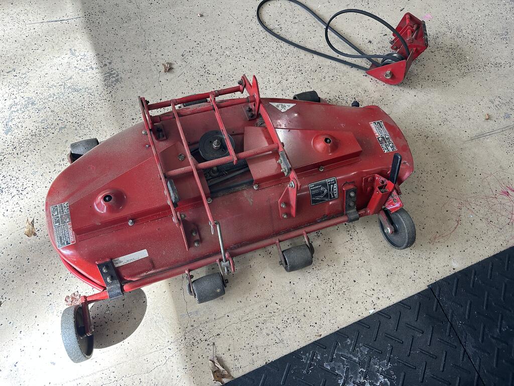

KVustrud 92 #2 Posted October 24, 2023 (edited) I’ll add a bit, I want to make this tractor perform flawlessly and last forever. If the 42” deck is worth time/effort to do so, I’ll keep it. If not, I’ll try to find a 48 or a 37 deck. I want a deck I can know is durable and will last. I’d prob be fine running a 48” deck with 12 HP also as I’m only cutting a very nice Bermuda lawn at around 2”. However, if I have 8” front wheels, can I even run a 37” deck? Here’s current deck/tractor setup. I had posted some about this in my other thread, but wanted to really focus on the deck here. Deck heigh adjustment bracket is bent, need ideas in fixing that as well if I keep this deck. Edited October 24, 2023 by KVustrud 3 1 Share this post Link to post Share on other sites

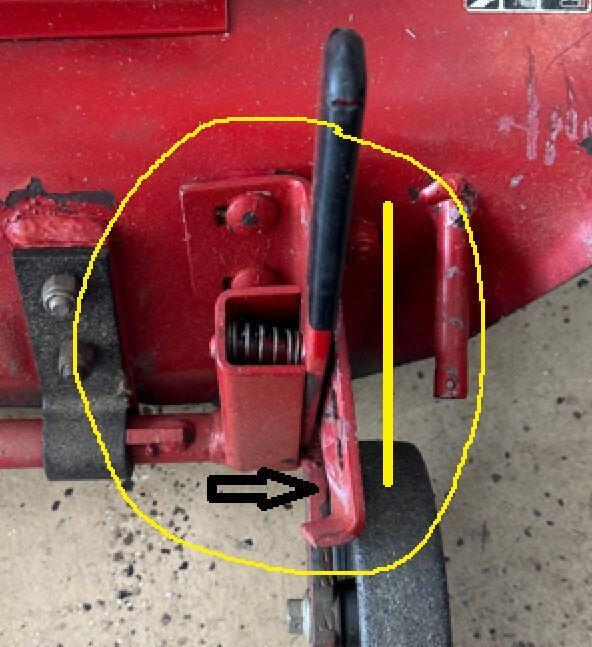

KVustrud 92 #3 Posted October 24, 2023 Level height adjustment bracket is bent… 1 Share this post Link to post Share on other sites

lynnmor 9,051 #5 Posted October 24, 2023 The 42" side discharge does have a reputation of being less durable but since you appear to be more careful than some I wouldn't worry about it. Keeping any mower deck cleaned of buildup on the bottom side will reduce the weakness caused by rust. If there is serious rust or cracks, then I would move on. The bent L shaped bracket on the adjuster is a simple job, just remove it and straighten it in a vise. There should be a pin attached to the lever inside the spring that goes thru the hole to the left. Adjust the L shaped bracket so that there is almost no gap. 2 Share this post Link to post Share on other sites

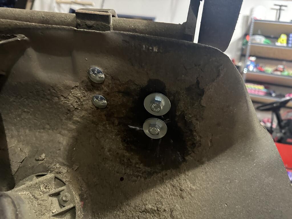

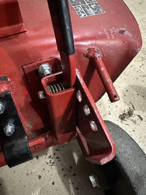

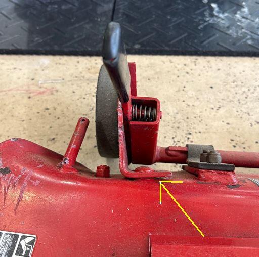

KVustrud 92 #10 Posted October 24, 2023 I did notice the reinforcement on the front.... However, I just went to remove the L-Bracket and noticed this. The L bracket itself is not bent, look at it from this angle. You can see that it is actually pulling on the bolts and "pulling" the shell of the deck out when the weight of the mower is on the rear wheels. This is what is allowing the l-bracket to bend outward. I looked closely at the shell condition and it really does seem to be in good shape. What's the best fix here? 1 Share this post Link to post Share on other sites
kpinnc 19,008 #11 Posted October 24, 2023 4 minutes ago, KVustrud said: What's the best fix here? Some later models had a 1/8 plate inside to reinforce that area. You can add a couple fender washers under the nuts on the underside and it should be fine. 2 Share this post Link to post Share on other sites
KVustrud 92 #12 Posted October 24, 2023 1 minute ago, kpinnc said: Some later models had a 1/8 plate inside to reinforce that area. You can add a couple fender washers under the nuts on the underside and it should be fine. That was my first thought, will do! I'll bend it back, remove it, and get some good sized washers under there. This all has me thinking, seems like the deck hardware is all pretty stout and the shell itself is the weak point. All of my spindles, levers, arms etc. etc. look almost new. I'm going to start mocking up a new fabricated shell out of carboard. I have a welder, and if I used this shell for the general dimensions I bet I could build a fabricated deck out of 1/8" steel for not a whole lot of money. I have a working deck now, so no real rush. But If I can get the shell close in size/shape along with the baffles on the underside it should cut well enough.....as long as the lifting points, and all other attachments mount up in the correct spots and everything it really wouldn't be that hard. Main thing would be getting the 3 spindles the exact distances apart so there's no uncut grass. This would be a fun project and I'd start a new thread of course. Primed and painted red, that'd be pretty sweet! You think a 1/8" fabricated shell would be thick enough to last forever? 1 Share this post Link to post Share on other sites
kpinnc 19,008 #13 Posted October 24, 2023 Just now, KVustrud said: This all has me thinking, seems like the deck hardware is all pretty stout and the shell itself is the weak point. Under normal use, it's plenty strong. Driving it into things while trying to mow up close to an object can occasionally bend something, but it takes a big hit to do it. Keep in mind that 1/8 steel is gonna be very heavy. Couple that with manual lift, and it might not be as good as you think. Nevermind removing and installing such a beast. I have two fabricated decks that are absolutely NO FUN when it's time to take them off or put them back due to the weight. The 42 is nice because it is strong but not too heavy. 2 Share this post Link to post Share on other sites

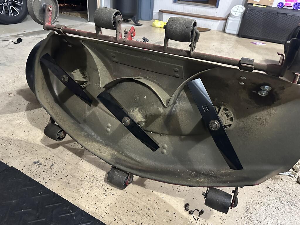

KVustrud 92 #19 Posted October 24, 2023 (edited) Alright, got some work done and buncha new hardware! Much better! Do the three blades need to be oriented in any specific way compared to each other? I was assuming with belt, slippage, a single blade hitting a thicker spot, etc. they’ll always kind of move around anyway. Edited October 25, 2023 by KVustrud 1 Share this post Link to post Share on other sites
Horse Newbie 7,405 #20 Posted October 25, 2023 (edited) 2 hours ago, KVustrud said: Do the three blades need to be oriented in any specific way compared to each other? Nope just put them on, (as long as you don’t have them upside down). These blades/ decks are not timed… looks like you’ve got it ! Edited October 25, 2023 by Horse Newbie 1 Share this post Link to post Share on other sites
KVustrud 92 #21 Posted October 25, 2023 Deck looks to be in excellent shape after getting a close look tonight! Share this post Link to post Share on other sites
lynnmor 9,051 #22 Posted October 25, 2023 10 hours ago, KVustrud said: Deck looks to be in excellent shape after getting a close look tonight! Now finish scraping the crud on the deck bottom and treat the surface with oil, I use Fluid Film since it doesn't run off and applies quickly. Yes, it will need to be applied after every use for maximum protection. Besides preventing deck rust, the oil will also protect the fasteners so that you have a chance of removing them when service is needed. 2 Share this post Link to post Share on other sites

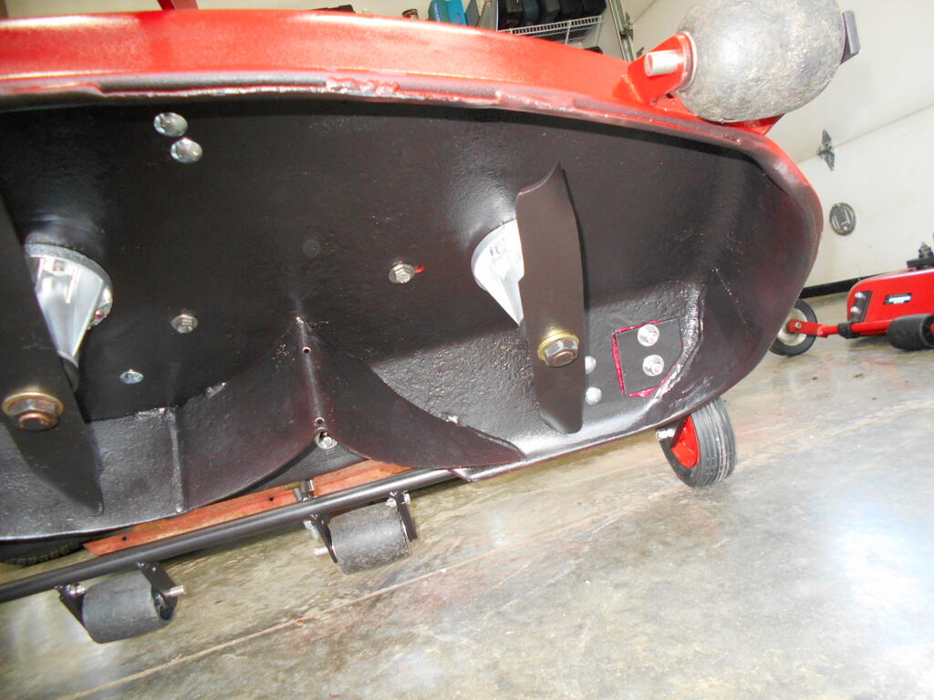

cleat 9,380 #23 Posted October 25, 2023 This picture is my 48" deck so height adjustment is on the opposite side but here is the plate I made up for it. The red you see is grease being squished out that I liberally applied between plate and deck. 2 2 Share this post Link to post Share on other sites
KVustrud 92 #24 Posted October 25, 2023 I thought about making a plate like that, the washers seem to stiffen it up nicely though! Took it for a spin this morning, grass is going dormant so kind of hard to tell but sure does cut nice! 3 1 Share this post Link to post Share on other sites
