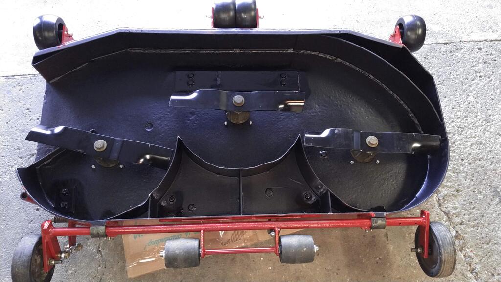

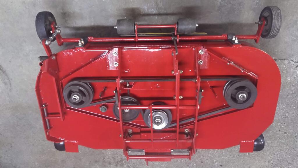

Bill D 3,168 #79 Posted November 2, 2023 If you're really handy you could adapt a commercial deck to fit your 312. I've done it and so has @kpinnc. It may be possible to fit a fabricated deck from another brand of riding mower such as a Cub or Husqvarna. I used a Bobcat deck, Kevin used an Exmark deck. 1 Share this post Link to post Share on other sites

Bill D 3,168 #82 Posted November 2, 2023 (edited) 3 hours ago, KVustrud said: Interesting! Have some pictures? I used a Bobcat deck, @kpinncused an Exmark deck. After doing this conversion I think the Exmark deck might be a better starting point. Using a deck like this will require use of a forward swept front end or 6" front wheels. There is a complete write up on it from '21 on here somewhere but I can't figure out how to attach it to this thread. Technology isn't my strong point. Edited November 2, 2023 by Bill D 2 Share this post Link to post Share on other sites
