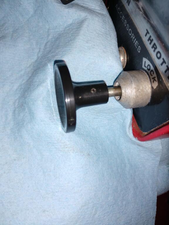

kpinnc 19,061 #8 Posted October 24, 2023 I would also suggest drilling and adding a small roll pin on the throttle cable handle as well. It makes the locking function last much longer. 2 1 Share this post Link to post Share on other sites
