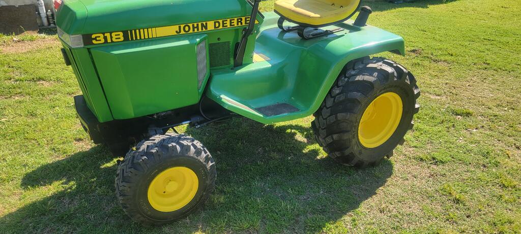

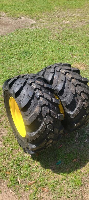

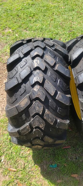

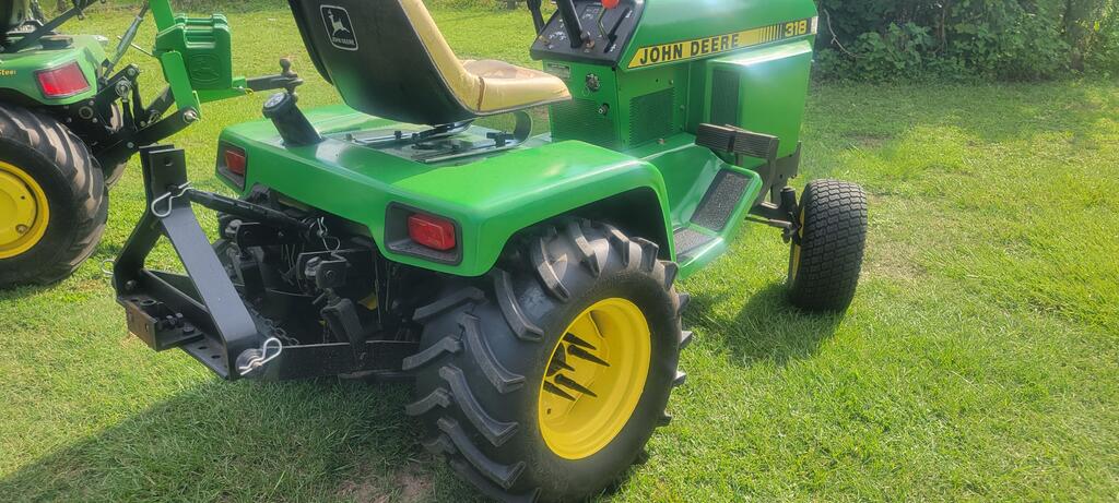

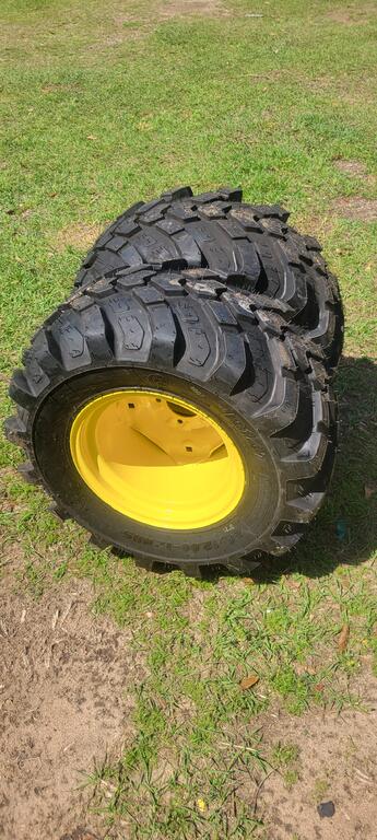

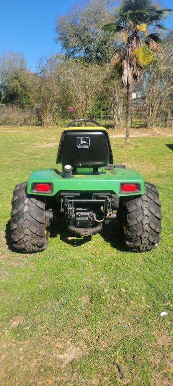

RED-Z06 2,720 #151 Posted March 16, 2025 Picked up this pair of Kenda 26x12x12 R14T tires for $240 shipped off Ebay, normal price $208ea. They are overstock so the company scuffs the brand name off the sidewalls, sells them cheap. Beaded up great on 8.5" wide wheels, a 9.5" or 10.5" would have been easier but im very happy with the tread shape. Going to fill them with ballast, and put them on my 318 that has a 54" blade on it. New fronts coming fedex today. 5 Share this post Link to post Share on other sites

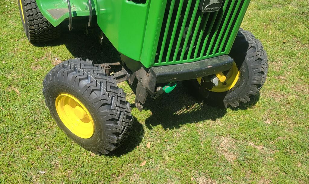

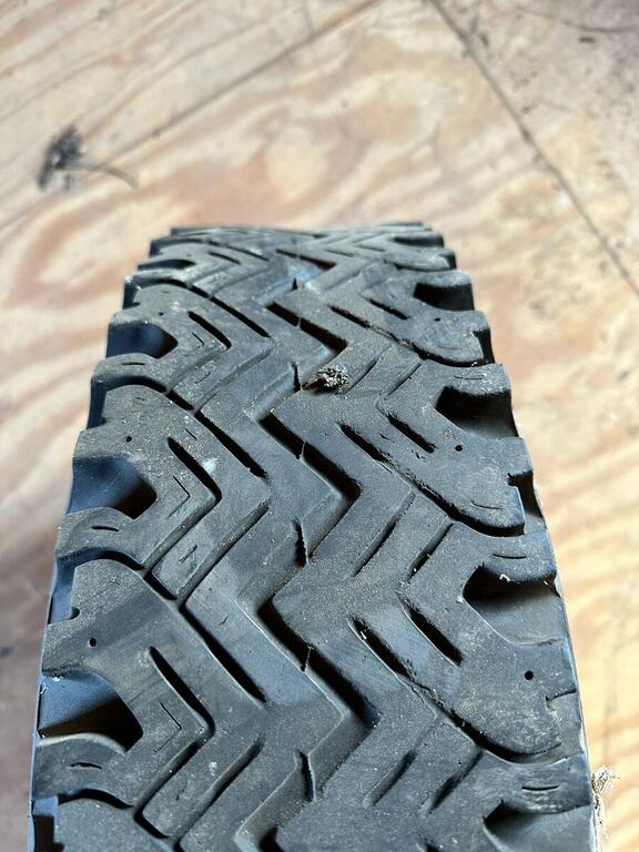

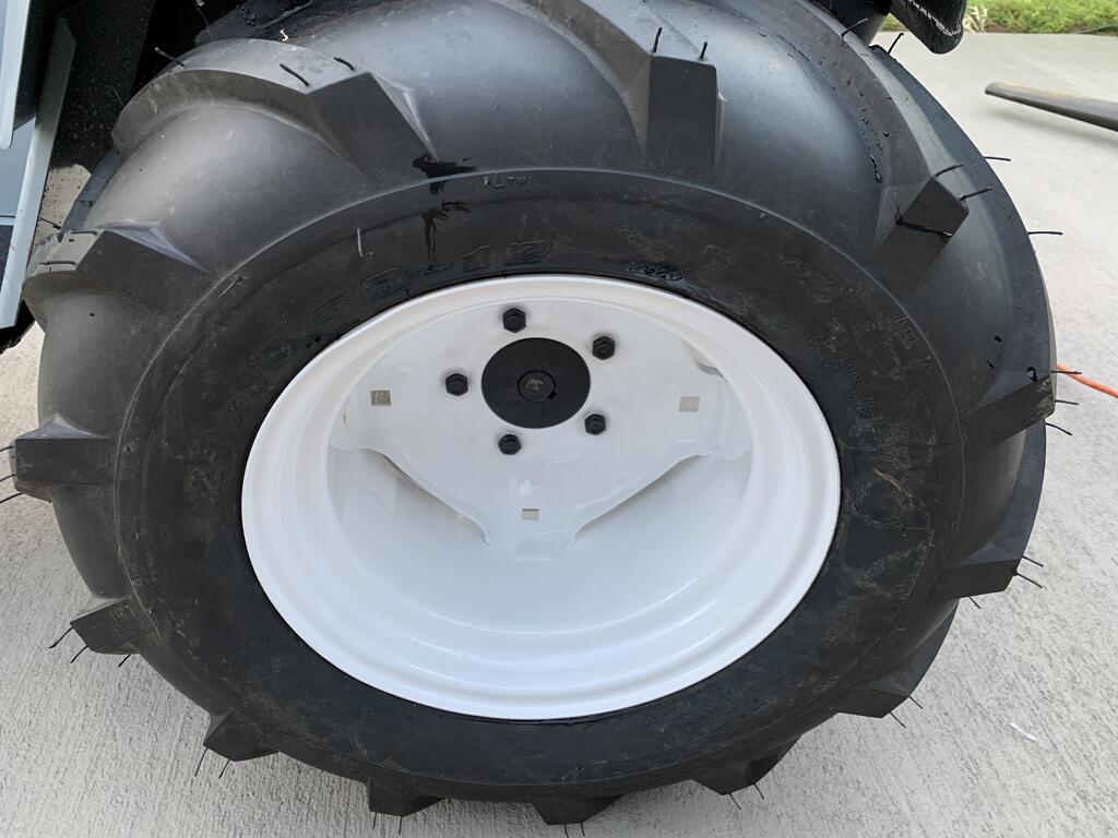

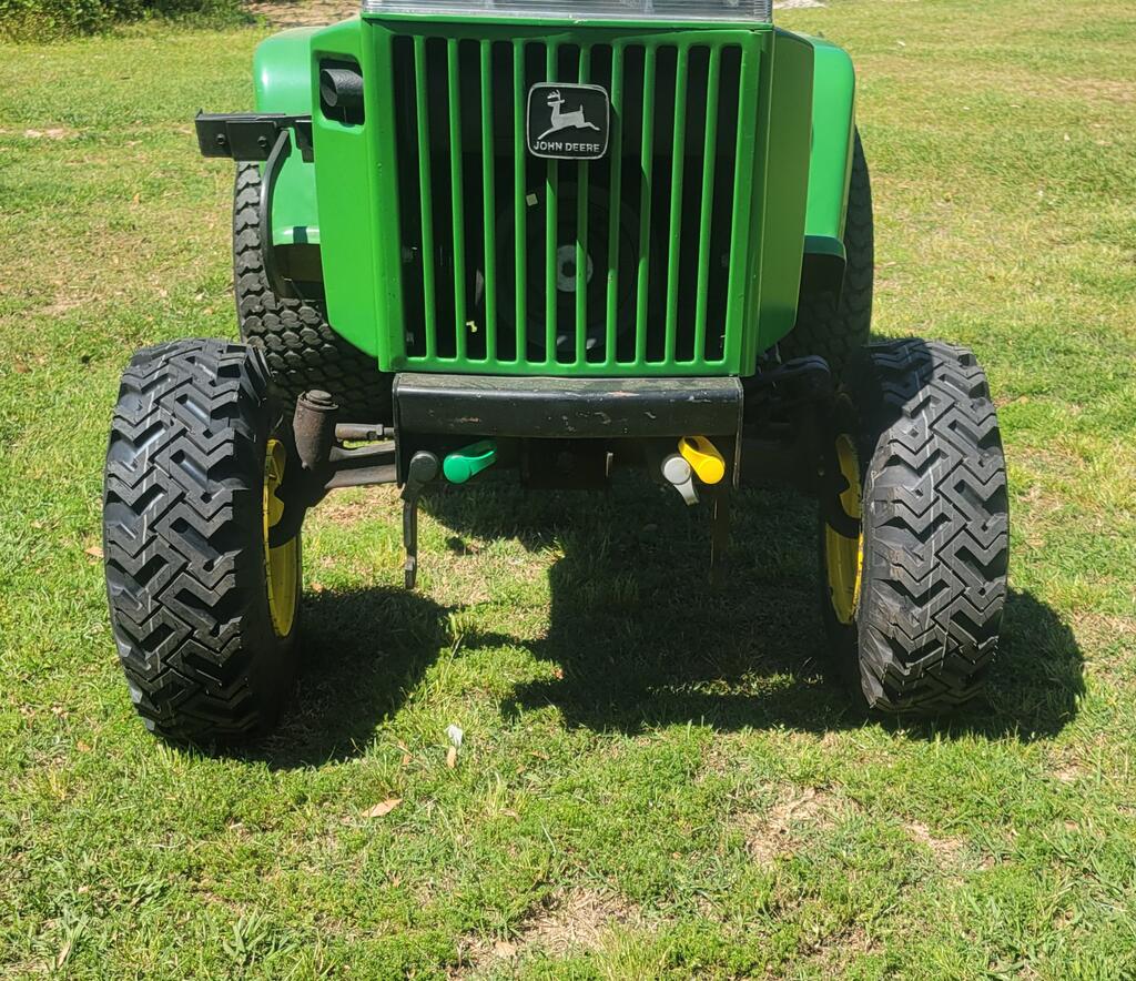

RED-Z06 2,720 #154 Posted March 20, 2025 (edited) Tried something different on a tractor, a Kenda K397 X-Grip 5.7-8. It rolls out to 18.5" high, right at 5.75" wide, stiff sidewall, great tread pattern. Edited March 20, 2025 by RED-Z06 2 Share this post Link to post Share on other sites
ebinmaine 81,278 #155 Posted March 20, 2025 2 minutes ago, RED-Z06 said: Kenda K397 X-Grip 5.7-8 Interesting. Looks like the old Town n Country. Decent smooth center. Good edge bite. Share this post Link to post Share on other sites
MainelyWheelhorse 3,208 #156 Posted March 20, 2025 1 hour ago, RED-Z06 said: Tried something different on a tractor, a Kenda K397 X-Grip 5.7-8. It rolls out to 18.5" high, right at 5.75" wide, stiff sidewall, great tread pattern. They kind of look like the tires that were on 70’s/80’s pickup/plow trucks back in the day. 1 Share this post Link to post Share on other sites

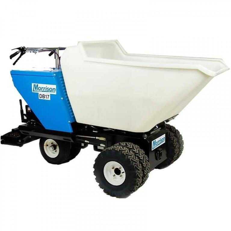

RED-Z06 2,720 #157 Posted March 20, 2025 (edited) 37 minutes ago, MainelyWheelhorse said: They kind of look like the tires that were on 70’s/80’s pickup/plow trucks back in the day. A few are similar, BFG Trailmakers are one, Goodyear Sure Grips also. Today these tires primary use is concrete buggys, Stump grinders, brush cutters Edited March 20, 2025 by RED-Z06 1 Share this post Link to post Share on other sites

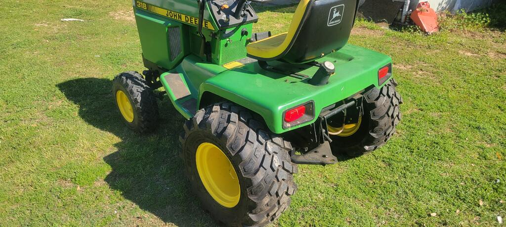

RED-Z06 2,720 #158 Posted March 20, 2025 This is everything installed. I wish my WHs could fit up this kind of rolling gear 3 1 Share this post Link to post Share on other sites

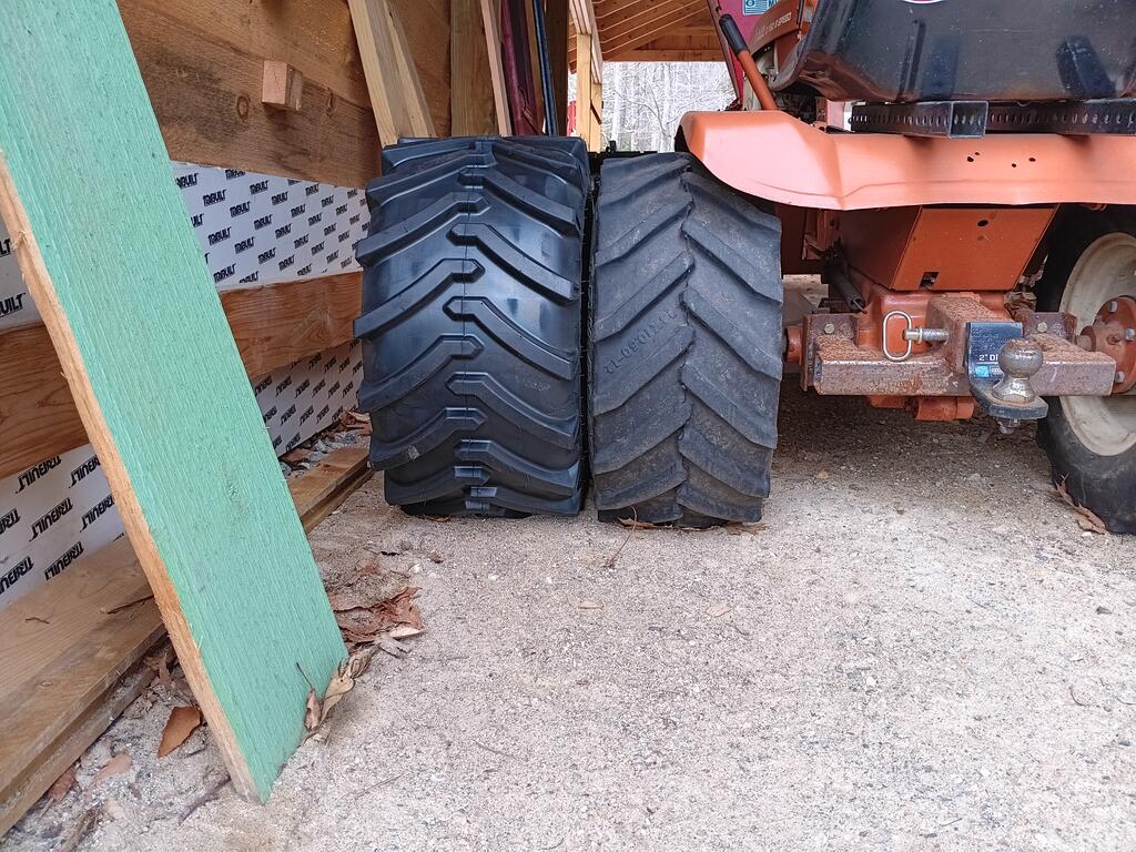

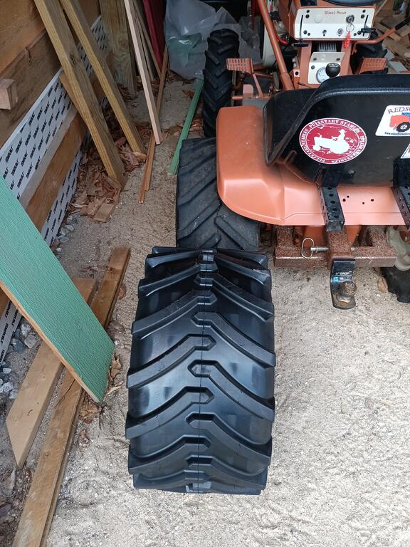

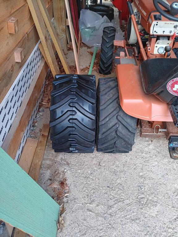

ebinmaine 81,278 #160 Posted April 14, 2025 I decided to order a set of 24 x 12 x 12 OTR Lawn Trac. This is in comparison to the Carlisle Tru Power 23 x 10.50 x 12 on the tractor. This last viewpoint is a little skewed for angle but really shows the size difference. @FLtractor 2 2 Share this post Link to post Share on other sites

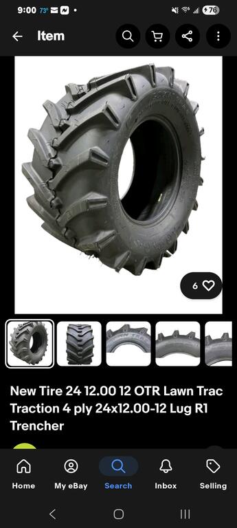

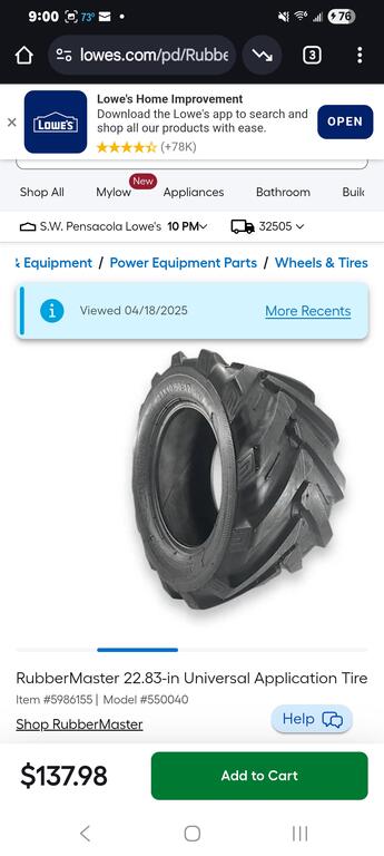

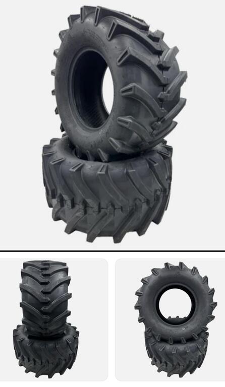

RED-Z06 2,720 #163 Posted May 22, 2025 Time for tires on my other 318, i want to use the deck on it so im not able to stuff 26s under it, but a 24 and 23 should fit fine. Looking at some options, it has a 3pt so turfs are out to a degree. 811T9wLyrrL._AC_UF1000,1000_QL80_FMwebp_.webp Share this post Link to post Share on other sites

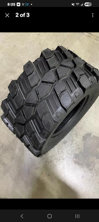

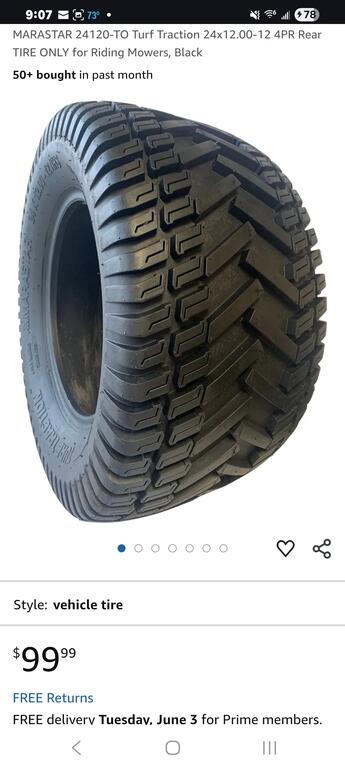

RED-Z06 2,720 #164 Posted May 22, 2025 These are also not bad looking as a hybrid tire Share this post Link to post Share on other sites
ebinmaine 81,278 #165 Posted May 22, 2025 3 hours ago, RED-Z06 said: These are also not bad looking as a hybrid tire 3 hours ago, RED-Z06 said: has a 3pt so turfs are out to a degree In the realm of practical application: Hybrid = Turf. They have none of the real world benefits of the AG bar. Share this post Link to post Share on other sites

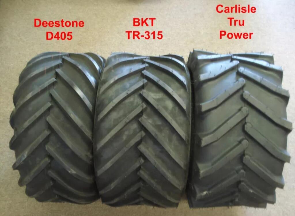

RED-Z06 2,720 #166 Posted May 22, 2025 10 hours ago, ebinmaine said: In the realm of practical application: Hybrid = Turf. They have none of the real world benefits of the AG bar. I dont disagree, they might provide marginally more tractive force than pure turf but they will fall short of a full bar...hybrids usually dont so 1 thing well they just do 2 things poorly. Tru Powers are also an option 1 Share this post Link to post Share on other sites
ebinmaine 81,278 #167 Posted May 22, 2025 6 minutes ago, RED-Z06 said: I dont disagree, they might provide marginally more tractive force than pure turf but they will fall short of a full bar...hybrids usually dont so 1 thing well they just do 2 things poorly. Tru Powers are also an option IMHO Carlisle Tru Power is a GREAT option. I use them both at work and at home and I recommend them often. You go back a few posts and you'll see I just bought some OTR Lawn Trac 24x12.00-12. So far, pretty impressed. Obviously I cannot speak for longevity like I can with the Carlisle. Share this post Link to post Share on other sites

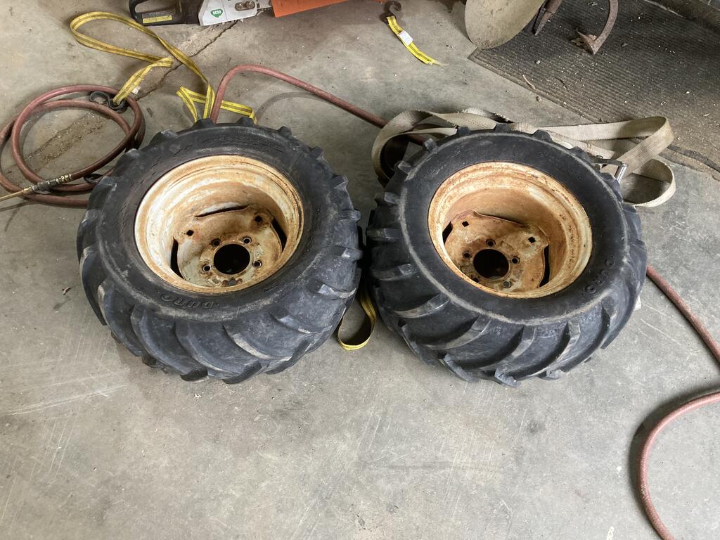

MainelyWheelhorse 3,208 #168 Posted May 22, 2025 So far I like the Duro 23X10.50x12 AG tires I got from @ebinmaine They grip well and don’t seem to rip up the lawn much if at all. 1 Share this post Link to post Share on other sites
Handy Don 17,735 #169 Posted May 22, 2025 4 minutes ago, MainelyWheelhorse said: They grip well and don’t seem to rip up the lawn much if at all. If your lawn is soggy, the bars will compress the soil a bit--if that is of any concern to you. 1 Share this post Link to post Share on other sites
MainelyWheelhorse 3,208 #170 Posted May 22, 2025 3 hours ago, Handy Don said: If your lawn is soggy, the bars will compress the soil a bit--if that is of any concern to you. @Handy Don Thanks for the heads up on that, but I’m not too worried about it. If it’s that soggy I’d just stay off it and let it dry out anyway. 2 Share this post Link to post Share on other sites
RED-Z06 2,720 #171 Posted May 27, 2025 I ordered the RubberMaster 23x10.50-12 i posted above, trying to send them back...not even 21" tall.. 1 Share this post Link to post Share on other sites
Horse Newbie 7,405 #172 Posted May 27, 2025 I like the Hi-Run’s… 2 1 Share this post Link to post Share on other sites
ebinmaine 81,278 #173 Posted May 27, 2025 2 hours ago, RED-Z06 said: I ordered the RubberMaster 23x10.50-12 i posted above, trying to send them back...not even 21" tall.. That's terrible 😕 2 Share this post Link to post Share on other sites
RED-Z06 2,720 #174 Posted May 27, 2025 6 minutes ago, ebinmaine said: That's terrible 😕 I mean i get it...some brands run small, some large, some dead on. But..these tires are tiny. And right at 10.3" wide so thats great..just short 2 Share this post Link to post Share on other sites

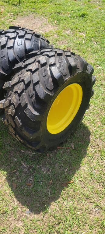

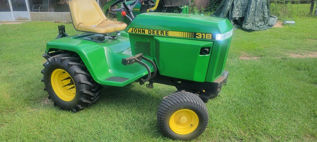

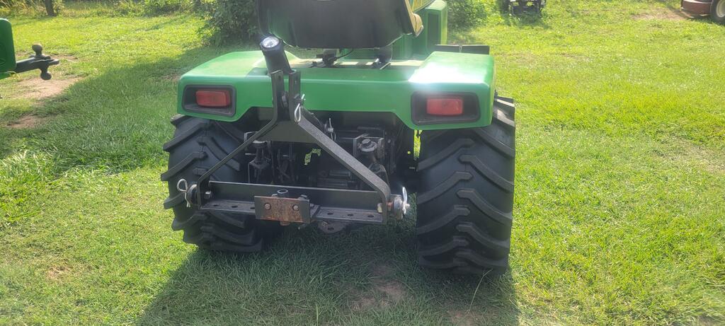

RED-Z06 2,720 #175 Posted June 8, 2025 Sent the Rubbermasters back, ordered the 24x12x12 OTR HBR tires. This is how they fit up on 12x8.5 wheels. Both are loaded 75%. Also finally had a chance to use my custom lug bolts. 1 Share this post Link to post Share on other sites
