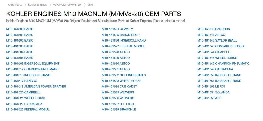

CCW 1,456 #1 Posted October 21, 2023 I have an opportunity to purchase a Kohler M10s 461550. Looking through the manuals section I found "1993 310-8 model 73320 - Using M10S-461545". Can I assume the M10s 461550 is newer and it should replace my 35 year old M12 that is now burning quite a bit of oil. 1 Share this post Link to post Share on other sites

pfrederi 19,301 #4 Posted October 21, 2023 461550 was produced for Ingersoll Rand Share this post Link to post Share on other sites
953 nut 63,200 #5 Posted October 21, 2023 Not necessarily, the spec number will tell you what was used on that engine to meet the customer needs. The crank shaft may be longer or shorter or may have a smaller diameter. The engine may not have a thrust bearing for the PTO. Or it could just be a different color of paint, You need to find out what the differences are. 1 Share this post Link to post Share on other sites

pfrederi 19,301 #13 Posted October 21, 2023 Kohler parts shows same crankshaft kit number for both engines. 47 142 02. All magnum singles have ball bearing so the PTO end thrust is not an issue 3 Share this post Link to post Share on other sites
