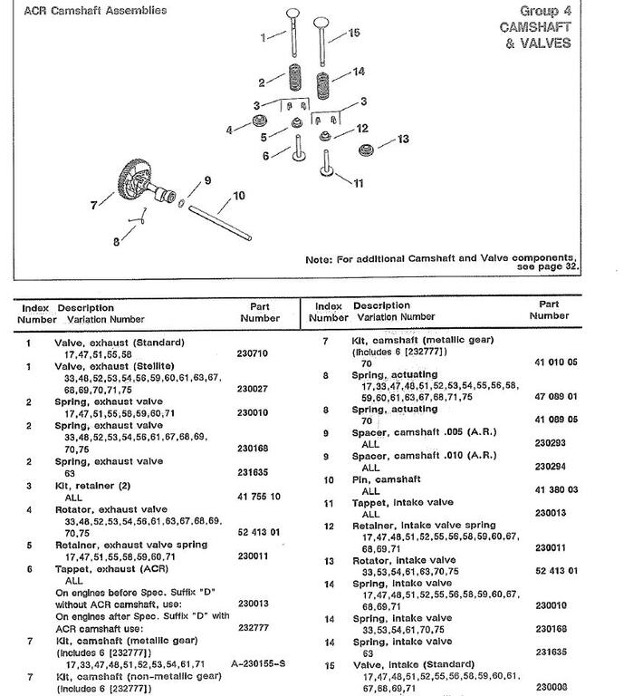

tunahead72 2,635 #3 Posted October 20, 2023 @Retired Wrencher Are you looking at the parts manual for these numbers? Just looking at my copy, there's three springs listed, depends on the engine's spec number -- what's the spec number on yours? 230010 230168 231635 Amazon has the 230010 spring, but not the others. I'd check with K&B like Jim suggested, just because they're one of our vendors here. Share this post Link to post Share on other sites

squonk 47,419 #5 Posted October 20, 2023 (edited) Springs should be #230010 For WH spec 30108 A or D Variation # 51 Edited October 20, 2023 by squonk 1 Share this post Link to post Share on other sites

Retired Wrencher 6,793 #7 Posted October 20, 2023 20 minutes ago, squonk said: Springs should be #230010 For WH spec 30108 A or D Variation # 51 Mike there is a tall spring that fits that engine 010# is the intake. But again this a Kohler dealer manual from the 50`s and 60`s. Share this post Link to post Share on other sites

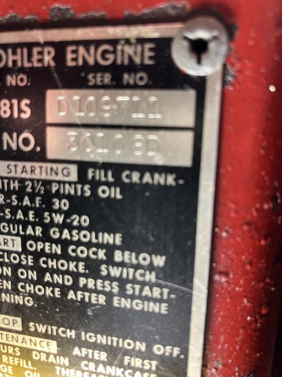

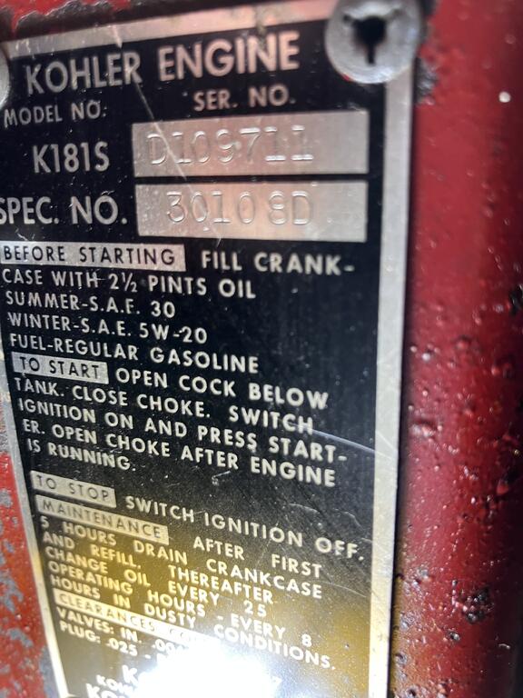

Retired Wrencher 6,793 #10 Posted October 20, 2023 2 hours ago, pfrederi said: Three springs depending on spec number used for both IN and EX . My spec# is#0108d Share this post Link to post Share on other sites
Retired Wrencher 6,793 #11 Posted October 20, 2023 25 minutes ago, squonk said: Every WH spec K181 I've run across is the 30108 which uses the 230010 Mike look below. Share this post Link to post Share on other sites
Retired Wrencher 6,793 #12 Posted October 20, 2023 25 minutes ago, squonk said: Every WH spec K181 I've run across is the 30108 which uses the 230010 So what spring do you think it would take 010 or the168? Share this post Link to post Share on other sites

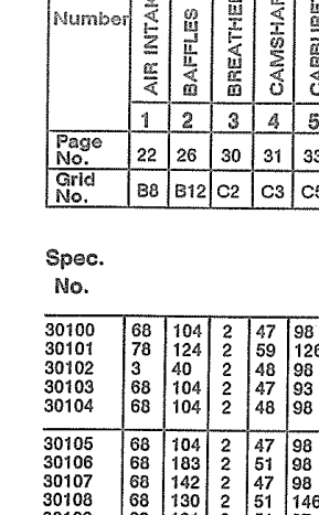

squonk 47,419 #13 Posted October 20, 2023 7 minutes ago, Retired Wrencher said: So what spring do you think it would take 010 or the168? 30108 is variation 51 which is the 230010 Share this post Link to post Share on other sites
gwest_ca-(File Mod) 12,367 #14 Posted October 21, 2023 We have a specific manual for the 30108 1 Share this post Link to post Share on other sites
Retired Wrencher 6,793 #15 Posted October 21, 2023 7 hours ago, gwest_ca said: We have a specific manual for the 30108 Thanks Garry. Great info I have never seen before. Share this post Link to post Share on other sites
