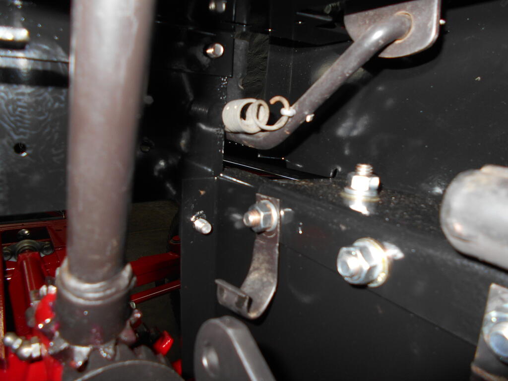

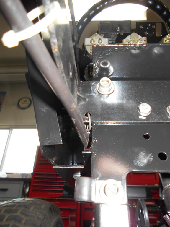

ebinmaine 81,035 #153 Posted November 26, 2023 Could someone with an early 80s tractor show me EXACTLY what this is all about? I see the area in question. I understand the bolt movement. (That doesn't matter here because there's no PTO switch.) My issue is the PTO spring. It keeps coming out of the little hole where I think it belongs. Share this post Link to post Share on other sites
Moparfanforever 940 #154 Posted November 26, 2023 There should be a cotter pin in the pto handle and the one end of the spring goes into the open part of the cotter pin. Can't remember without looking where the other end of the spring goes without looking, of course. Is that the part you need to know about?? 2 Share this post Link to post Share on other sites
cleat 9,401 #155 Posted November 26, 2023 There is a cotter pin in the PTO rod not far from the handle end. Other and of spring hooks into bottom of L shaped bracket that is used to hold belt cover on. 3 Share this post Link to post Share on other sites
ebinmaine 81,035 #156 Posted November 26, 2023 19 minutes ago, Moparfanforever said: There should be a cotter pin in the pto handle and the one end of the spring goes into the open part of the cotter pin. Can't remember without looking where the other end of the spring goes without looking, of course. Is that the part you need to know about?? 13 minutes ago, cleat said: Other and of spring hooks into bottom of L shaped bracket that is used to hold belt cover on. Thanks guys. The cotter pin end is good. I've got the spring in the same hole as the above pic but it may be too long. The spring has come out of that end and settled BESIDE the hole twice now. 1 Share this post Link to post Share on other sites
cleat 9,401 #157 Posted November 26, 2023 Your spring must be too long. Mine stays tight all the time. 2 Share this post Link to post Share on other sites

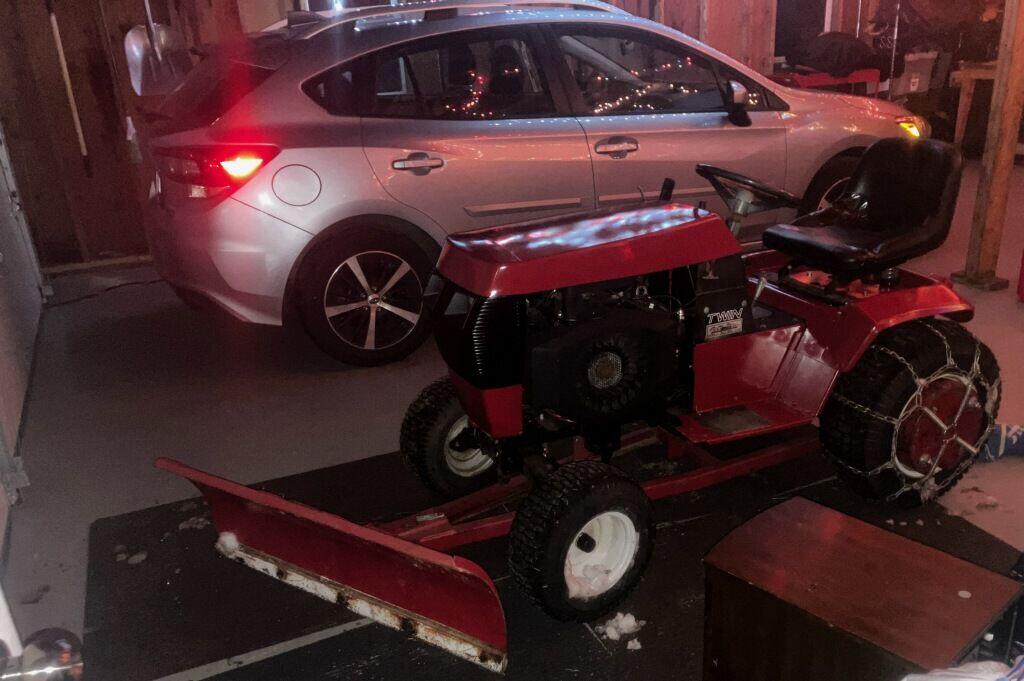

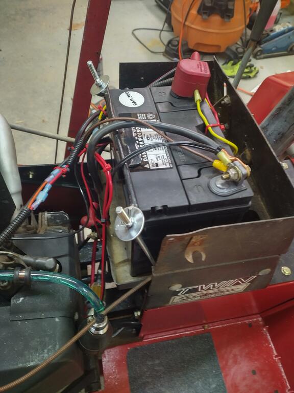

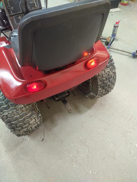

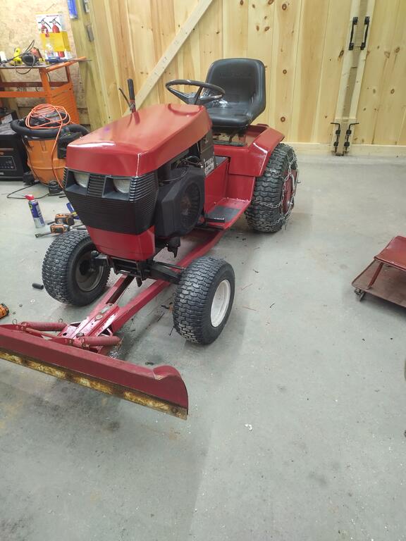

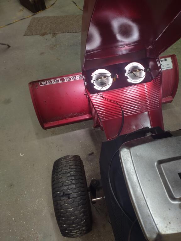

ebinmaine 81,035 #162 Posted December 2, 2023 Well the wiring harness was bugging me some. There was a couple terminals that were looser than I'd like. There was a couple wires that my very particular mind couldn't leave. I also had Trina pick up a new 300cca battery and the terminals were reversed. So I pulled a few things out. I put a few things back. Swapped a few things around. The only cable I needed to replace was the main ground from battery to chassis. I'd already made a ground jumper from chassis to engine. Took a few hours but I'm a LOT happier about the wiring now. I also got all the lights wired directly to the battery. I figure the LED lights won't be likely to drain the battery because they'll be using the tractor for long enough to recharge every time. We got the plow and frame all on. We'll be delivering the tractor tomorrow!! In the morning we'll try to get the frame of the cab in place. It's an older cab for a 1979 narrower hood with a single cylinder engine. This means the front lower portion below the windshield can't be used because of the exhaust exit location. It'll certainly be good for protection the rest of the area though. 4 Share this post Link to post Share on other sites

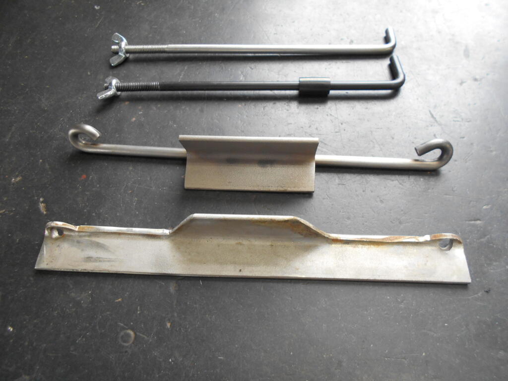

Brockport Bill 2,491 #170 Posted December 7, 2023 it's just a minor item.. but I love the battery cross bar hold down application -- gotta do that on mine - another amazing little insight tip we all get here from RSq. members 3 Share this post Link to post Share on other sites
ebinmaine 81,035 #171 Posted December 7, 2023 32 minutes ago, Brockport Bill said: it's just a minor item.. but I love the battery cross bar hold down application -- gotta do that on mine - another amazing little insight tip we all get here from RSq. members We can't take credit for that one. It's similar to some stock Wheelhorse setups I've seen but MUCH beefier. 1 Share this post Link to post Share on other sites

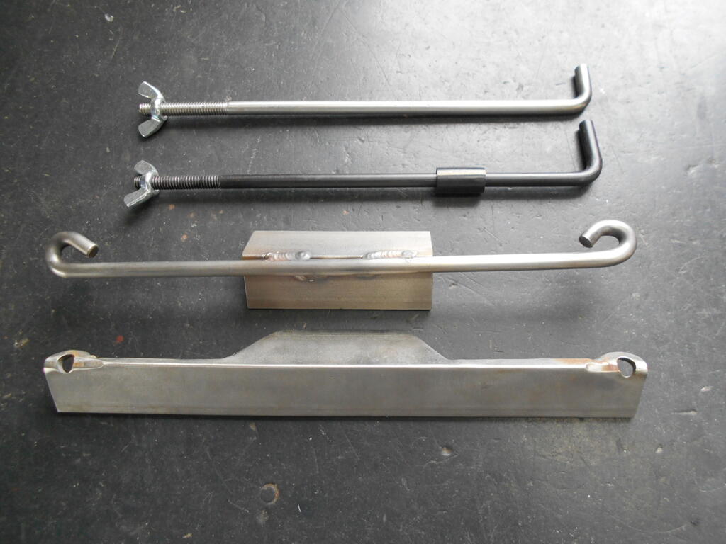

953 nut 70,022 #172 Posted December 7, 2023 11 hours ago, ebinmaine said: We can't take credit for that one. It's similar to some stock Wheelhorse setups I've seen but MUCH beefier. That is the same as the battery hold down on my 418-C and 310-8. I had to replace one on another years ago and used a piece of Stainless steel angel iron with notches cut out to assure it wouldn't contact the battery terminals. Wish I had taken pictures guess if I don't have pictures it didn't happen. 3 Share this post Link to post Share on other sites
cleat 9,401 #173 Posted December 7, 2023 (edited) Here is a couple of picture showing a pair of battery hold downs I made. Top one mimics the factory one and the bottom one is made from a piece of angle iron. Both made from stainless steel. Edited December 7, 2023 by cleat 1 3 Share this post Link to post Share on other sites
ebinmaine 81,035 #174 Posted December 8, 2023 The Workhorse has been delivered!!! The new owners are SUPER Happy! 1 6 Share this post Link to post Share on other sites
