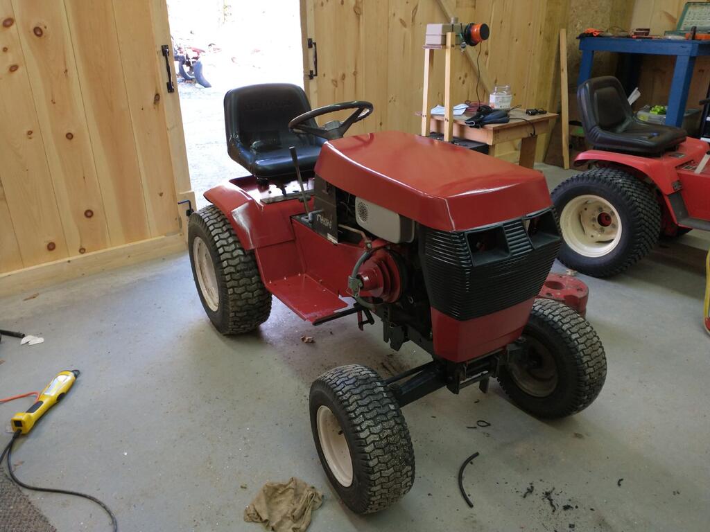

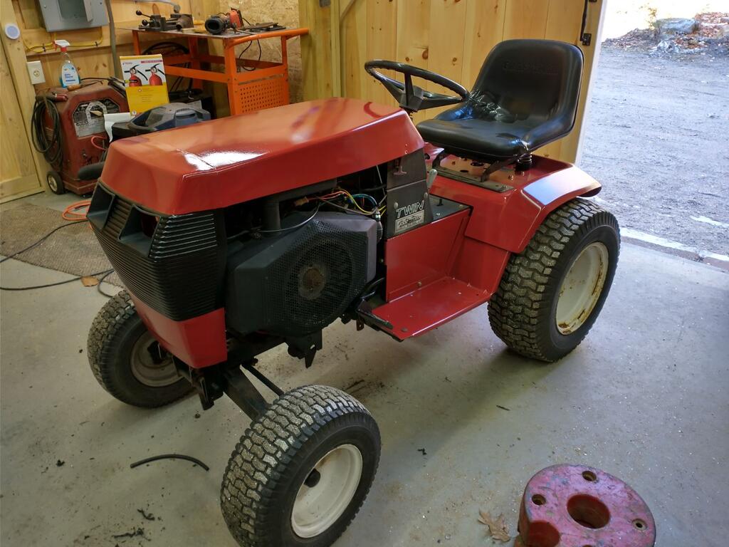

cleat 9,401 #126 Posted November 23, 2023 Looks great. Front end alignment may be a wee bit off. My Work Horse is my next project. I will likely leave it grey but your red one looks good as well. 2 1 Share this post Link to post Share on other sites

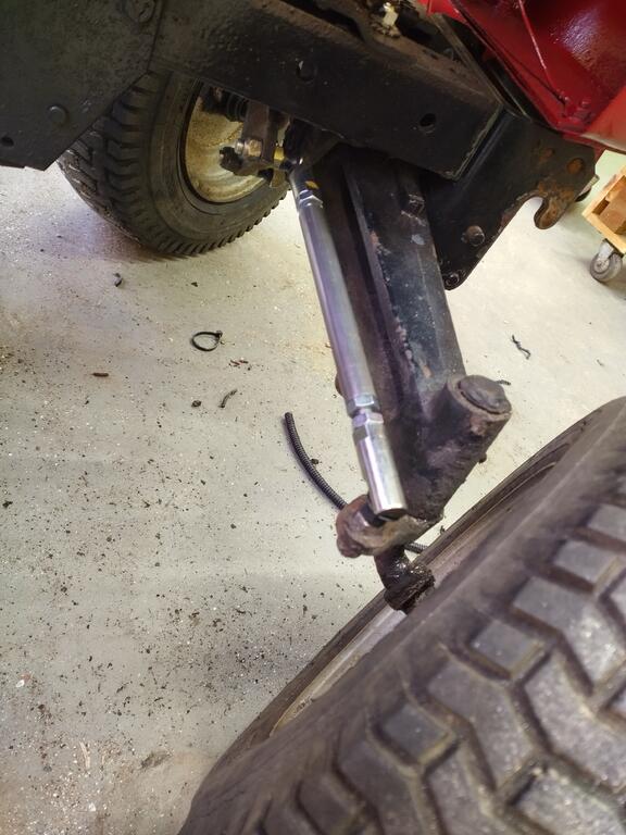

ebinmaine 81,035 #127 Posted November 23, 2023 9 minutes ago, cleat said: Looks great. Front end alignment may be a wee bit off. Thanks Cleat! We replaced the stock Wheelhorse worn out tie rods with a couple slightly better ones we had here. The pic is at an angle that magnifies the tow out but... It is still way off. They'll need to get a set or have us make some up that can straighten things out. I ordered the fixins from MMC for a spare set anyway. 9 minutes ago, cleat said: I will likely leave it grey but your red one looks good as well. Thank you. That's a pretty close match to the Wheelhorse maroon from the 90s. 1 Share this post Link to post Share on other sites

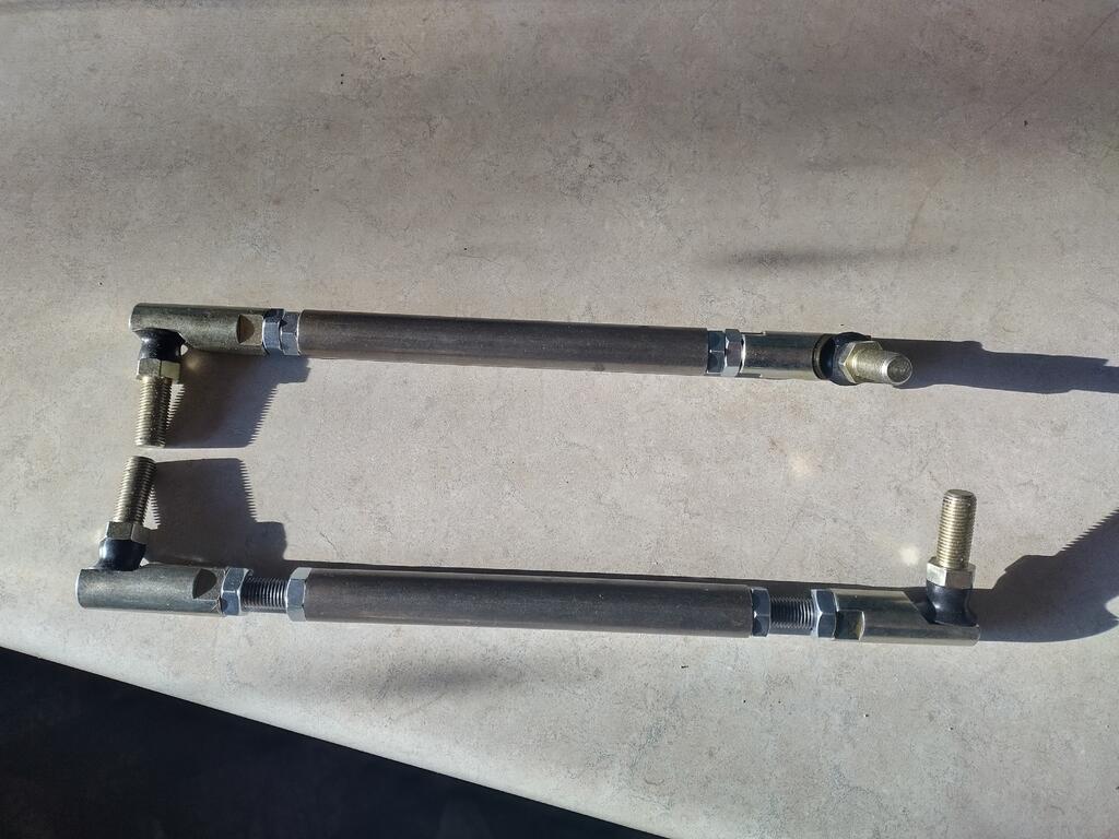

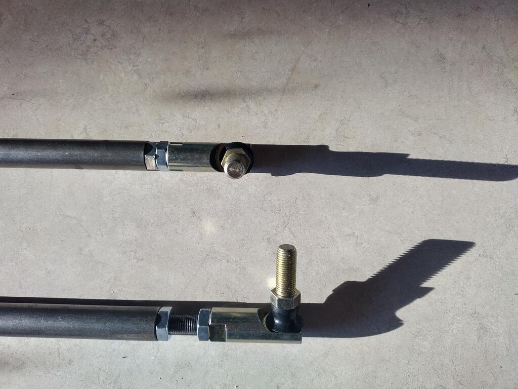

ebinmaine 81,035 #133 Posted November 23, 2023 Couldn't get the steering tow out to set right so I made a new set of adjustable tie rods. 3 2 1 Share this post Link to post Share on other sites
Jon Paulsen 291 #134 Posted November 23, 2023 Nice looking tie rods, Eric. What did you use for the tubing between the ends? I was thinking plain old black pipe would be suitable, but never looked up the dimensions for tapping the threads. 2 Share this post Link to post Share on other sites
ebinmaine 81,035 #135 Posted November 24, 2023 10 minutes ago, Jon Paulsen said: Nice looking tie rods, Eric. What did you use for the tubing between the ends? I was thinking plain old black pipe would be suitable, but never looked up the dimensions for tapping the threads. Thanks Jon. I have several sets of parts on hand. I wish I could remember where I got these. They appear to be stainless or very good steel like a chromoly alloy. Black iron pipe would likely work fine if you could get a size small enough to tap. We normally switch over to Heim joints. I don't even remember why I had these pieces on hand. 1 1 Share this post Link to post Share on other sites
Jon Paulsen 291 #136 Posted November 24, 2023 Thanks for the info., Eric. I'll do some math some day when that day is new tie rod day 2 Share this post Link to post Share on other sites

ebinmaine 81,035 #139 Posted November 24, 2023 34 minutes ago, Jon Paulsen said: Thanks for the info., Eric. I'll do some math some day when that day is new tie rod day When I build the Heim joints I go to a 7/16" double male ends. The 3/8" holes in the tractor are normally wallowed out a little oblong and the next step up to 7/16" requires just enough drilling to round out the holes. Another advantage is the 7/16" parts are a LOT stronger than the 3/8". I buy the Heim joints and jam nuts from McMaster Carr. You may be able to find center pieces as small swage tubes. If you have access to a metal lathe you could use the old tie rods as blanks to be cut and male threaded for use with female Heim joints. 1 2 Share this post Link to post Share on other sites

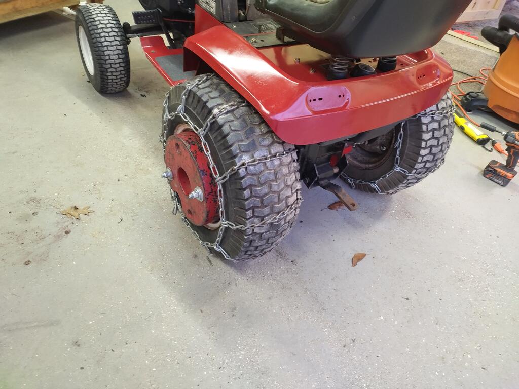

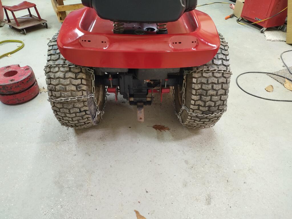

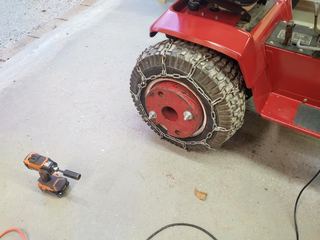

ebinmaine 81,035 #144 Posted November 25, 2023 Got the tire chains on a couple days ago. Weights and plow are next. 1 5 Share this post Link to post Share on other sites

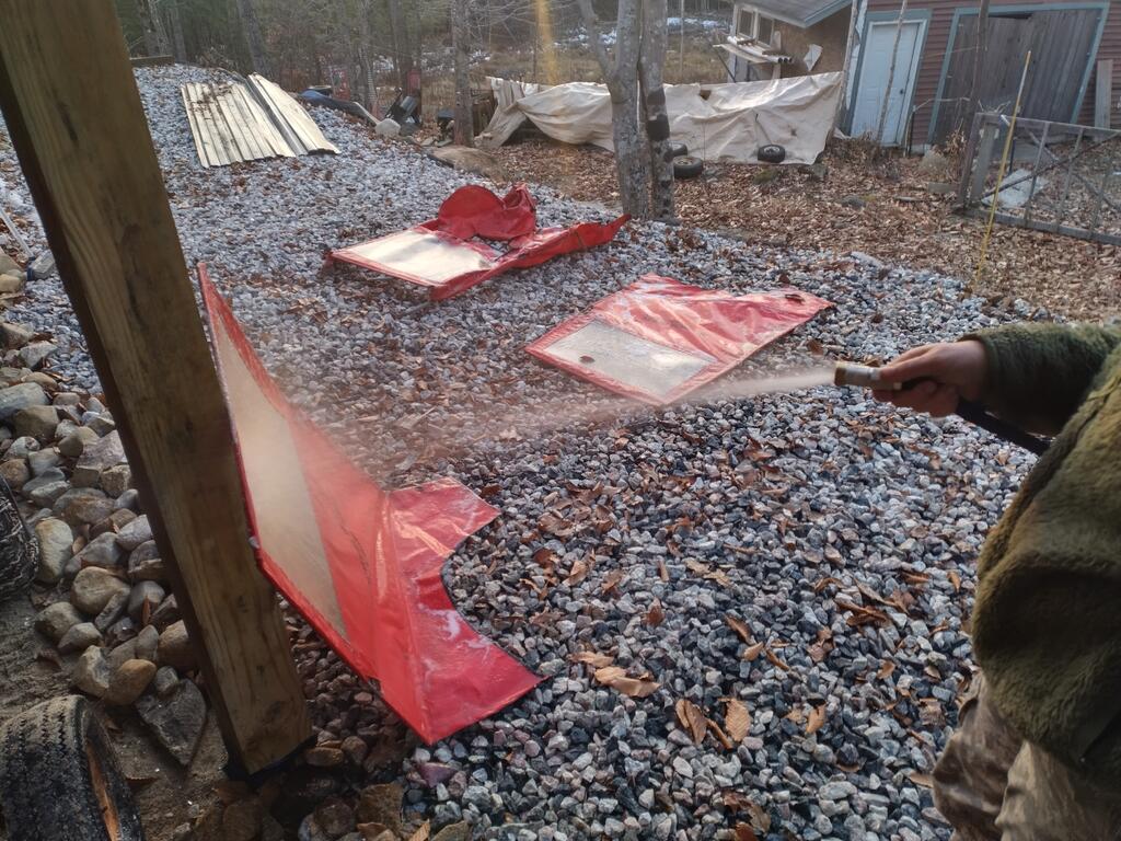

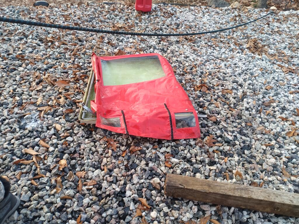

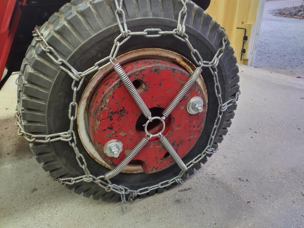

ebinmaine 81,035 #149 Posted November 25, 2023 Piles of work done around the acreage today. Part of it was this project Weights are on. Chain springs on. Trina gave the cab a very good washing up. 4 Share this post Link to post Share on other sites
