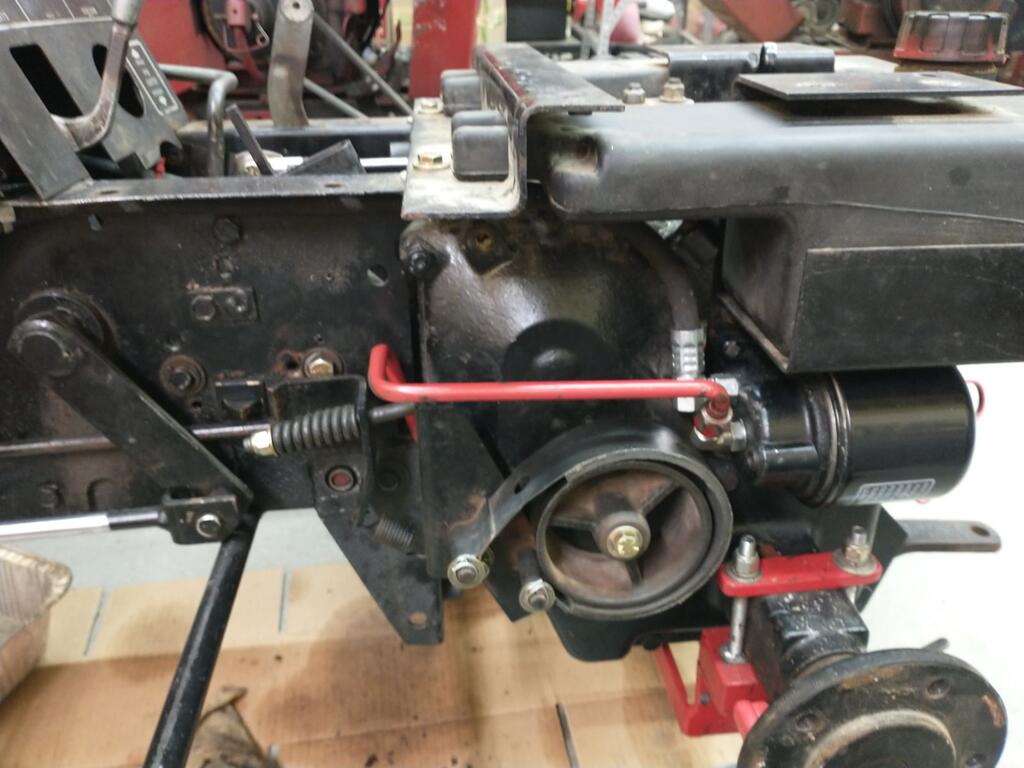

ebinmaine 79,152 #252 Posted July 30, 2024 We still have a leak... After partial disassembly we can see a lot of fluid near the hard metal pipe at the front of the transmission. That pipe leads to the oil filter. 1 Share this post Link to post Share on other sites
Handy Don 16,751 #253 Posted July 30, 2024 (edited) 12 hours ago, ebinmaine said: That crowfoot socket @JCM mentioned? Use it to try tightening the hose fitting to the elbow? Edited July 30, 2024 by Handy Don 1 1 Share this post Link to post Share on other sites
cleat 8,986 #254 Posted July 30, 2024 12 hours ago, ebinmaine said: We still have a leak... After partial disassembly we can see a lot of fluid near the hard metal pipe at the front of the transmission. That pipe leads to the oil filter. That fitting has an O ring under the nut right at the transmission and is a flare type fitting on the other side of the 90 degree fitting. Determining which side of the 90 will help in diagnosing the leak. 1 1 Share this post Link to post Share on other sites

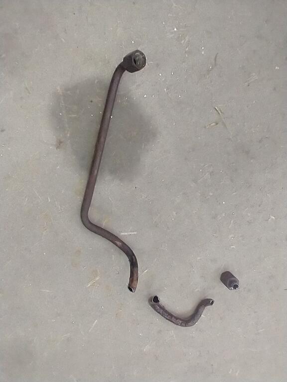

ebinmaine 79,152 #255 Posted August 1, 2024 Trina found that the pipe was cracked right at the flare fitting. 3 Share this post Link to post Share on other sites
cleat 8,986 #256 Posted August 2, 2024 That looks like it might leak all right. 5 Share this post Link to post Share on other sites
Handy Don 16,751 #257 Posted August 2, 2024 3 hours ago, ebinmaine said: Trina found that the pipe was cracked right at the flare fitting. Good sleuthing! Just follow the fluid.... Since you have good access, I’d recommend replacing with a hard tube. I used copper-nickel brake line which has more than adequate strength, won’t rust, and can be worked with simple bending and flare tools. Not a good idea to try bending without tools--it kinks easily. I needed a couple of practice flares to get a good sense of how much tube to leave in the flare tool to have enough for the flarel. I also got new flare sleeves and flare nuts, of course, the nuts are possibly re-usable but why chance it. 3 Share this post Link to post Share on other sites

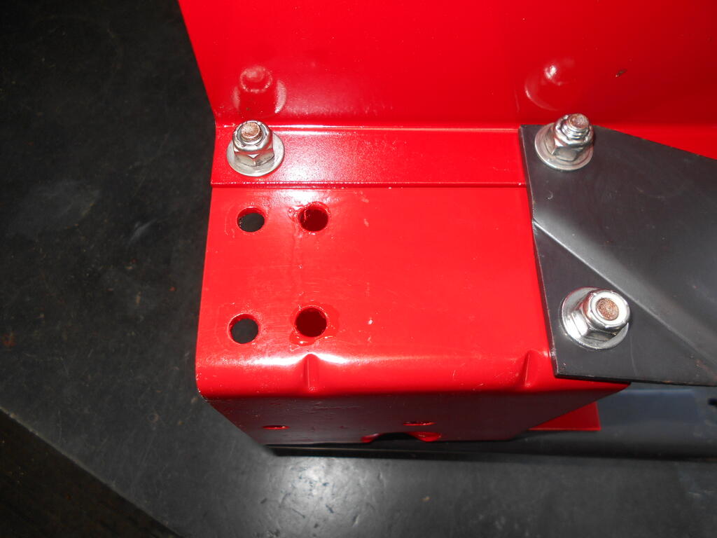

cleat 8,986 #259 Posted August 2, 2024 (edited) That is a low pressure return line so nothing too special as far as pressure is concerned so thin wall tubing would work. There are a few on ebay. Just be sure to get the right one as they are at least two different styles. This one is likely like yours and has a 90 degree fitting on the filter housing. The other style puts another bend in the line and uses a straight fitting at the filter housing. In theory you could use either as long as you had the right fitting but there is one catch. The one with the straight fitting also mounts the filter back just a bit (1/2 or 3/4" I don't remember exactly). Again not a big deal but you would need to drill another set of holes in the gas tank/fender support if your does not have the extra set of holes already (which I doubt you do). So far as I know, the other end of the tube that connects to the axle is the same on them all so you just need to make sure the filter end is correct. Edited August 2, 2024 by cleat 1 2 Share this post Link to post Share on other sites

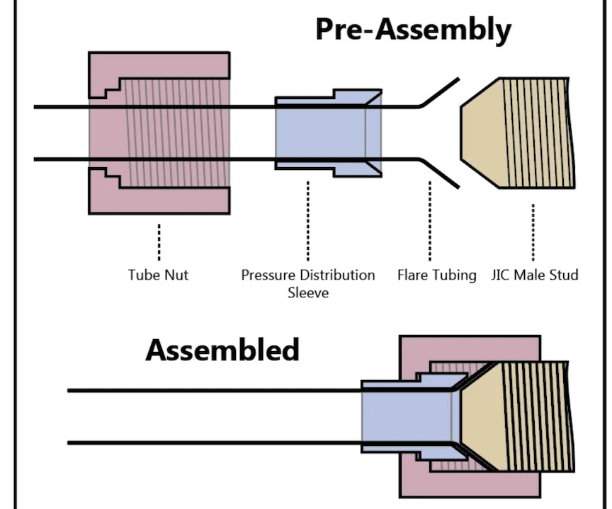

Handy Don 16,751 #262 Posted August 2, 2024 (edited) 1 hour ago, ebinmaine said: IF. I can get the right fittings is there any reason not to use a flexible hose Based on pressure, no reason. Convenience? Flexible hoses are two to three times as thick and don’t turn as sharply. Routing through narrow twisty places and supporting against vibration and friction is the tricky part. Buying one in good condition that is already bent to the shape you need is a good thought. This one seems to have the same number of bends as the “cracked” one. Dimensions do matter, as @cleat notes. I assumed (perhaps mistakenly) that you’d go ahead and make your own replacement. My work to extend the hydraulics on the 520 chassis required several new connections so fabricating was the only option and I’ve gained confidence in this area! 5 hours ago, ebinmaine said: What part is the "flare sleeve"? At each end of a metal hydraulic line using JIC-type connections, there is a sleeve that fits between the tubing and the tube nut--it supports the malleable flared end of the tube against the hard tapered end of the male fitting and against the turning compression friction of the tube nut. I lifted this illustration from a vendor webpage: Edited August 2, 2024 by Handy Don 2 1 Share this post Link to post Share on other sites
ebinmaine 79,152 #263 Posted August 2, 2024 14 minutes ago, Handy Don said: I assumed (perhaps mistakenly) that you’d go ahead and make your own replacement Still might. I have a tubing bender but lack skill and practice. We're exploring options based on convenience, cost, and availability of parts. 15 minutes ago, Handy Don said: each end of a metal hydraulic line using JIC-type connections, there is a sleeve that fits between the tubing and the tube nut--it supports the malleable flared end of the tube against the hard tapered end of the male fitting and against the turning compression friction of the tube nut. So this is a little more involved than a vehicle brake line. No sleeves in those. 1 Share this post Link to post Share on other sites

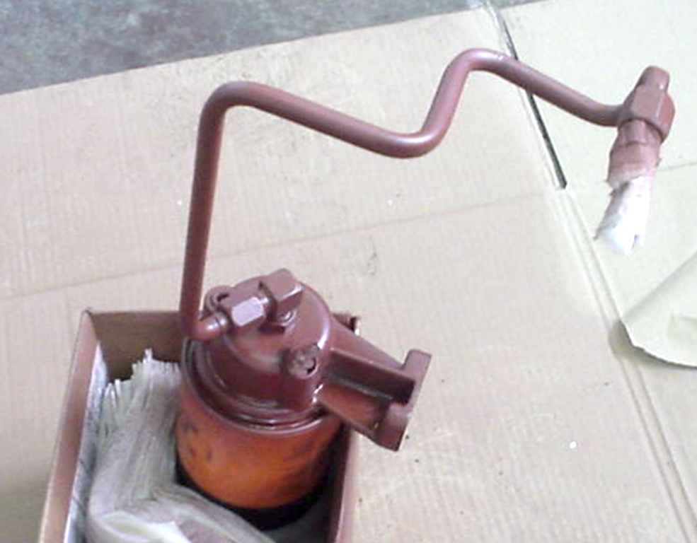

ebinmaine 79,152 #268 Posted August 4, 2024 On 8/2/2024 at 8:12 AM, cleat said: There are a few on ebay. I'm finding a few of the 520 type with the wrong bend. Where are you finding the correct pipe? Share this post Link to post Share on other sites
cleat 8,986 #269 Posted August 4, 2024 32 minutes ago, ebinmaine said: I'm finding a few of the 520 type with the wrong bend. Where are you finding the correct pipe? You are correct, There are none currently listed. I thought I saw one or two a few days ago. I would send you one if I had one. You can use the other style by drilling two holes in the fender bracket but you would still need the straight fitting for the filter housing. 1 Share this post Link to post Share on other sites
ebinmaine 79,152 #270 Posted August 4, 2024 8 minutes ago, cleat said: You are correct, There are none currently listed. I thought I saw one or two a few days ago. I would send you one if I had one. You can use the other style by drilling two holes in the fender bracket but you would still need the straight fitting for the filter housing. No worries Cleat. Thanks. A to Z Tractor in PA shows one. I'll order that. I ask because it turns out I don't have the tooling to create two tight 90⁰ bends close to one another. I could have the above mentioned Hydraulics shop do it but I'd rather just get the right part. 2 Share this post Link to post Share on other sites

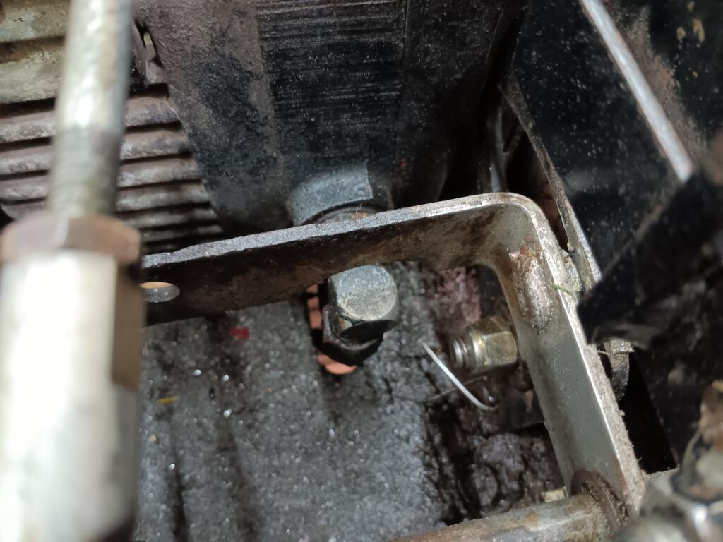

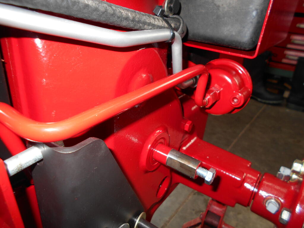

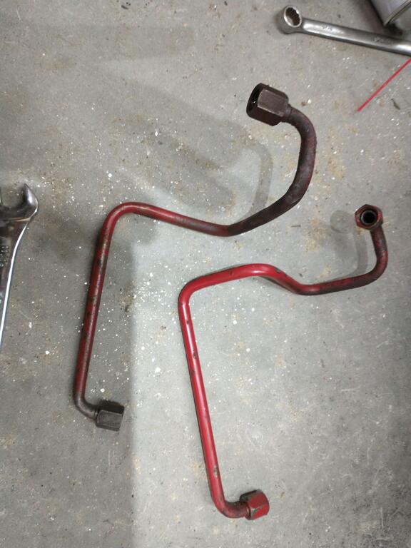

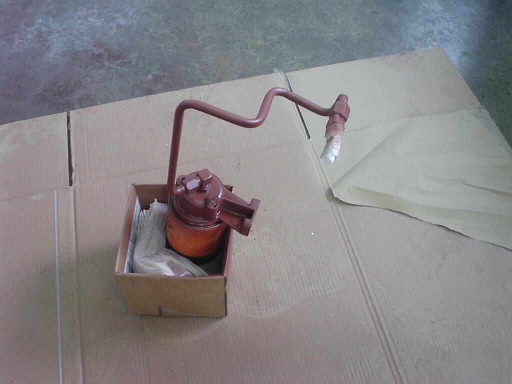

ebinmaine 79,152 #271 Posted August 16, 2024 On 8/2/2024 at 8:12 AM, cleat said: There are a few on ebay. @cleat I got the pipe from Lincoln at A to Z Tractor based on what part numbers I could find various places online. Here's a screenshot of your GT1600 Hydro project showing the pipe we need. The one we got is pre-bent to a form where the yellow line is so it interferes with the brake mechanism. Do you have a correct part number or any other suggestions? Share this post Link to post Share on other sites
ebinmaine 79,152 #272 Posted August 22, 2024 When I let Lincoln at A to Z Tractor know what we had going on here he immediately sent another pipe right out. Here's the two side by side: And all installed. 2 6 Share this post Link to post Share on other sites

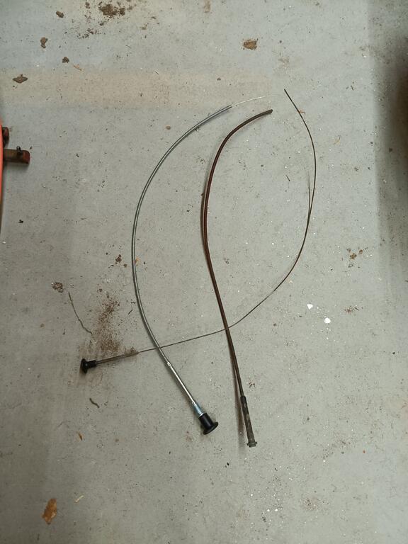

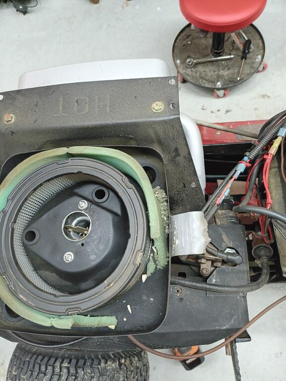

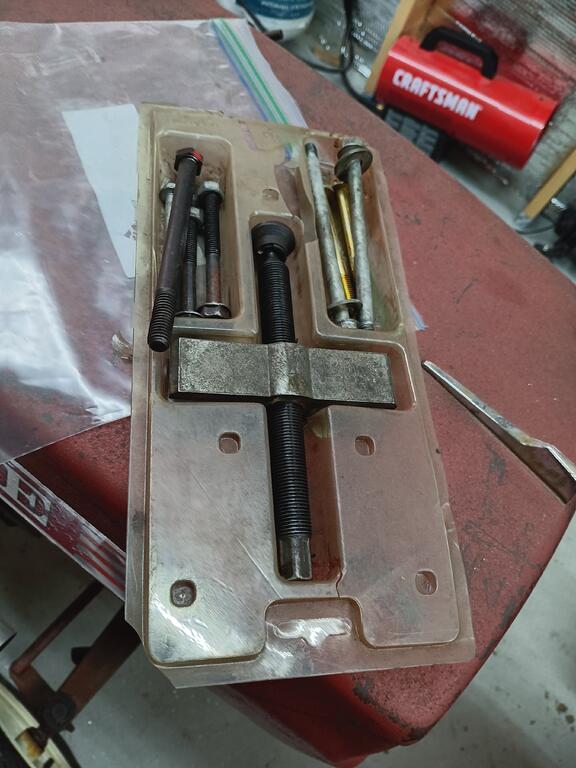

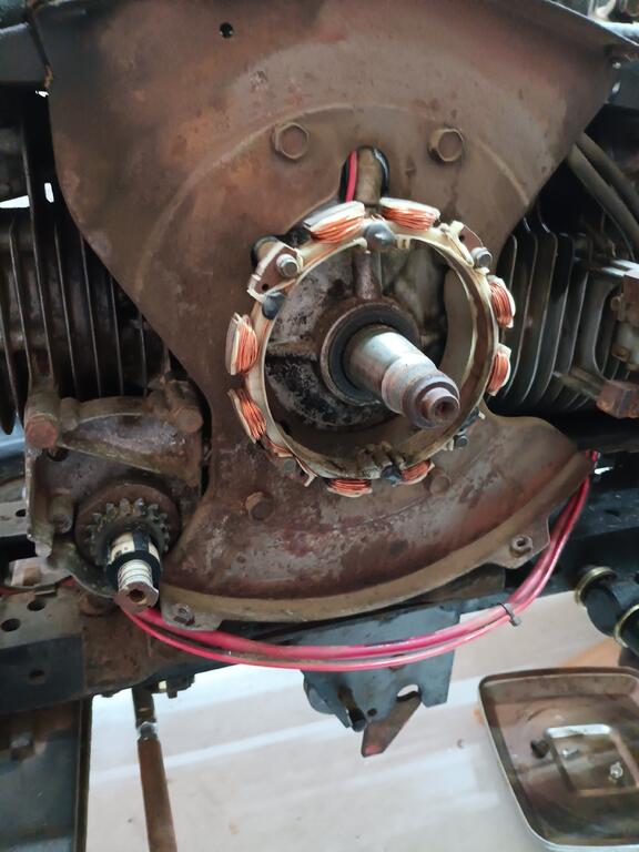

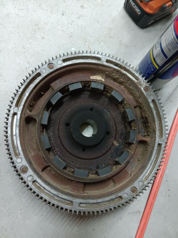

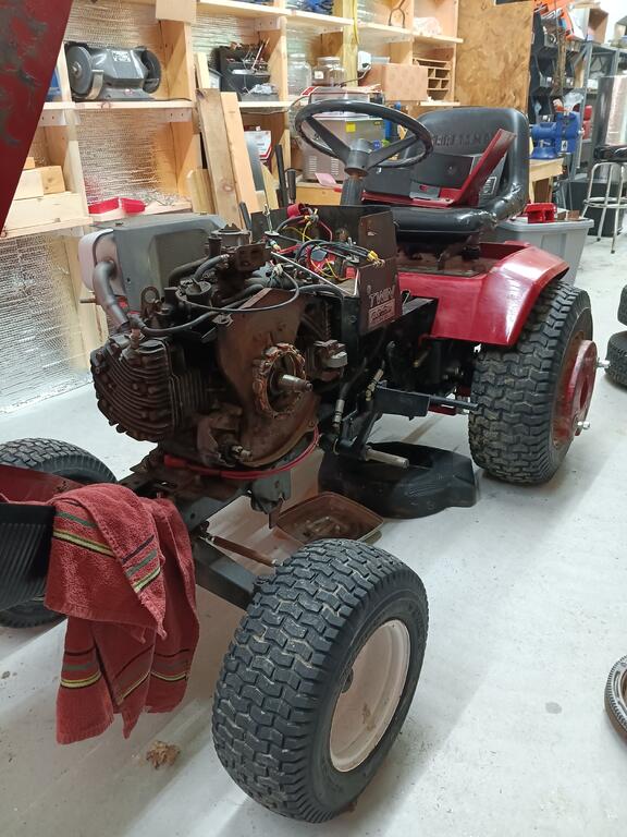

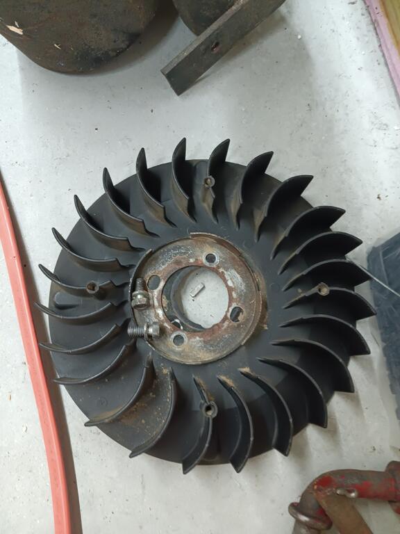

ebinmaine 79,152 #275 Posted June 5, 2025 Got this Ole Girl back in the Workshop for some R & R. Regular maintenance. LOF. Change air filter. Replaced the old rusty choke cable. Also readdress the fluid leak. The valve was still seeping some when we let it go home last fall. But now there's a no start condition too. Soooooo..... The starter gear is trash. This evening I used a puller given to me a by a coworker several years ago to pop the engine flywheel off. 1 Share this post Link to post Share on other sites
