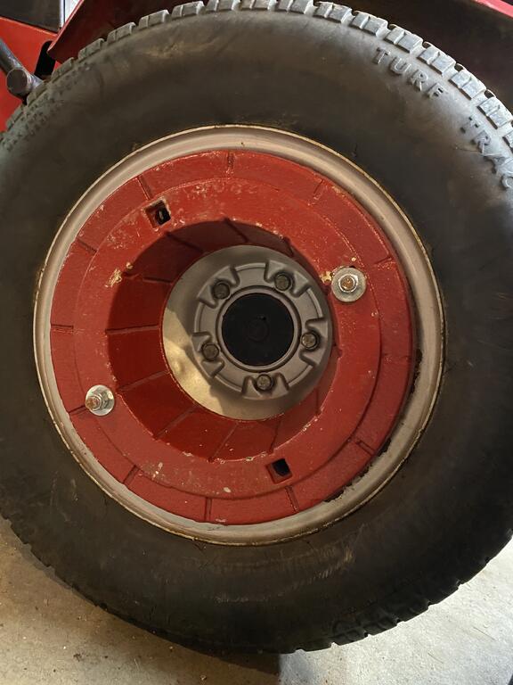

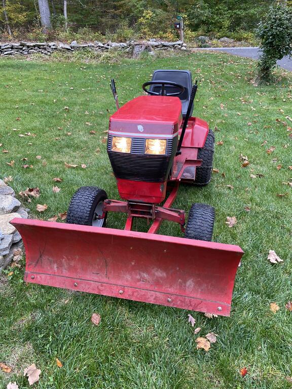

Sparky-(Admin) 26,898 #1 Posted October 14, 2023 I always have a couple rigs set up for winter snow clearing. My tractor isn’t ready yet but the one I leave at the in-laws so I can clear snow at their place is now ready to ship out. 308-8 with inside and outside weights plus 4 link chains (prefer 2 link but it’s what I have on the shelf so…) The plow is a 42” so I don’t over stress the little Magnum 8 power plant . 5 10 Share this post Link to post Share on other sites

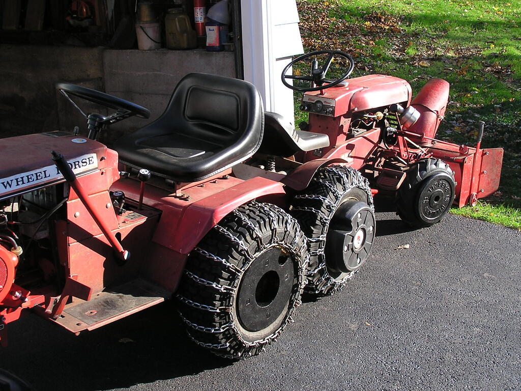

ri702bill 13,398 #6 Posted October 14, 2023 Mike - all that cast iron goodnes, but none up front????? 1 Share this post Link to post Share on other sites

ri702bill 13,398 #8 Posted October 14, 2023 All dressed for Winter - makes the yard art relative jealous.......... 1 4 Share this post Link to post Share on other sites
Sparky-(Admin) 26,898 #9 Posted October 14, 2023 19 minutes ago, ri702bill said: Mike - all that cast iron goodnes, but none up front????? The main reason: I don’t have anymore front weights … but I find with the smaller front blade this tractor doesn’t lose front steering as easily as my other one with a 48” blade 3 Share this post Link to post Share on other sites

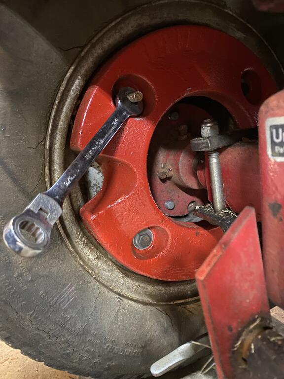

ri702bill 13,398 #11 Posted October 14, 2023 (edited) 1 hour ago, Sparky said: The main reason: I don’t have anymore front weights Time to whip up a set of these 25 lb barbell weight puppies...... not that difficult to make - tapping questionable grain structure cast iron can be challenging. Edited October 14, 2023 by ri702bill 2 2 Share this post Link to post Share on other sites
