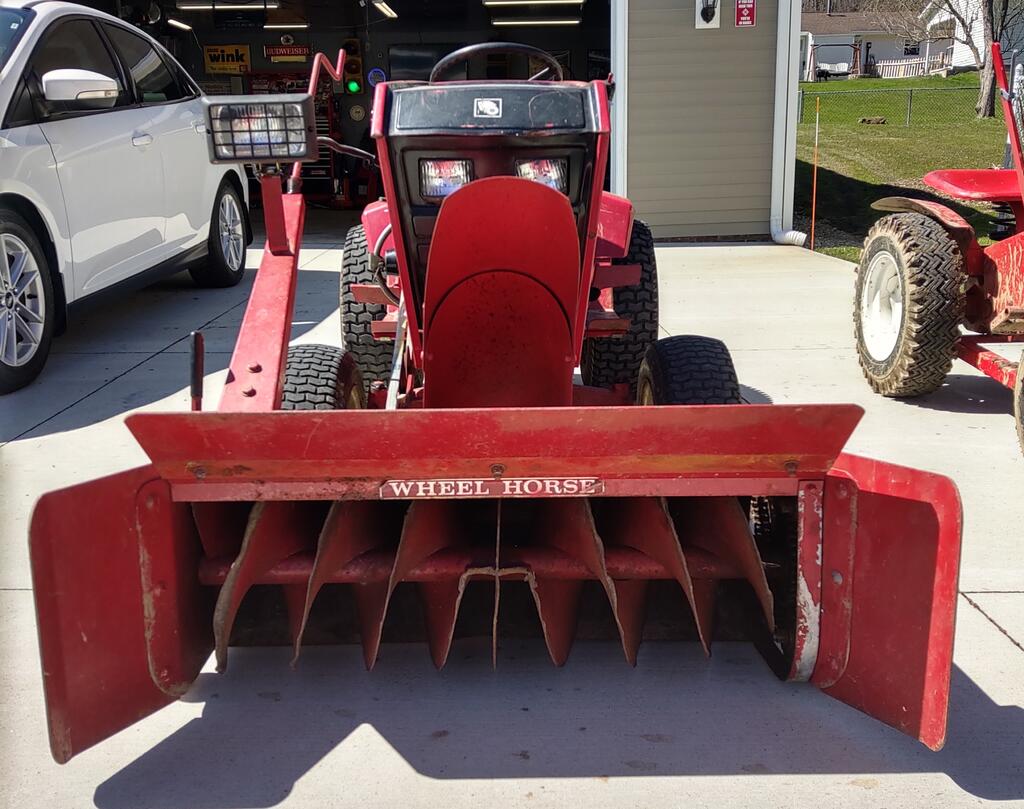

ML3 2,533 #1 Posted October 13, 2023 Opinions..... The side wings on snowblower I've seen some using them installed & others with them removed. Obviously with them installed it covers a wider area but that's really not an issue for me. My driveway is new cement, flat/level, & not real big. 1 Share this post Link to post Share on other sites
ri702bill 13,189 #2 Posted October 13, 2023 I added entension wings to the sides of my early 32" snowblower - worth the effort. 2 Share this post Link to post Share on other sites
wallfish 20,658 #3 Posted October 14, 2023 It all depends upon the HP you are are running it with. Small 8hp, ditch the wings. Big 16 to 20 hp, definitely add them. In between is a preference thing IMO. The other factor is how long do you really want to be out there freezing your @#!!$ off? Then driveway size could factor in 3 Share this post Link to post Share on other sites
mrc 1,119 #4 Posted October 14, 2023 without the wings the blower is only 36 inches wide. depending on what rear tires you have your tractor is about 37-40 inches wide. (see the issue?) in my experience i want the blower to clear a wider path than my tractor. otherwise your tires will be packing down snow just outside of where you just cleared. also when turning your tractor will generally be in a clear spot if you have the wings installed. regards mike 1 Share this post Link to post Share on other sites
ML3 2,533 #5 Posted October 14, 2023 8 hours ago, wallfish said: It all depends upon the HP you are are running it with. Small 8hp, ditch the wings. Big 16 to 20 hp, definitely add them. In between is a preference thing IMO. The other factor is how long do you really want to be out there freezing your @#!!$ off? Then driveway size could factor in The tractor is a C105. Share this post Link to post Share on other sites
ML3 2,533 #6 Posted October 14, 2023 6 hours ago, mrc said: without the wings the blower is only 36 inches wide. depending on what rear tires you have your tractor is about 37-40 inches wide. (see the issue?) in my experience i want the blower to clear a wider path than my tractor. otherwise your tires will be packing down snow just outside of where you just cleared. also when turning your tractor will generally be in a clear spot if you have the wings installed. regards mike Makes sense about the width. Ultimately I really need a 2 stage setup as I live in northeast Ohio primary snow belt. That will require getting a larger tractor. (Been looking) Want something like a 520 Hydro. Snowblower, especially a 2 stage, is a bit heavy to manually lift with my sciatica issues Share this post Link to post Share on other sites
