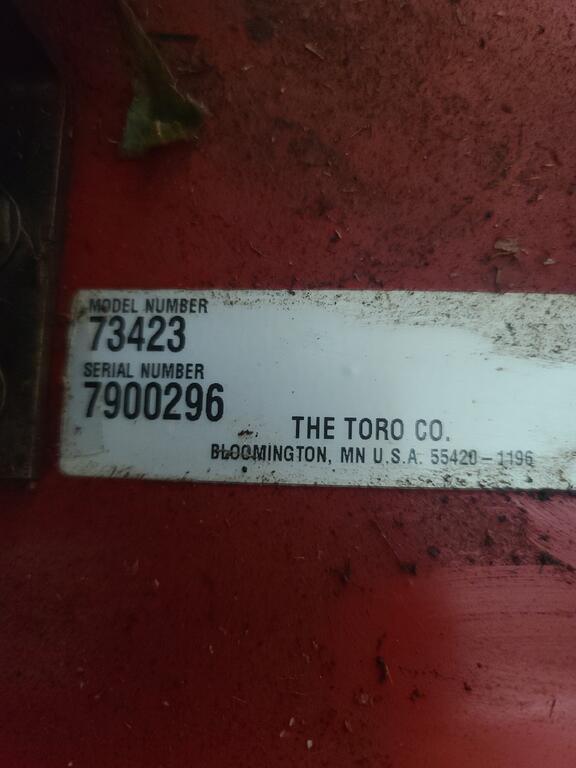

Tonytoro416 1,396 #1 Posted October 12, 2023 Is there any other ways to try and narrow down the year of this 520h I recently pickup. The id tag is in pretty bad shape and what numbers I can read aren’t really matching up to anything I have found any insight is much appreciated Share this post Link to post Share on other sites

Cee245 881 #4 Posted October 12, 2023 (edited) 96 shpuld have gold emblems / decals. 96/97 have thicker foot rest pads and they line up with rear fender better. Can read the first couple numbers? In the pic, Its a 1997. Reverse first two number. Goes down to 39XXXXX (1993) i think. Then 1992 and earlier start with O31- or something like that... Edited October 12, 2023 by Cee245 Add pic 2 Share this post Link to post Share on other sites
