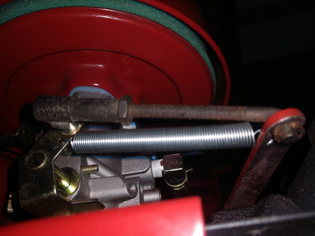

kpinnc 18,390 #4 Posted October 11, 2023 (edited) Slop between the governor arm and throttle on the carb can add to how quick the governor response is. Always a good idea to add a spring between the two to eliminate it. The holes are already there. Any light spring will work, and it won't negatively affect anything. Edited October 11, 2023 by kpinnc 3 Share this post Link to post Share on other sites

MrEff87 0 #6 Posted October 28, 2023 Sorry for the delay. Thanks guys! I did the governor adjustment and the surging stopped. Now I just need to figure out why it runs at max RPM’s “or higher” at half throttle, but that’s a problem for another day. Share this post Link to post Share on other sites
