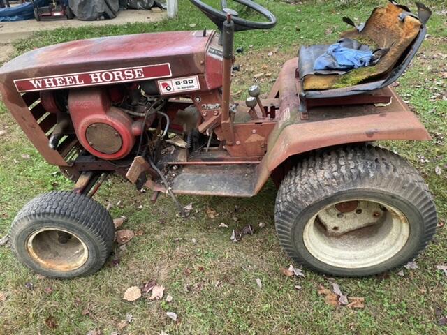

AHS 1,698 #1 Posted October 7, 2023 I got a Wheelhorse for $50!!!!! A B80, its an 8 speed…. so it must a 76 or a 77? 71-08k801 14413 and the number below it is 7094… i think!! All factory wiring and coil. It looks like the PTO seal is bad..oil all over the place! We’ll see once i get it running!! I changed the oil and gas came running out.. cute!! Hopefully clean the carb, set the points and new fuel line/filter.. and it’ll be a runner!!! 5 3 Share this post Link to post Share on other sites
Racinbob 13,135 #2 Posted October 7, 2023 The 71 prefix indicates it's a 77. 76's and 77's are identical though. The B series and C series Are identical in those two years save for some cosmetic items and HP. Here's my 76 B-80 that I purchased new and still have it. It grew into a "B"-160. 1 3 Share this post Link to post Share on other sites
ebinmaine 80,654 #3 Posted October 7, 2023 I'm really happy to see you got that! Now that machine can be maintained like it should be and put to work. You'd really like the little 8 HP engine. Economical and powerful for its size. That's a... uhhh... nice seat ((??)) 2 Share this post Link to post Share on other sites
AHS 1,698 #4 Posted October 7, 2023 40 minutes ago, ebinmaine said: I'm really happy to see you got that! Now that machine can be maintained like it should be and put to work. You'd really like the little 8 HP engine. Economical and powerful for its size. That's a... uhhh... nice seat ((??)) Ya.. the seats gonna be the most expensive item!! 1 Share this post Link to post Share on other sites
ebinmaine 80,654 #5 Posted October 7, 2023 4 minutes ago, AHS said: Ya.. the seats gonna be the most expensive item!! You might be able to find a decent used one? 1 Share this post Link to post Share on other sites

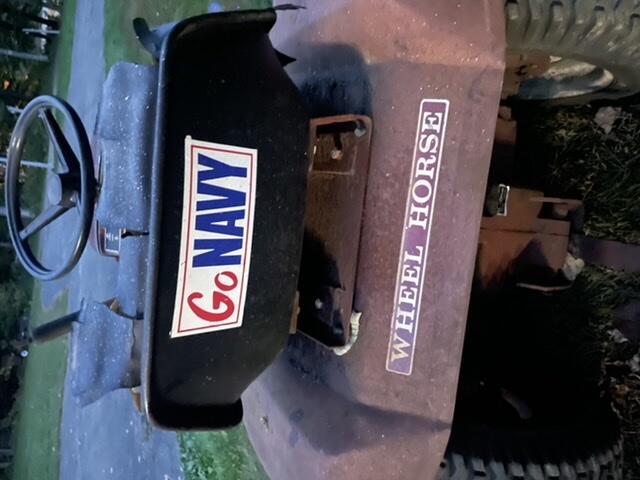

Jon Paulsen 291 #17 Posted October 8, 2023 A leaking needle valve in the carby can ruin the crankshaft's day Note: I have never had a Kohler engine, so as usual, take anything I say with a grain of salt, ya old salt Glad you gotcha a nice new toy. And, of course: FLY NAVY! 1 Share this post Link to post Share on other sites
