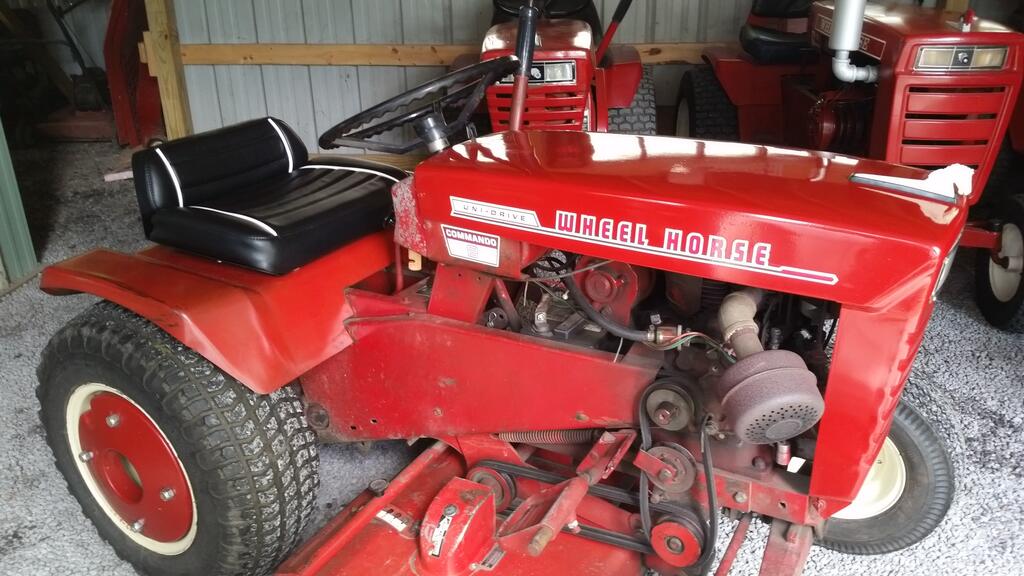

JCLPAYNE 1 #1 Posted October 5, 2023 Hello, first time member here who recently purchased a 1968 commando, I am looking for the deck drive belt size, or called the PTO belt? Im pretty sure it is 70'' by 1/2. If anyone could confirm the belt size or part number, it would be greatly appreciated. I attached a photo below. Thank you for your time! 1 Share this post Link to post Share on other sites

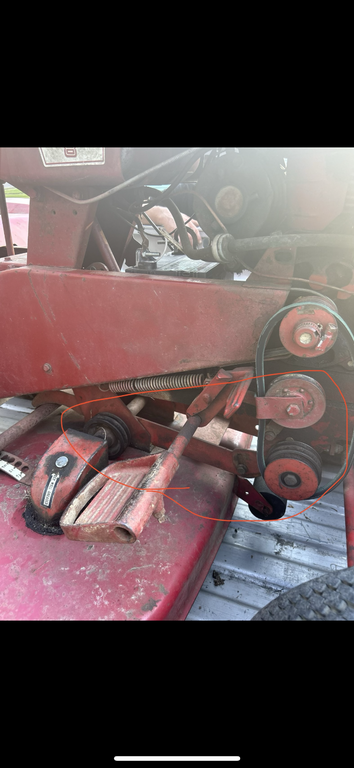

Pullstart 71,088 #3 Posted October 6, 2023 the belt(s) you are looking for are twins and run from the front bottom pulley to the gear shaft on the deck. The PTO belt is there. Share this post Link to post Share on other sites

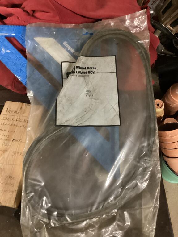

Pullstart 71,088 #4 Posted October 6, 2023 I’m cleaning my shop. I just found a set of N.O.S. 1578 belts, what you need. Share this post Link to post Share on other sites
rjg854 13,308 #5 Posted October 6, 2023 This is what the belt routing should look like. Share this post Link to post Share on other sites
