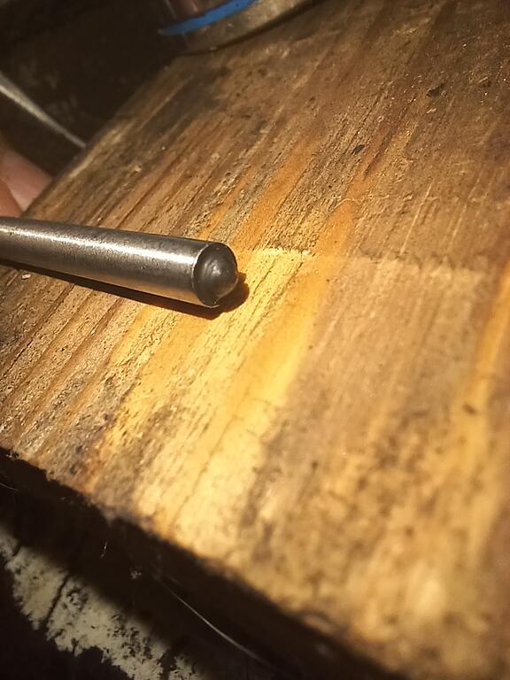

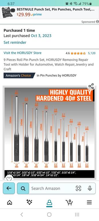

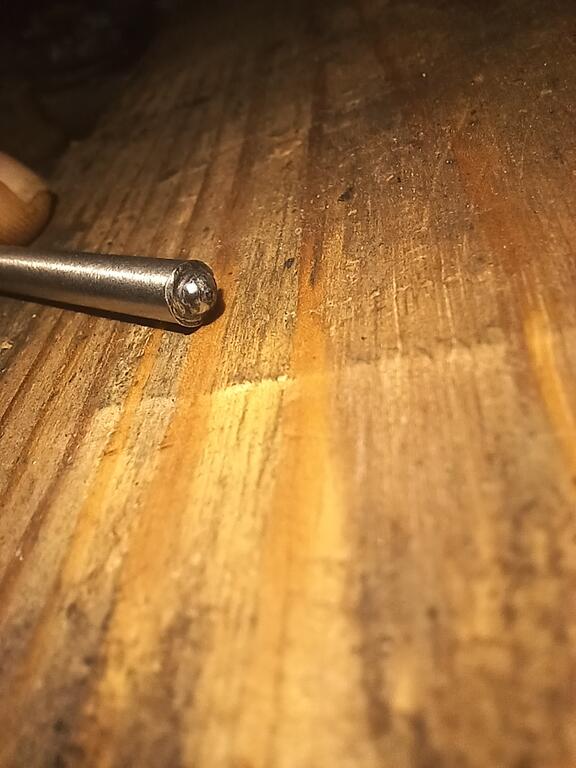

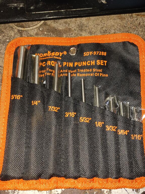

enamel 35 #1 Posted October 5, 2023 Ya I know I took a chance and figured they'd be bad but they said harden steel. So 50 50 shot lol, and at 10.00 shipped I figured I'd try them. I'll return them. But I'll get a better set US made lol. Brand is Horusdy First pic is before use. 2nd pic is after 1 use. 2 3 Share this post Link to post Share on other sites
ebinmaine 80,092 #2 Posted October 5, 2023 "Drop forged and heat treated steel". Really does NOT have to be a truly "Hardened" steel. I've been carefully buying some VINTAGE tools off the fleeeeBay. Decent luck so far. 3 Share this post Link to post Share on other sites
enamel 35 #3 Posted October 5, 2023 (edited) 3 minutes ago, ebinmaine said: "Drop forged and heat treated steel". Really does NOT have to be a truly "Hardened" steel. I've been carefully buying some VINTAGE tools off the fleeeeBay. Decent luck so far. Ya I seen that when I got them. The listing says harden steel lol. Good ol Amazon Edited October 5, 2023 by enamel Picture 2 Share this post Link to post Share on other sites
ebinmaine 80,092 #4 Posted October 5, 2023 Might wanna report that to em. Also post a 1 star review. Won't help you but maybe someone else. 3 Share this post Link to post Share on other sites
