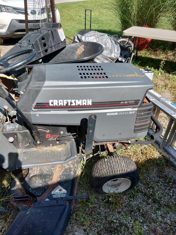

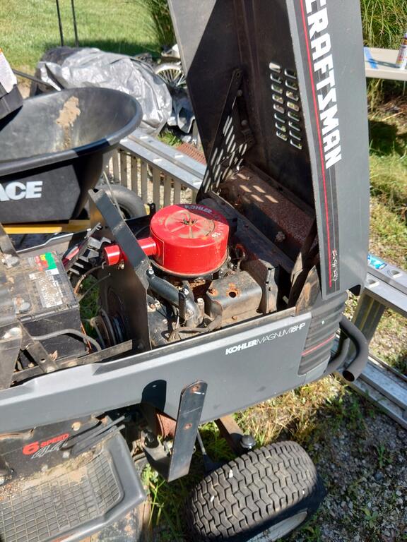

Bill D 3,193 #1 Posted October 4, 2023 Someone offered me an M18 in a Sears. Would it be possible to machine a drive pulley for an 1 1/8" crank like the pulley found on the GT1100/1142 to allow use of a thrust bearing and plate? Thanks. Share this post Link to post Share on other sites

bds1984 1,519 #7 Posted October 6, 2023 I ran into an issue with an M18 like this where the crankshaft wasn't long enough for a transmission pulley and an electric clutch to be used simultaneously for a Wheel Horse. If you can run bot, great, but don't be surprised you can only run the transmission pulley on this flavor of M18. I think the odds may be more in your favor for the thrust washer setup. Share this post Link to post Share on other sites
