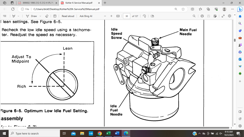

Ed Kennell 47,816 #3 Posted October 3, 2023 9 hours ago, Winkster said: but unsure how many turns if I screw both all the way in. If you back them out 1.5 turns it should run. Then make fine adjustments to get best performance. 1 3 Share this post Link to post Share on other sites
953 nut 70,326 #4 Posted October 3, 2023 11 hours ago, Daddy Don said: Replace the spark plug and it took car of the problem. Hope this might help you out. Did you replace the spark plug with a new Champion H-10? Here is a chart with the proper adjustments for carburetors . 2 1 Share this post Link to post Share on other sites
