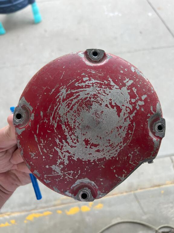

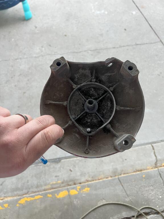

ksellers 6 #1 Posted October 2, 2023 I am making good progress on the wheelhorse that I got for my boys. However, the recoil starter determined it wanted to stop working. I have done some research and it appears that the style that is on it is different than the standard Tecumseh recoil starter. Is this true? If so, where can I get parts? I am primarily needing the spring for it. Any recommendations on where to find it and how to install it without having it snap at me is greatly appreciated! Share this post Link to post Share on other sites
ri702bill 12,497 #2 Posted October 2, 2023 I may be all wet on this one - but that looks like a Lauson recoil - last made around 1961....... Share this post Link to post Share on other sites
ksellers 6 #3 Posted October 2, 2023 55 minutes ago, ri702bill said: I may be all wet on this one - but that looks like a Lauson recoil - last made around 1961....... That's what I was seeing as well. The tractor is believed to be a 1964. Is it possible Tecumseh used starters similar to the lauson ones for a while? The pictures I found show the company name on them, it doesn't look like this one ever had that. If I can find a new spring for it, that would be wonderful, otherwise I will have to pursue other options. Share this post Link to post Share on other sites
