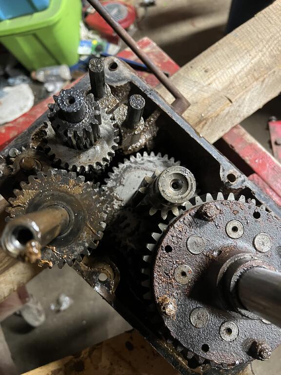

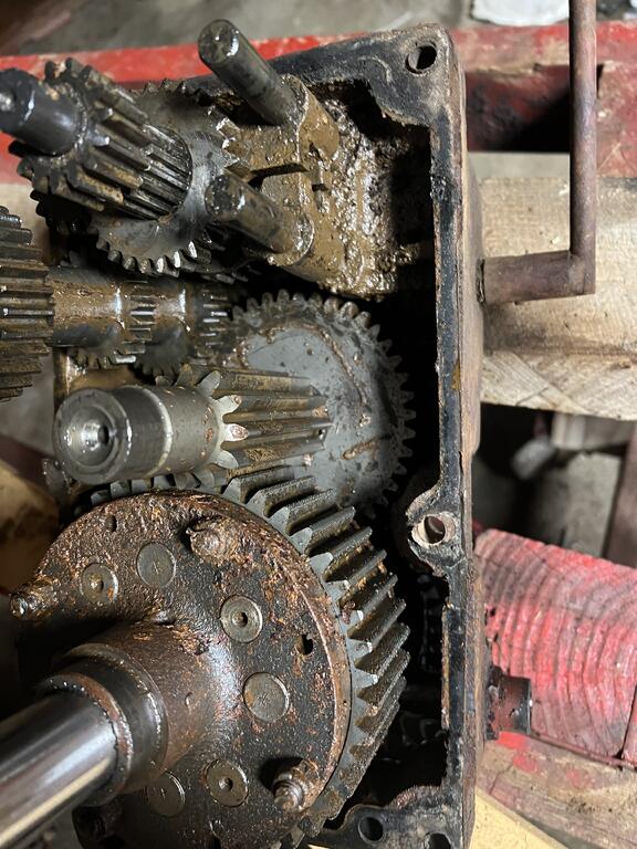

WHGuy413 2,845 #9 Posted October 4, 2023 Got the transmission out last night. It’s a little crunchy in spots but not super bad. I have seen worse. I was able to determine that the case for the old bearing was still in the hole. I drove that out. Todays mission is to clean it up and start putting it back together. I was able To free up the high low which now shifts a lot easier. Everything else looks ok. No major concerns. 1 1 Share this post Link to post Share on other sites
squonk 44,812 #10 Posted October 4, 2023 Looking at those pics I find it hard to believe the rest of the bearings are in good shape. 1 Share this post Link to post Share on other sites
WHGuy413 2,845 #11 Posted October 4, 2023 2 hours ago, squonk said: Looking at those pics I find it hard to believe the rest of the bearings are in good shape. I am changing out the brake shaft bearing and seal as that is cracked but the rest of it all spins freely with no grinding or issues that I noticed. The worst spot out of the whole transmission is where the high low and gear shifters are. 1 Share this post Link to post Share on other sites
squonk 44,812 #12 Posted October 4, 2023 7 minutes ago, WHGuy413 said: I am changing out the brake shaft bearing and seal as that is cracked but the rest of it all spins freely with no grinding or issues that I noticed. The worst spot out of the whole transmission is where the high low and gear shifters are. Did you tear everything down and inspect every bearing? A needle could be missing and you may not even know it by feeling how they spin. I just hate to have you have to tear it all back apart in 6 month's because another bearing failed. 2 Share this post Link to post Share on other sites
WHGuy413 2,845 #13 Posted October 4, 2023 From what I have seen so far all the needles are accounted for and all the round bearing balls are in place. Yes I would rather not tear it apart again but unfortunately a full transmission rebuild was not an option at this time for my friend. Share this post Link to post Share on other sites
