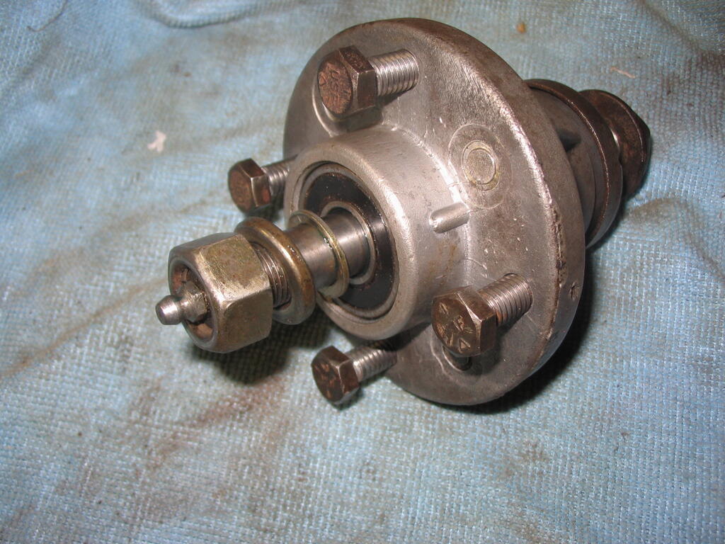

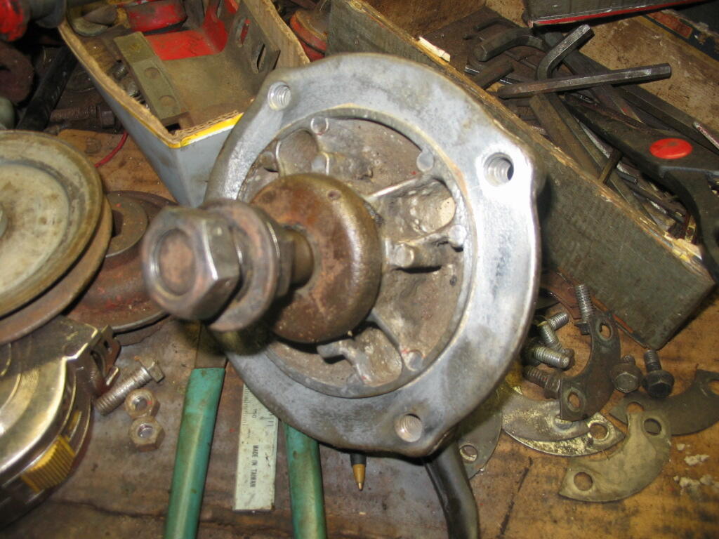

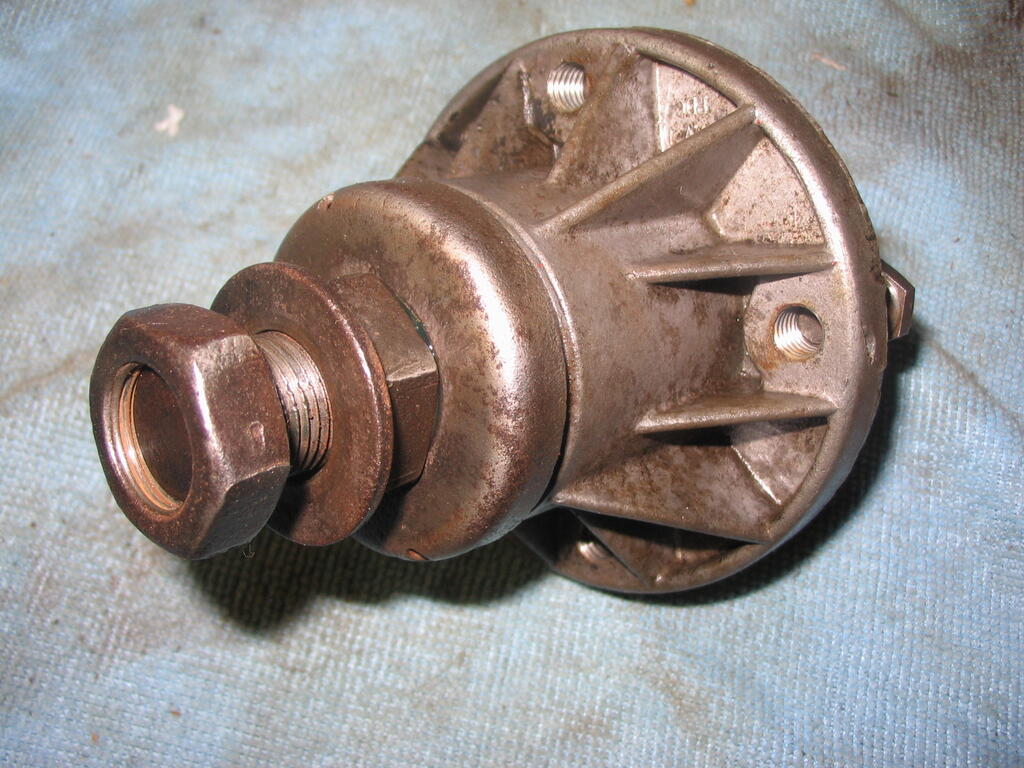

Larry D 0 #9 Posted October 4, 2023 (edited) On 9/28/2023 at 3:31 AM, daveoman1966 said: Not likely. The 36" deck is a 3-spindle deck... the 37" has only two spindles. They are not even similar.  Edited October 4, 2023 by Larry D Share this post Link to post Share on other sites
Larry D 0 #10 Posted October 4, 2023 The bottom assembly appears to be a match to what I need. Available? Share this post Link to post Share on other sites
daveoman1966 3,884 #11 Posted October 4, 2023 I don't have any and was just showing the difference of 36 & 37" decks. The COMPLETE spindle assy (ITEM 16) for 05-36MR03 is part # 109964. Share this post Link to post Share on other sites
