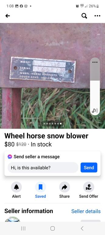

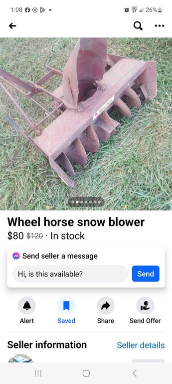

Mike_eash 59 #1 Posted September 26, 2023 I am deciding if I want to buy a 30" snowblower attachment for charger 10 Would it work? see pics If so so doo I need anything special to attach it Thankyou Share this post Link to post Share on other sites
gwest_ca-(File Mod) 11,852 #2 Posted September 26, 2023 Looks like it is a model STR-324 if seeing it correctly and fits the smaller Lawn Ranger tractors. Back in the day the snowthrower came in two packages. These will show everything needed. If you add the front quick hitch to your tractor the latest snowthrowers will work. Here are all the models Snowthrower DNA All have 2 idler sprockets for the drive chain. Started out as 37" wide and the added wings make them 42" wide. 1966-67 model ST-376 1968 model 6-1211 1969 6-6211 plus 6-9111 1970-72 model 6-6212 plus 6-9112 All without front quick hitch so not a direct fit for 1973 and later tractors. Snowthrower rear frame mounts in the front of the tractor frame using 2 bushings and a long 3/8-16 x 8-1/2" bolt. ------------------------------------------------------------------------------------------------------------ Front quick hitch introduced in 1973. Snowthrower rear frame has a 5/8" diameter round bar. 1973-74 model 6-6212 plus 6-9113 1974 model 6-6213 - (First model to include 8-0221 extensions without the front straight return - just a flat plate) 1975 model 6-6214 - (First model to include 8-0221 [103552 replaced by 93-1617 and 93-1617-01] side extensions with the front straight return. First model to have a cable spool on chute rotating crank) Chute crank support decal 104461. 1976 model 6-6215 ------ Chute crank support decal 104461. This one - 1976 model 66-42ST01 - Chute crank support decal 104461. and this one are likely identical. The model number format changed. 1977 model 76-42ST01 - Chute crank support decal 104461. This one 1978 model 86-42ST01 - Chute crank support decal 104461. and this one 1979 model 96-42ST01 - Chute crank support decal 104461. and this one may be all the same. They started using a different model number for each model year. 1980 model 06-42ST01 - (Last 42" model to use 4 grooved rollers for the chute) 1981-82 model 06-42ST02 - (First model to use plastic collar for the chute but was a retrofit for older models. Last model to use wheels) 1983 model 06-42ST03 - (First model to use skids) 1984-87 model 06-42ST04 - (Last model to use a 3/4" diameter driveshaft) 1987-89 model 06-42ST05 - (First model to use a 7/8" diameter driveshaft) 1990 model 06-42ST06 - (Last model to use a cable to turn the chute) 1991-93 model 06-42ST07 - (First model with tall chute retained by 3 individual grooved retainers) 1993-2001 model 79360 - (2001 and earlier will fit 2002-2007 with kit 105-1503) (1994 first year for replaceable blower housing scraper bar) 2002-2007 model 79362 3 1 Share this post Link to post Share on other sites
Handy Don 15,249 #3 Posted September 26, 2023 (edited) Wow, thorough as usual @gwest_ca! Well done and thanks! One important tip off is the small pulley on the blower’s jack shaft. The LRs and round hoods used small multi-sheave pulleys on the engine so to maintain the adequate RPM the blower had to have a small one too. If used on a later machine with a larger pulley on the engine, this blower's pulley should be changed to a larger one. Adding the front attach-a-matic for a newer blower or mower also requires changing up to the later engine-mounted PTO clutch with it’s larger pulleys. Edit: from the images, it appears to have the complete clutch (pulley, mount, and levers), but not the idler needed near the engine. This blower was unique for having the clutch on the blower and NOT on the tractor’s PTO Edited September 26, 2023 by Handy Don Share this post Link to post Share on other sites
