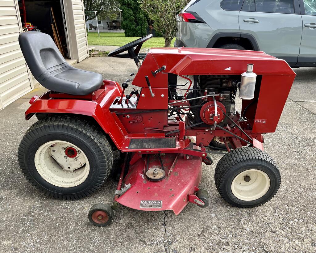

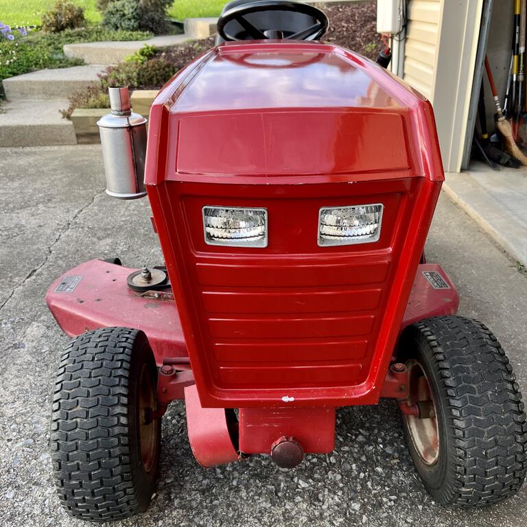

Here’s my grass cutting 1980 C-165. I restored it about 15 years ago. I am waiting for new carbon fiber decals from Redo Your Horse to complete the look.

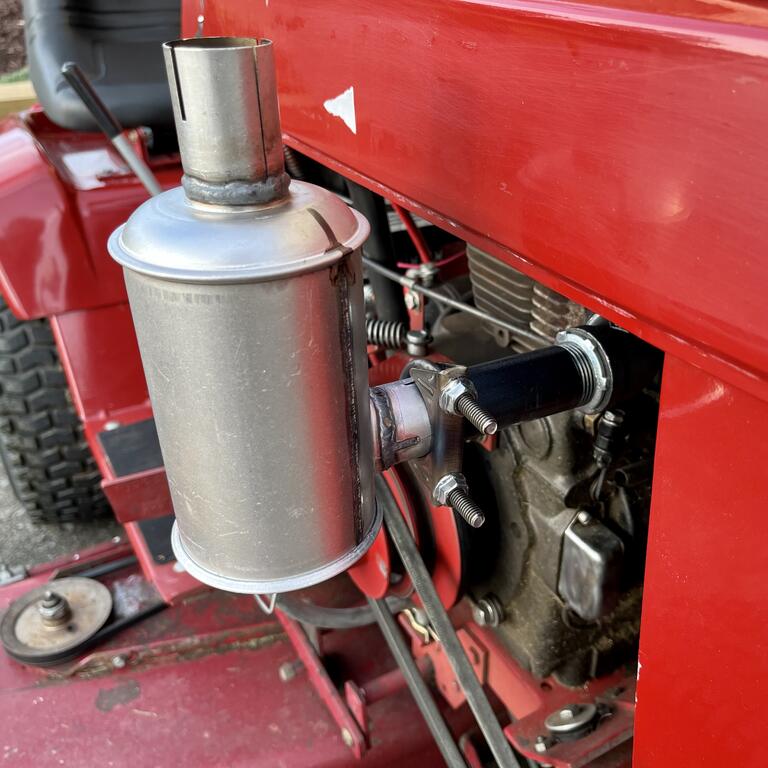

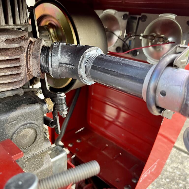

I installed the aftermarket Gravely style muffler as recommended from member Brian Koch. No problems there. I took his recommendation on the NAPA by Prime  Lime muffler for quality. It certainly is and fit perfectly on to the 1” pipe nipple (see pics). It’s a big improvement over the pepper shaker.

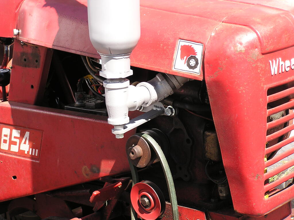

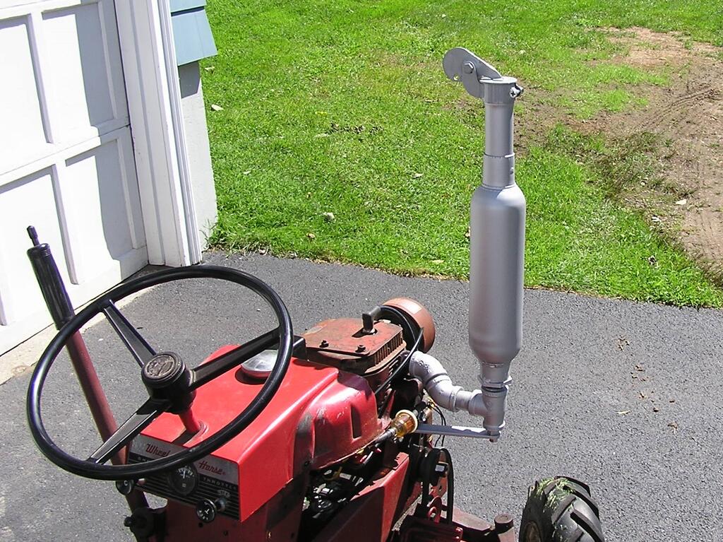

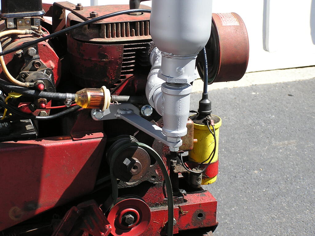

Jeff - looks good so far. Consider adding a lower support bracket attached to the motor. If you accidently hit something and it is unsupported, could have bad results.
Pictures of the one I made up on the 854..... I went with all black iron, as heating galvanized parts throws off a noxous odor....

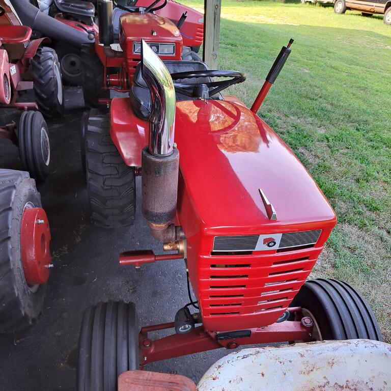

Yep one of Jim K's tips would look good on there. Hopefully he'll chime in ang and get you one.
  • Like 2
Jeff Holobusky
That looks really good. Just enough stack to give the look. Achto send out a request to Jim since I can't message yet. Thanks for the response.

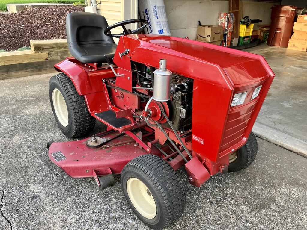

Bought that Gravely style muffler from NAPA just before I got on RS. It’s got a 1-1/4” outlet and the 5/16” inlet fit perfect on the 1” nipple pipe.
I’ll be finishing off with the black carbon fiber  vinyl wrap decals from Redo Your Horse
So how about a short turn out that fits on the 1-1/4” outlet. Depending how the decals look, I may paint muffler semi gloss black or silver to cover the ugly welds. They do bulge out a bit.
I am open for suggestions and ideas. What muffler would you have used? I didn’t want anything to high since I use the machine for cutting grass in a not so open neighborhood.

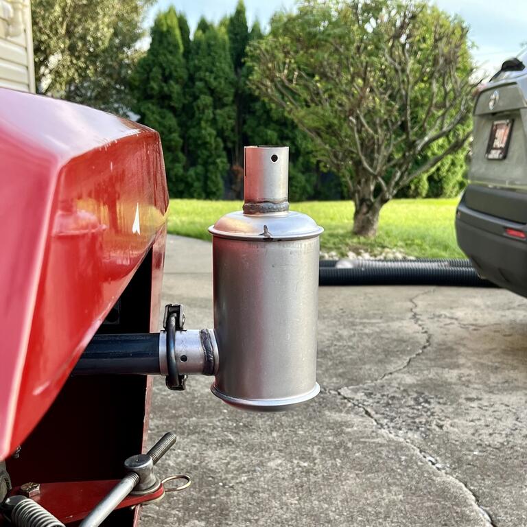

Attaching 2 pics.

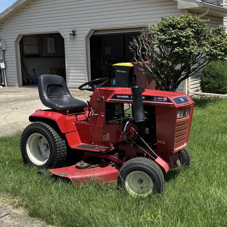

Jim, Here’s decals.
Jeff Holobusky
Update for the Gravely style muffler. The weld broke on the muffler after 2 months of cutting. I replaced with a muffler from Amazon, but it is going to need support. No matter how much I tighten, it still moves. Work in progress.
 Updated my picture with the “Midwest Custom Graphics ” carbon fiber decals.
