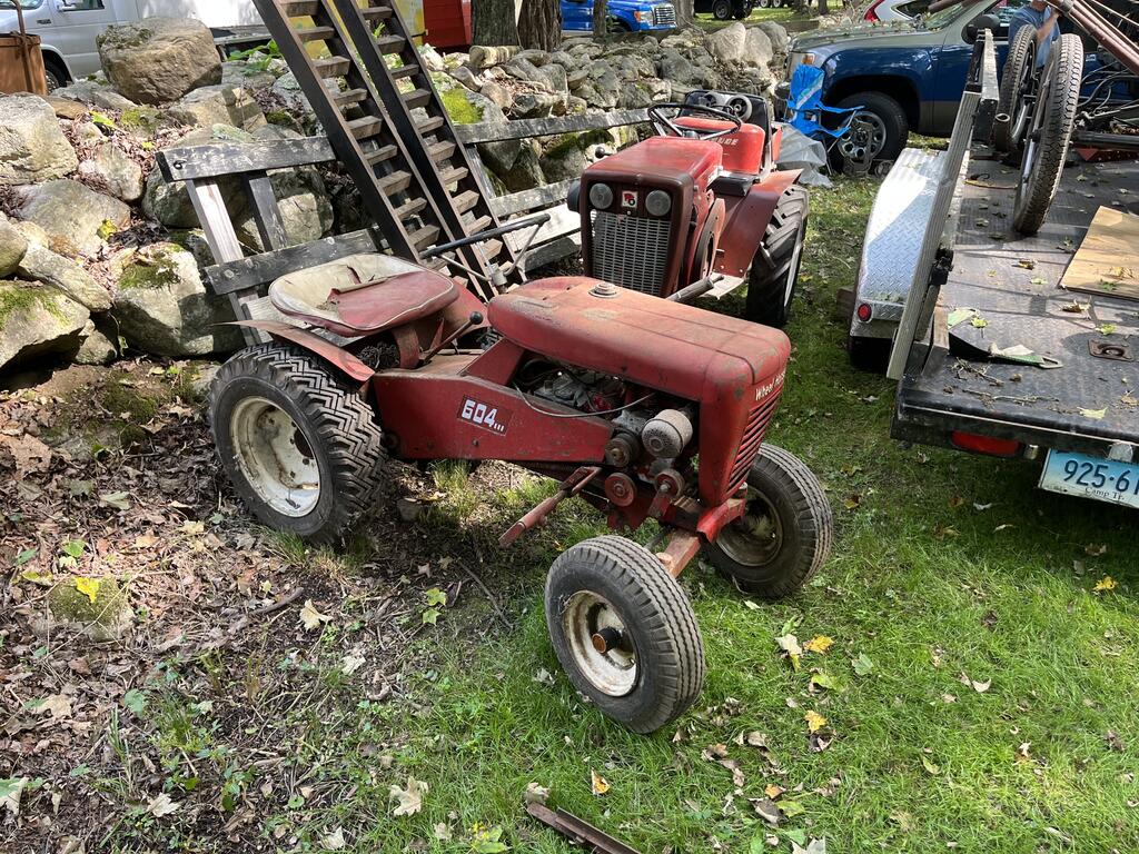

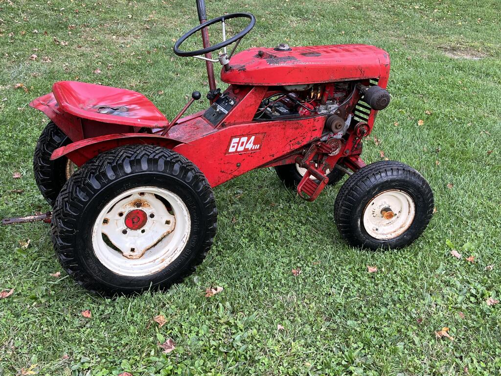

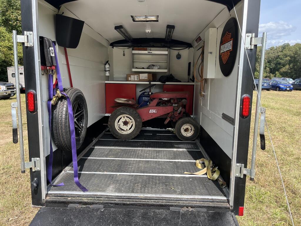

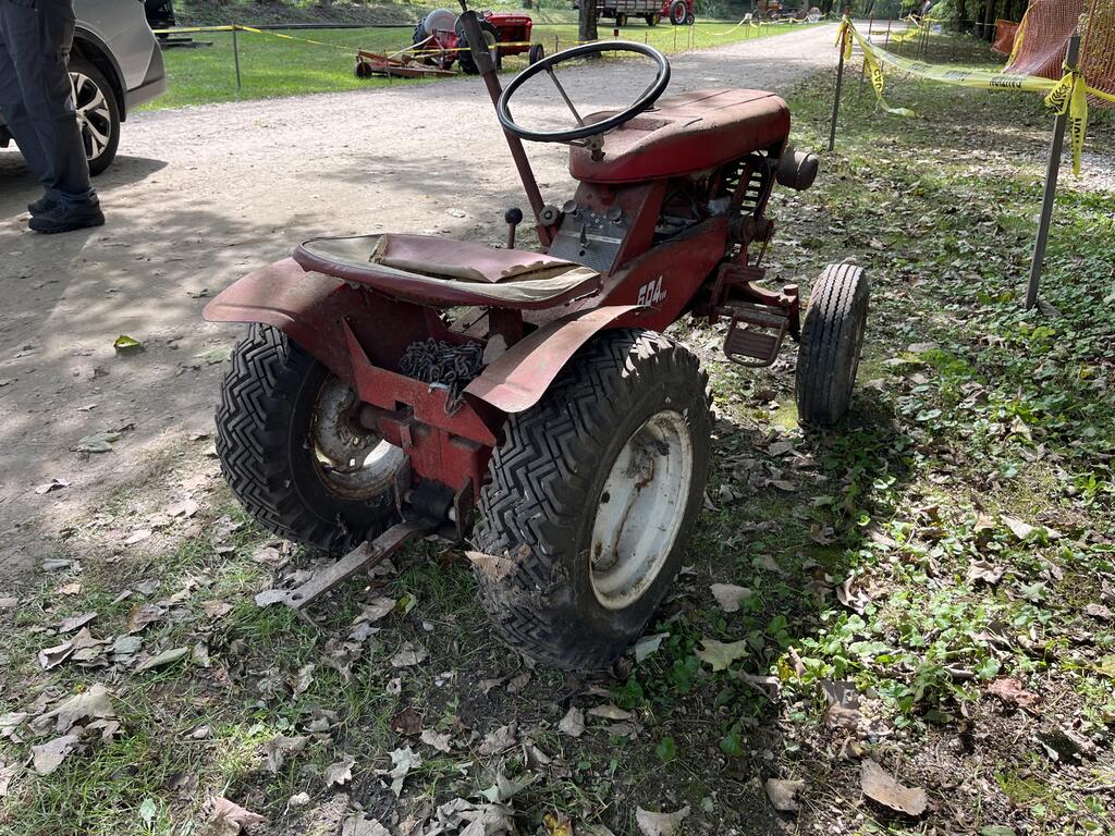

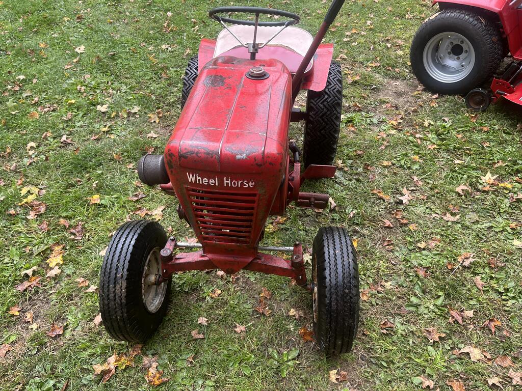

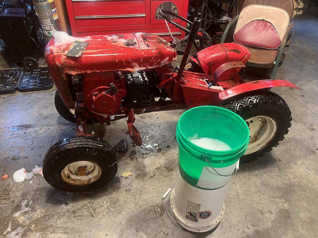

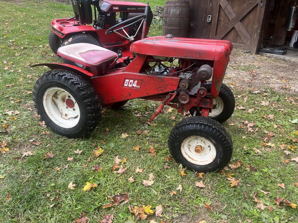

stevebo-(Moderator) 8,742 #1 Posted September 23, 2023 So today I was able to get up to the antique machinery show in Kent, CT. I saw a vendor I knew who had a super original 604. He told me years ago he drove it into his barn and it has been sitting. I assume it was sitting for at least 15 plus years but did not ask. ended up buying it and after messing with cleaning the carb I got it to fire and run very well. I will spend some time making it like I want it. So surprised how well that little tecky runs! IMG_1567.mov 3 13 1 Share this post Link to post Share on other sites

Sparky-(Admin) 26,324 #3 Posted September 23, 2023 Nice Steve! Lawn ranger steering wheel?? 2 Share this post Link to post Share on other sites

stevebo-(Moderator) 8,742 #5 Posted September 23, 2023 3 hours ago, Sparky said: Nice Steve! Lawn ranger steering wheel?? Mike, Not sure about that. The wheel has to come off to fully remove the hood only thing is there is a roll pin in the wheel. I will let others chime in here. I have never owned this model as I usually stay away from tecky motors…🤷 1 Share this post Link to post Share on other sites
ri702bill 12,988 #6 Posted September 23, 2023 Steve - the 603 and 604 models each had a diferent tall steering wheel - there was only a partial hoop on the 603, full circle on the 604. Download the manual. Nice addition - it looks lonely by itself.......... Bill 2 Share this post Link to post Share on other sites

Racinbob 13,135 #9 Posted September 23, 2023 (edited) . Nice looking original. The steering wheel is an easy fix. The 604, 654, 704 and 854 all used the same steering wheel (4983}. It was used many other years and models as well so there's plenty of them out there. Edited September 23, 2023 by Racinbob 2 Share this post Link to post Share on other sites

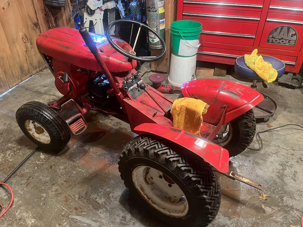

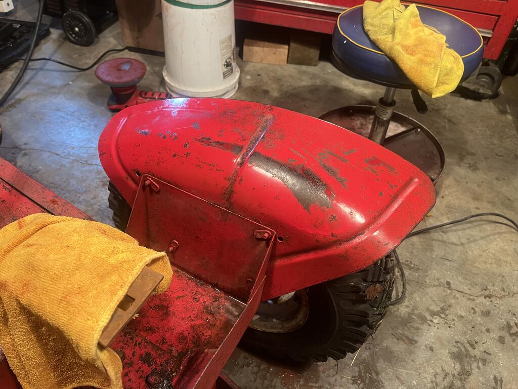

stevebo-(Moderator) 8,742 #17 Posted September 23, 2023 A little wet sand and buffing today 4 5 Share this post Link to post Share on other sites

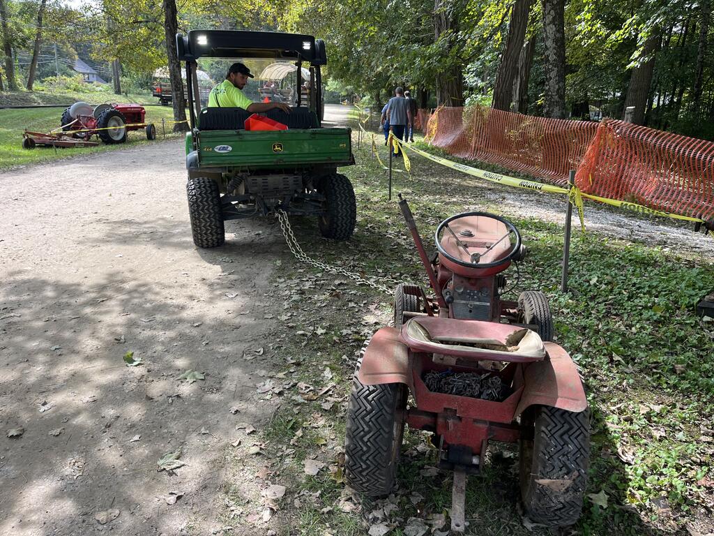

wallfish 20,576 #22 Posted September 24, 2023 Nice Find Steve !!! Just a couple things noticed about original Steering wheel not original as mentioned but certainly not a big deal. Seems like many of those were changed and probably from damage by trying to remove them for the hood removal. It's pretty simple to just lift the hood and twist it over to the side for complete access to everything under it without any need to remove the steering wheel but... That one looks like the shaft was cut to get it off and the raised wheel got the height back plus a little. The one Jim posted has a different one on it too. Engine is not original as a 604 would be a pull start only engine without any provisions for any of the electric start stuff. All the other electric stuff on the tractor would've been added too. Or possibly it's a 654 with the belt guard changed. They were the same exact tractor except for the electric start stuff. Battery tray would've been a little toolbox. Didn't they stop driving tractors there at Kent? Did you still have to push it 1/2 mile to get it back to the truck? That was a cool show but once I heard they stopped allowing driving of tractors it's out of the question. Parking a 1/4 mile away and walking up that hill just to get there and then dragging stuff all the way back doesn't seem like a good time. 3 Share this post Link to post Share on other sites
