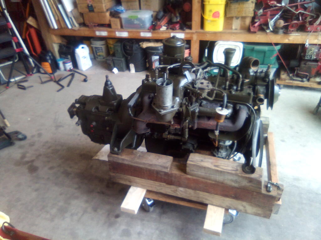

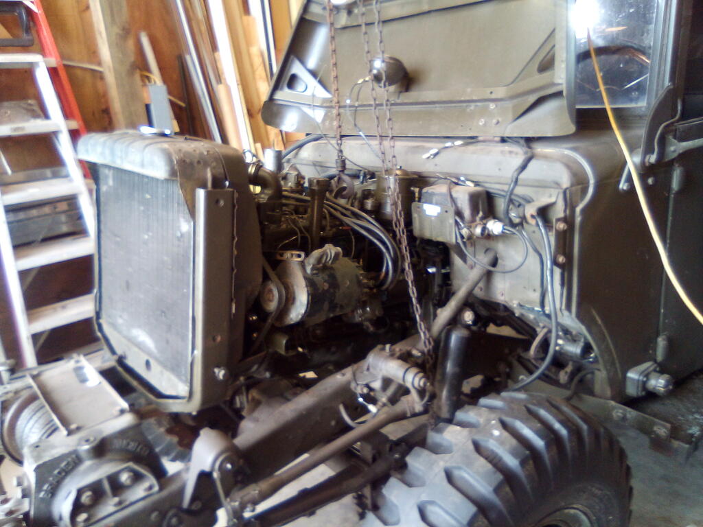

pfrederi 19,559 #1 Posted September 22, 2023 She is only a couple year younger than I... but this is probably the last major project I am going to do. The parts are getting heavier and getting up from under her and contorting in the cab is getting harder. Sticking to WH overhauls in the future... Easier and considerably cheaper. Complete overhaul, took several months at the machine shop but he does great work. Always some interesting classic /collectable cars in there when I visit. Engine has landed but now a lot of hooking stuff up and reconstructing the front clip. All done by myself...tired now today time for cocktails... 5 10 Share this post Link to post Share on other sites

pfrederi 19,559 #5 Posted September 22, 2023 (edited) 1952 M37 with winch 3/4 ton Engine is a Chrysler Dodge DeSoto Plymouth 230 ci Flat head six. ( Most the bolts are marked DDCP) Used in civilian vehicles from late 30s to 1957. (to include the Dodge power Wagons ) I rounded up most the parts. The Piston rings were in original packaging ...1953. Edited September 22, 2023 by pfrederi 17 Share this post Link to post Share on other sites
