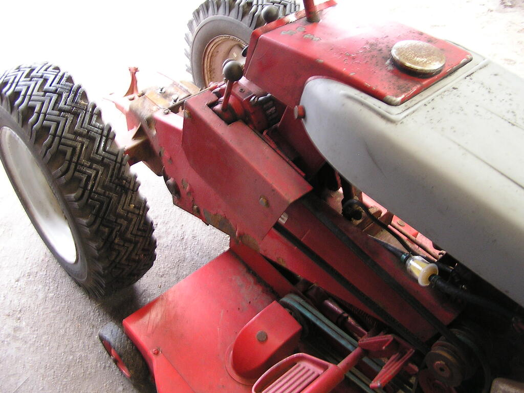

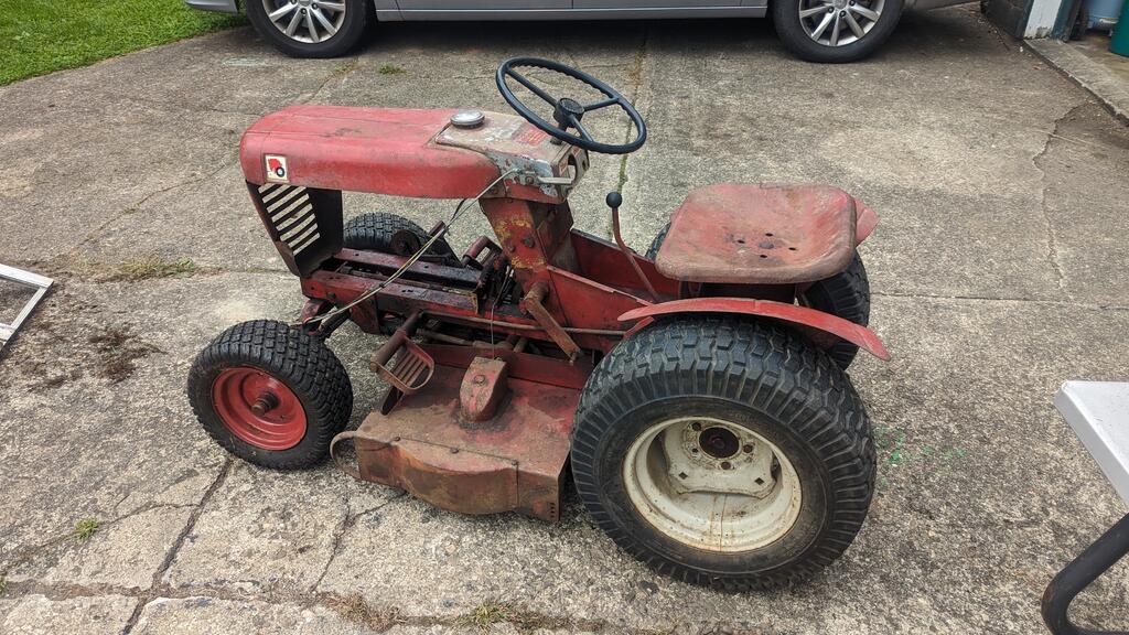

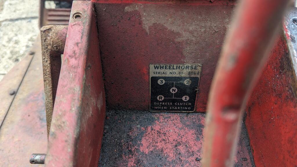

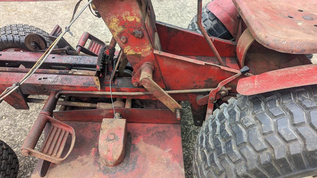

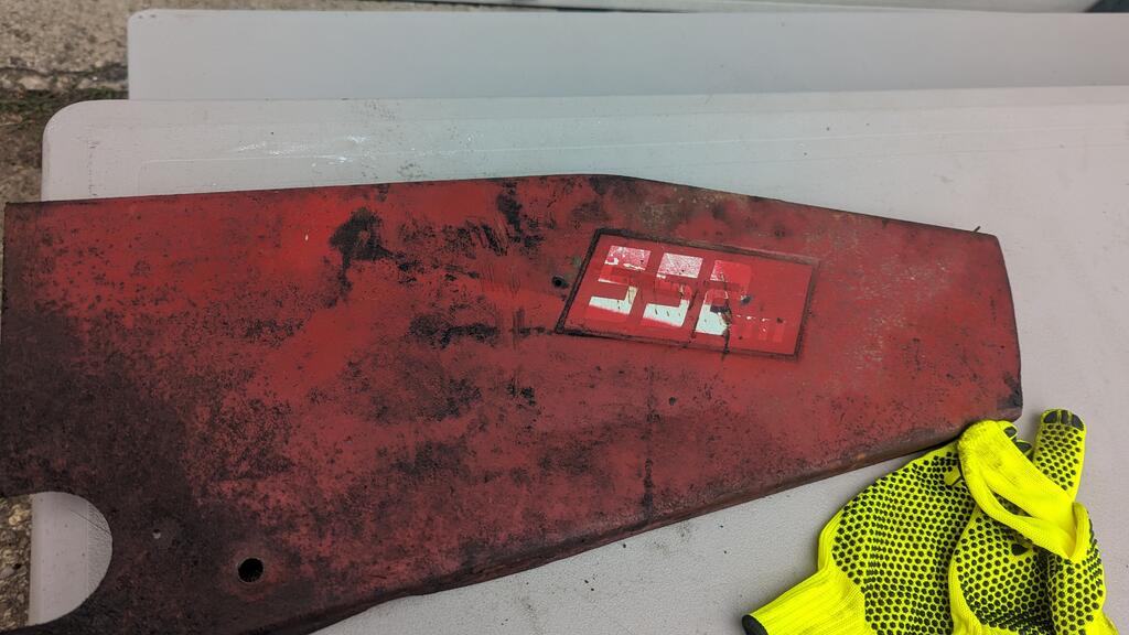

yspecv 11 #1 Posted September 21, 2023 Hello everyone! Been a minute since I've been on here but I need your help. I just picked up this, what I assume, is a '62 552. But what has me second guessing is the lift arm mechanism on the side(second pic). All the early '60s models I see have the lift arm that passes through the bulkhead. I also attached a pic of the serial number if that helps. I tried searching around Google images and couldn't find anything similar. Thanks! Share this post Link to post Share on other sites

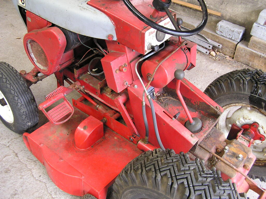

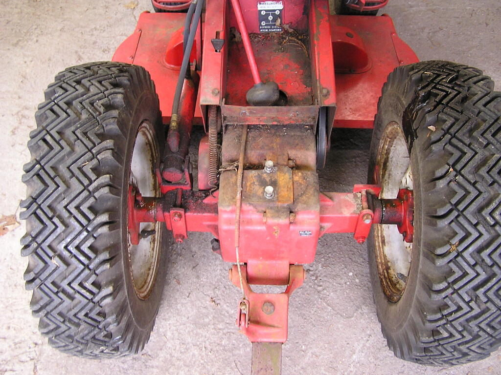

ri702bill 12,472 #2 Posted September 21, 2023 Welcome!! That is a 1962 WH alright - maybe started life as a 552.... The short arm is part of the optional HY-2 hydraulic lift setup. Looks like the pump, cylinder and brackets are long gone. Too bad A regular manual lift can be installed. Does it still have the Unidrive cylinder mount?? Here are pictures of a HY-2 kit I have, still shown on the donor tractor. Bill 2 1 Share this post Link to post Share on other sites
gwest_ca-(File Mod) 12,343 #3 Posted September 21, 2023 1 1 Share this post Link to post Share on other sites
yspecv 11 #4 Posted September 21, 2023 That makes more sense. It has a sticker on top in front of the steering wheel that says something about hydraulic fluid. Had me scratching my head. It also has another bracket on the right side(from the seat). Must be where the pump was mounted. And no, the whole cylinder and everything is gone. Well, I guess I'll have to fabric something for the deck. I'm assuming you can't install a manual lift with out a different bulk head. 1 Share this post Link to post Share on other sites
Pullstart 70,656 #5 Posted September 21, 2023 (edited) The dash stand stays put, the lift arm is replaceable. There is a large clip inside, holding things together. Edited September 21, 2023 by Pullstart 1 1 Share this post Link to post Share on other sites
yspecv 11 #6 Posted September 21, 2023 Interesting. I have a few lift arms and brackets from other models. I'm sure I can fab up something to work. Share this post Link to post Share on other sites
ri702bill 12,472 #7 Posted September 21, 2023 Maybe not if you keep that hood stand - 61 and 62 only. Switch to a 63 - 64 style - much simplier and friendly mounting..... bolts right in. Bill 1 Share this post Link to post Share on other sites
ri702bill 12,472 #8 Posted September 21, 2023 And - the 63 and later have the adjustable height stop - a HUGE benefit to skim a plow in the snow over the grass......... over the 61-62 2 position quardrant. 1 Share this post Link to post Share on other sites

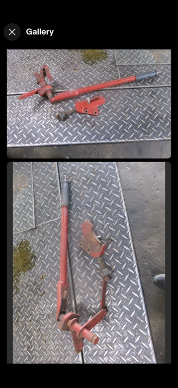

yspecv 11 #11 Posted September 22, 2023 So will any older style lift handle work? I found this one, and ones similar, for a decent price, but it's for a 854. Share this post Link to post Share on other sites
Pullstart 70,656 #12 Posted September 22, 2023 Same dash tower, and a bonus you’ll get an adjustable stop! 1 Share this post Link to post Share on other sites
yspecv 11 #13 Posted September 22, 2023 Thanks! I was digging through some parts I got from a buddy and found a quadrant and lift stop, but not the handle and rod. I'm hoping he has the rest of what I need. If not, looks like I'll be ordering one. 2 Share this post Link to post Share on other sites
