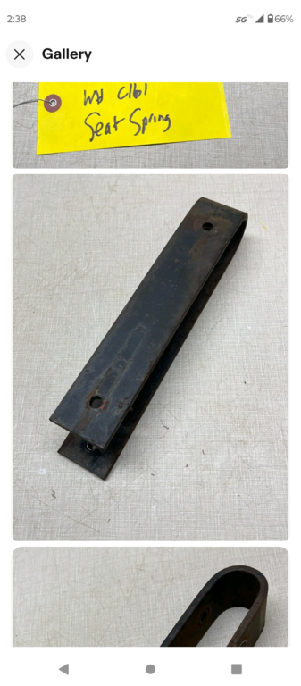

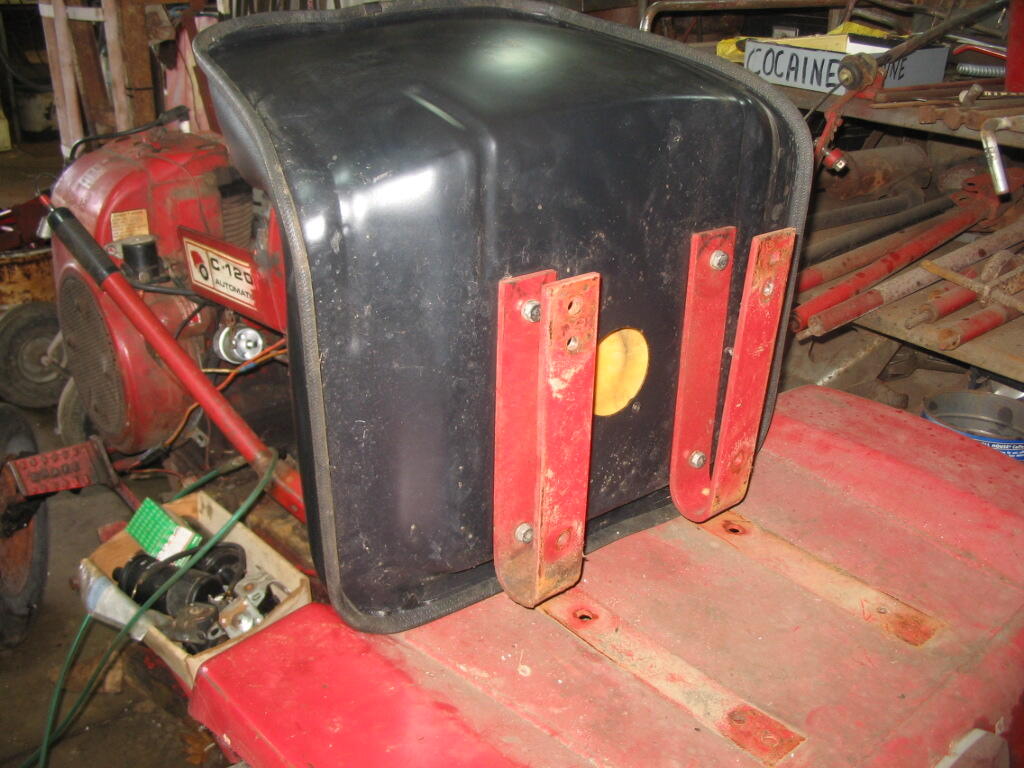

steelworker2004 1 #1 Posted September 21, 2023 I'm putting original type seat springs back on my wheel horse (missing when I bought it). Was wondering if the short end of the spring bolts to the seat or vice versa. Thanks 1 Share this post Link to post Share on other sites
daveoman1966 3,885 #2 Posted September 21, 2023 This should ans your Q.. 2 2 Share this post Link to post Share on other sites

steelworker2004 1 #6 Posted September 21, 2023 Thanks, I never would have thought they might be the wrong dimensions from the factory! Share this post Link to post Share on other sites

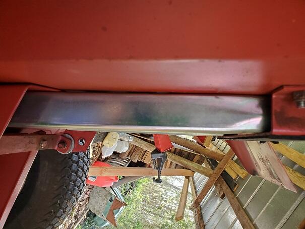

GAJoe 852 #8 Posted September 23, 2023 (edited) Those seat springs have a bad design that loads most of the weight to one area of the seat pan. The seat pan wasn't designed with enough strength and the load causes stress cracks. I got the cracks welded up then added super-strut to keep that seat pan from being flexed in the future. Edited September 23, 2023 by GAJoe 4 Share this post Link to post Share on other sites
