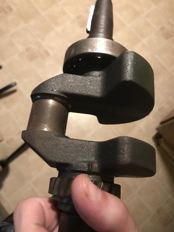

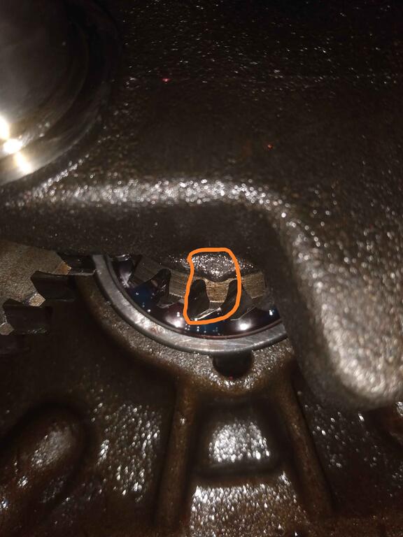

scotty 252 #6 Posted September 19, 2023 Hi i took my engine apart just want to check again is this bump on the crankshaft the timing mark on the k181? 1 Share this post Link to post Share on other sites
rmaynard 17,659 #7 Posted September 19, 2023 The mark should be a little more distinct than that. I have a K181 crank out in the shop, but I can't get to it until tomorrow. I will take a picture. 1 Share this post Link to post Share on other sites
horseman with no horse 72 #8 Posted September 23, 2023 I know there is two marks on the FLYWHEEL for timing, and you can use those to set the points gap/timing. There should be a timing mark on the crank right where the tip of my thumb sits. 1 Share this post Link to post Share on other sites
rmaynard 17,659 #9 Posted September 23, 2023 Short of me pulling down the bin of K181 parts, the crank above is identical to mine, thus the mark is the same. 1 Share this post Link to post Share on other sites
horseman with no horse 72 #10 Posted September 24, 2023 On 9/19/2023 at 6:24 PM, scotty said: Hi i took my engine apart just want to check again is this bump on the crankshaft the timing mark on the k181? That mark looks correct rotate the crank until the mark is directly in line with the cam. Look at the cam timing mark and make sure they line up to the exact TOOTH on both the crank and cam. If they are perfectly lined up the mechanical aspect of the engine is in time. Check your valve clearance and make sure you got good spark with the points set correctly. 1 Share this post Link to post Share on other sites
scotty 252 #11 Posted September 24, 2023 Just an update that is the timing mark. I must have missed it by a tooth. Running great! 1 1 Share this post Link to post Share on other sites
