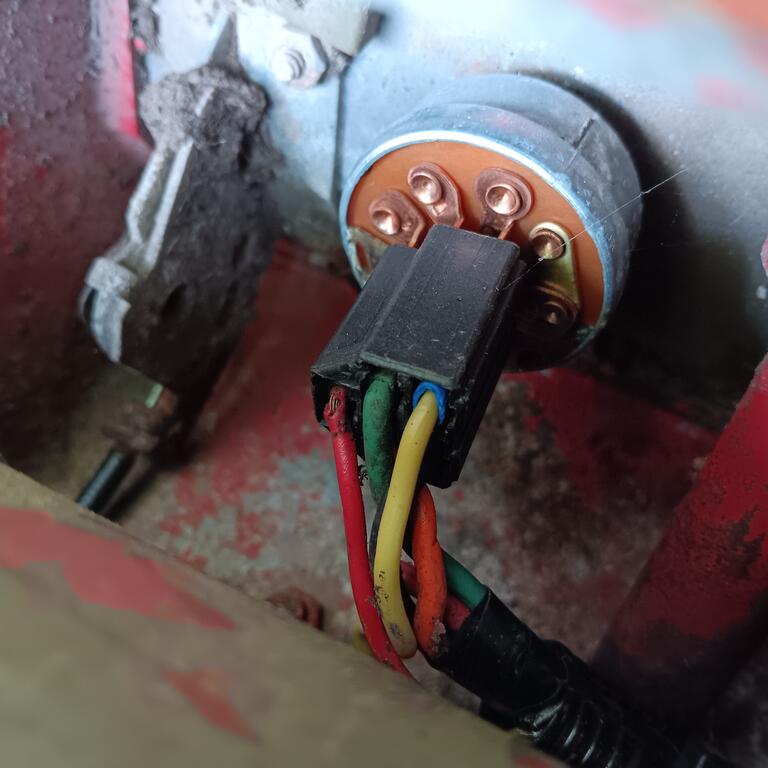

Jason X 20 #1 Posted September 18, 2023 My "72 raider 10 has no spark. New plug. Checked coil. No ohms. Replaced. Ohms good. New condenser. Still no spark.Waiting for new points delivery. If it's not the points I figure it's the kill switch. Ignition switch is new too. "M" lead on Ignition switch is the kill switch best I can figure. Where does the kill wire go from the Ignition switch in case it's not the points? Has Kohler K series 10. 1 Share this post Link to post Share on other sites

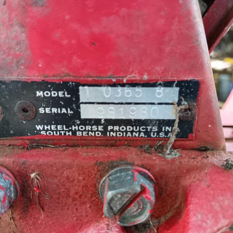

gwest_ca-(File Mod) 12,369 #2 Posted September 18, 2023 Your model number indicates the tractor is a 1973 10hp 8-speed. If you have an "M" terminal the switch is for magneto ignition. You need a switch for battery ignition if you have the external can coil. 19 items on the 1-0365 model. https://www.wheelhorseforum.com/search/?q=1-0365&quick=1&type=downloads_file 1 Share this post Link to post Share on other sites

pfrederi 20,877 #6 Posted September 18, 2023 Misread Spec # I think it is 46636d (Shows as WH) had a battery coil points ignition (I thought it was 46656d which is not a valid spec#) Share this post Link to post Share on other sites
953 nut 67,469 #7 Posted September 18, 2023 As Garry said I think you have the wrong ignition switch. Read this post. Share this post Link to post Share on other sites

Jason X 20 #9 Posted September 19, 2023 Yes, it was a pic forthe engine model# Share this post Link to post Share on other sites
Jason X 20 #10 Posted September 19, 2023 Thanks,all. Spot on about the ignition. Sparked right up. Share this post Link to post Share on other sites
