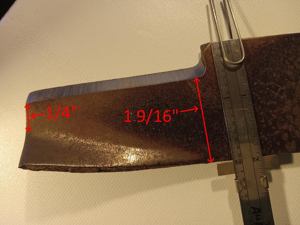

the jeep driver 29 #1 Posted September 17, 2023 How much metal can I take off of these blades before they are no longer serviceable? They are about two inches wide, and have about 1/4" before I would get into the curve of the mulching blade. I have a deck with three 106108B stamped blades. If I do need to replace them soon, what do you recommend? Not many options come up in an internet search. I see this; "Toro Replacement Blade - 14 1/2" x 2" - Replaces 106108," but my 106108B blades are only 14 1/8" long... ? Share this post Link to post Share on other sites
lynnmor 8,898 #2 Posted September 17, 2023 You measure mower blades at an angle from cutting tip to cutting tip. You should be able to find what you need at farm supply stores. You can get some more use out of the one shown so long as it still has little thinning and you don’t get uncut grass between the blades. 1 Share this post Link to post Share on other sites
Ed Kennell 46,572 #3 Posted September 17, 2023 22 minutes ago, lynnmor said: You measure mower blades at an angle from cutting tip to cutting tip. You should be able to find what you need at farm supply stores. You can get some more use out of the one shown so long as it still has little thinning and you don’t get uncut grass between the blades. The effective tip to tip length becomes shorter and decreases the overlap as the blades are ground back. The shorter blades may start to leave an uncut strip first noticeable when turning. 1 1 Share this post Link to post Share on other sites
