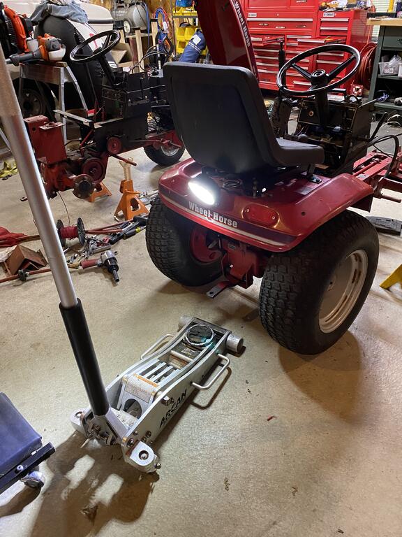

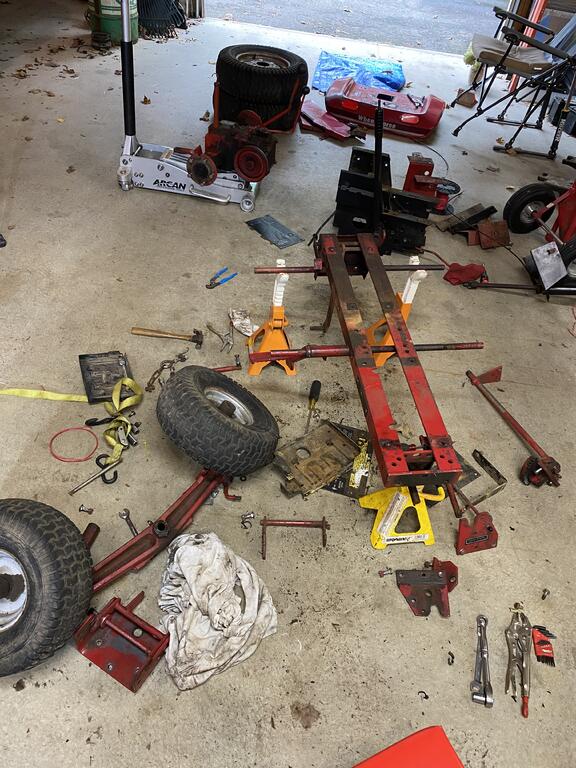

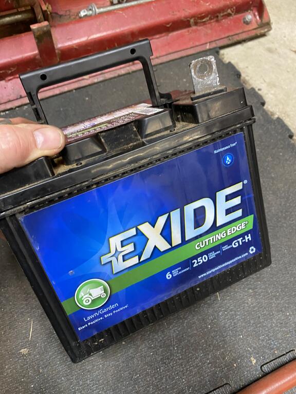

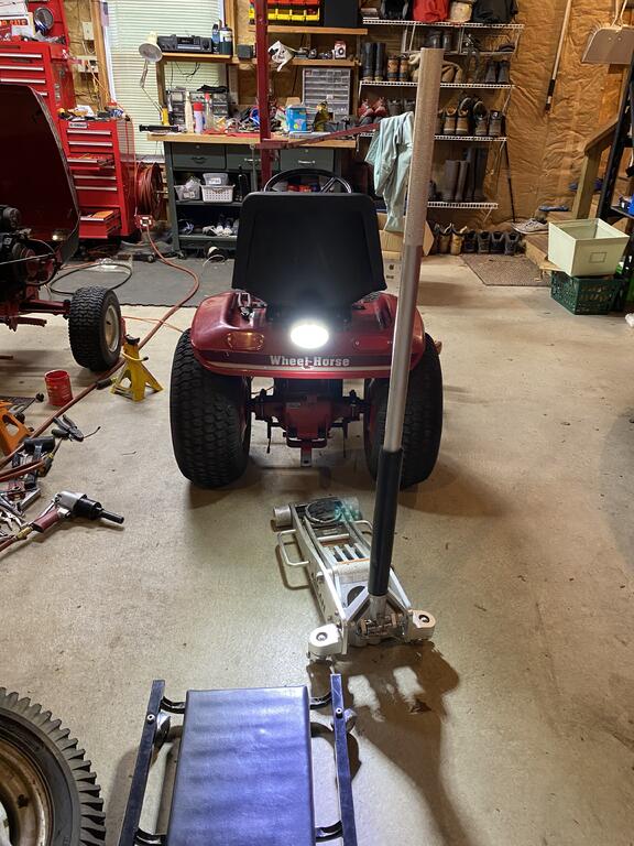

Sparky-(Admin) 26,898 #27 Posted September 18, 2023 Small update: new trans fluid, lubed and greased every single moving part pertaining to the clutch, brakes and lift mechanism, installed the rear fender pan, seat, rear axle bracket and rear tires with inside weights. Did a temp hookup of the rear light, really liking that! Check out the battery, that handle is so nice to use (a “go-handle” for anyone that watches Vice Grip Garage on You-Tube ) 4 2 Share this post Link to post Share on other sites
ebinmaine 81,288 #28 Posted September 18, 2023 2 hours ago, Sparky said: Did a temp hookup of the rear light, really liking that! Great for night plowing mowing trail riding etc. I have a 6 LED light set on the back of the Automatic. Share this post Link to post Share on other sites

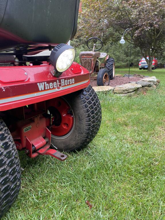

Sparky-(Admin) 26,898 #29 Posted September 18, 2023 12 minutes ago, ebinmaine said: Great for night plowing mowing trail riding etc. I have a 6 LED light set on the back of the Automatic. The Mag 8 has the wimpy charging system with a separate ac output for the headlights. The more RPM’s the brighter they are. Not sure how the LED’s are going to operate with the fluctuating voltage. Might just wire them right off the battery with an in-line fuse so that they see 12v all the time regardless of engine RPM’s. Has anyone else been down this road? Might be a good question for the electrical section 3 Share this post Link to post Share on other sites
Racinbob 13,290 #30 Posted September 18, 2023 Never thought about that with leds. Please post what happens. If you do wire direct to the battery you might want to consider switching a relay so it will kill the lights if the engine is shut off. 2 Share this post Link to post Share on other sites
oliver2-44 11,850 #31 Posted September 18, 2023 46 minutes ago, Sparky said: The Mag 8 has the wimpy charging system with a separate ac output for the headlights. The more RPM’s the brighter they are. Not sure how the LED’s are going to operate with the fluctuating voltage. Might just wire them right off the battery with an in-line fuse so that they see 12v all the time regardless of engine RPM’s. Has anyone else been down this road? Might be a good question for the electrical section I asked my son that works in the commercial light and sound business. He said fluctuating voltage is typically not good for LEDs. Wiring directly to the battery would be better for them. 1 1 Share this post Link to post Share on other sites
ebinmaine 81,288 #32 Posted September 18, 2023 48 minutes ago, Sparky said: Might just wire them right off the battery with an in-line fuse so that they see 12v all the time regardless of engine RPM’s. Has anyone else been down this road? This is the way. Mine are wired so they go through the key switch but see direct battery voltage. 1 Share this post Link to post Share on other sites
wallfish 20,744 #33 Posted September 18, 2023 The A terminal on the key switch will provide 12v from the battery and also turn off power to the switch when the engine is turned off. Or don't use a switch for "day time running lights) that would be on all the time the tractor is running. 2 Share this post Link to post Share on other sites
Sparky-(Admin) 26,898 #34 Posted September 18, 2023 37 minutes ago, oliver2-44 said: I asked my son that works in the commercial light and sound business. He said fluctuating voltage is typically not good for LEDs. Wiring directly to the battery would be better for them. THANKS! Appreciate you reaching out to an expert. Fed off the battery it is. 2 Share this post Link to post Share on other sites

kpinnc 19,107 #40 Posted September 19, 2023 (edited) 6 hours ago, Sparky said: Not sure how the LED’s are going to operate with the fluctuating voltage. I can't offer specific current numbers, but a bank of LEDs pull less current than two factory incandescents. My repowered 310-8 has PAR-36 LEDs up front as well as LED tail lights. Per my digital voltmeter, the voltage drop when they are on is between 0.1 and 0.2vdc. Two factory headlights is more than half a volt drop. If the Mag 8 has at least a 3 amp regulator, I would think you'll be fine with full LEDs. You should even have some extra for charging. You could also wire a seperate "momentary" switch for that big tail lamp if it puts you over budget. Just make sure you place a ground strap between the hood and frame. LEDs tolerate a little voltage fluctuation far better than a flaky ground. Edited September 19, 2023 by kpinnc 1 Share this post Link to post Share on other sites
ebinmaine 81,288 #41 Posted September 19, 2023 3 hours ago, kpinnc said: make sure you place a ground strap I'll second that. You know how I like multiple grounds on my tractors. Battery to engine. Engine to frame. Every circuit has its own. When it starts to look like black spaghetti you're there. 1 Share this post Link to post Share on other sites

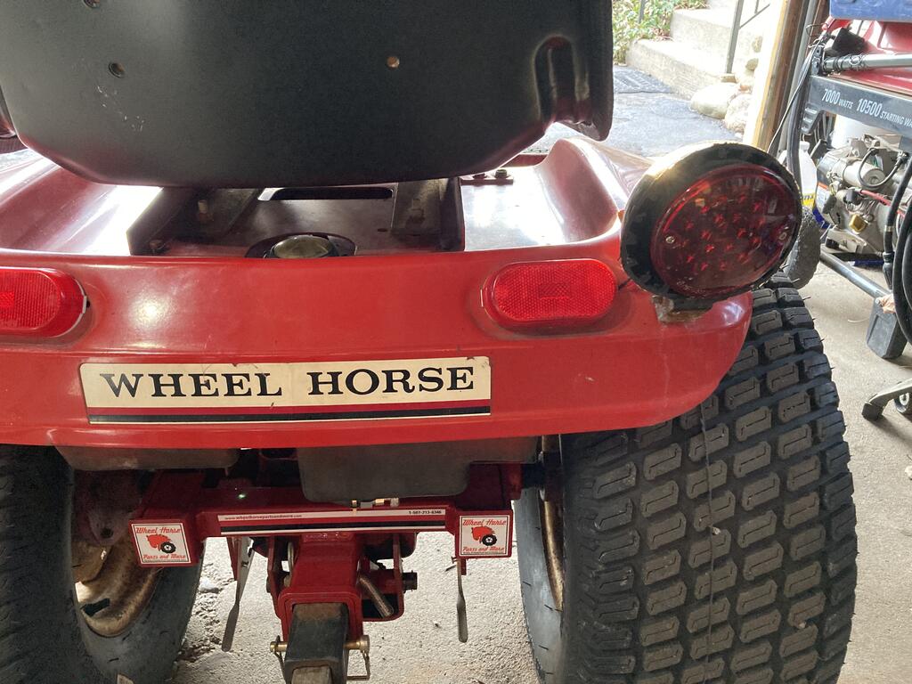

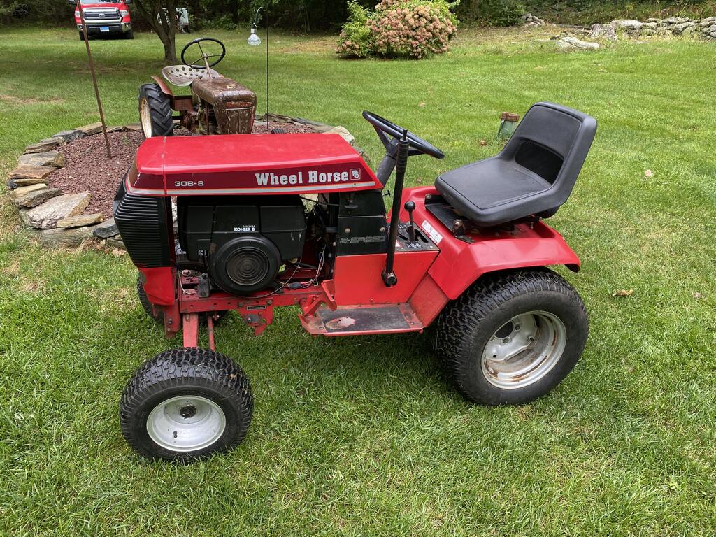

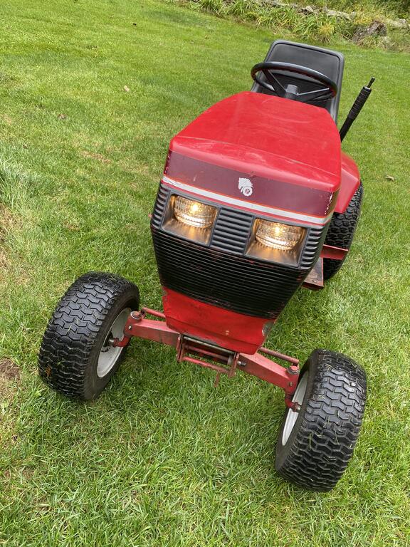

Sparky-(Admin) 26,898 #42 Posted September 23, 2023 Wrapped this one up today. My original plan was to have all three lights fed right off the battery and not use the fluctuating AC 12v circuit. But the charging system is only a 1.25a system (not impressive), running two LED headlights at 9 watts apiece is already drawing more than the unit charges PLUS I have the rear LED light. Wired the two original incandescent headlights into the AC lighting circuit instead and the rear LED light directly off the battery. Separate switches obviously. Swapped the tighter/less sloppy tie rods from the original 308 onto the 312 frame. I suspect the smaller/lighter Mag 8 puts less strain and wear on the front end parts. Choke, throttle, grounds, PTO etc were pretty straightforward. Used the 308 hood since it’s still an 8HP machine. Fired up, runs great, steers nice, all lights work etc! Very happy with how this one turned out and really enjoyed the garage time . 4 Share this post Link to post Share on other sites
Sparky-(Admin) 26,898 #43 Posted September 23, 2023 The original 308? Well it has given its life so that others may live . I’ll be stockpiling parts in boxes and bins for future tractor repairs. 1 1 Share this post Link to post Share on other sites
