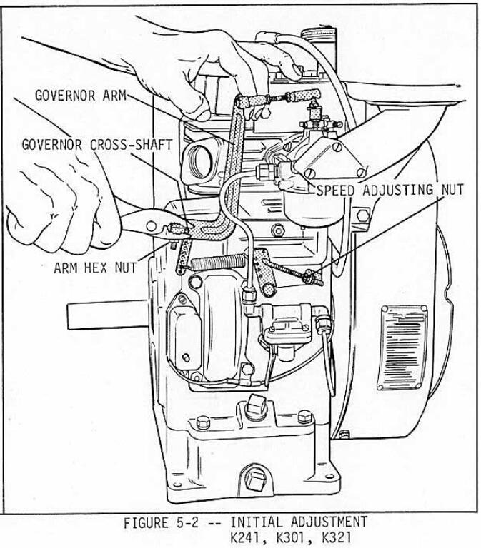

gwest_ca-(File Mod) 12,511 #2 Posted September 15, 2023 In the old up to 1972 service manual 2 1 Share this post Link to post Share on other sites
"Manic-Mechanic" 1,486 #3 Posted September 15, 2023 Yes, I seen this manual, it's not the same linkage. I will delve further into it trial and error this morning. Although it is very similar, thanks Share this post Link to post Share on other sites

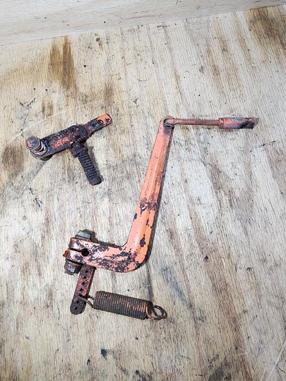

"Manic-Mechanic" 1,486 #8 Posted September 15, 2023 (edited) Here is the assembly. That is the throttle stop adjustment I will get a closer look at. I couldn't find a manual so figured another member would be familiar. Edited September 15, 2023 by "Manic-Mechanic" Share this post Link to post Share on other sites

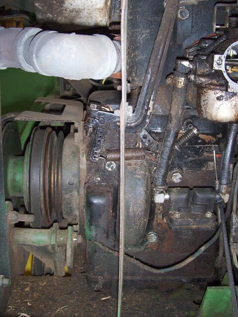

peter lena 10,091 #9 Posted September 15, 2023 @Manicmacanic it was the REPITITION OF THE ISSUE , kept on doing the same thing with out a change . once I freed up every related linkage point . started thinking about a spring pull to pull it back to close / stop . used the holes on the linkage as a go to point , added perforated stainless for a go to spring pull area , also added a battery cable ground bolt point to the , electrical rectifier , insuring electrical charging , those engine tins , are often rotted / rusty , making for erratic electrical charging , not any more. also note the EVIL ENERGY fuel check valve holding fuel just under carb? 4 photo down. held fuel makes for instant starts . regularly experiment / test a fix , have this same thing on my 3 horses , in a number of areas , chronic / repetitive problems are what you want , for a track down and eliminate same , Pete 1 Share this post Link to post Share on other sites

"Manic-Mechanic" 1,486 #14 Posted September 15, 2023 (edited) After getting behind the fuel pump clearly shows some changes were made at some point. Hard to find the Factory settings without an exact manual but it appears the spring may need to be lowered on the governor arm for higher rpm's as the stop adjustment isn't the way to do it? Edited September 15, 2023 by "Manic-Mechanic" Share this post Link to post Share on other sites
